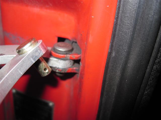

A real common 914 problem: The tabs mounted on the door post have worn and allow the new check strap to click as it reaches the next detent. A larger pin would eliminate the problem but enlarging the holes on the tabs is a problem with clearance issues. Any bright ideas? Thanks, Brad

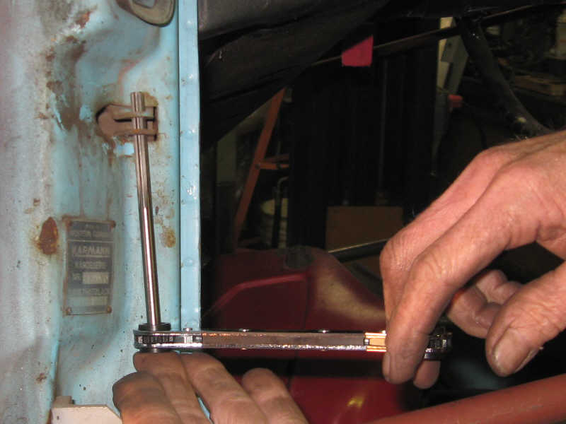

I had the same problem with my green car. It wasn't too bad opening the hole to .250" and I used a 1/4" pin. I think I reamed it using a reamer and pliers. No room for a proper holder. 6mm =.236 vs .250 this is .007 per side. Considering it already oversize, even less.

I used a short bolt with a nylon nut in place of the pin. The bolt was large enough diameter to fill the hole in the stay (1/4"?) and just long enough to secure a nylon nut underneath the tabs. Easy to install and tighten. I tightened the nut just enough to stop the stay from moving and clicking. Not stock, but works great and is reversible.

I just used a chucking reamer I had in my shop. There really isn't a lot of room to work. I did this a long time age (The car is now scrapped). I think I used either pliers or vice grips to turn it a little at a time. The hole is already oversize so you are not talking off a lot of material. The reamer can then do the lower hole first reaming in the up direction then push through to do the top hole. I think that is how I did it. This way both are the same diameter and in line with each other. 5 to 10 min max to do it

Like this:
I ground a square on the end of a shortened .250" reamer to fit into the 3/16" square ratchet. Worked perfectly.
We tried several 1/4" clevis pins from McMaster. The best fitting ones were bare steel unfortunately.
A good choice for diy is a 1/4" bolt with long straight shank cut to length and drilled for a cotter pin.

The ratchet is a bit improvement. I think I just used an open end wrench
