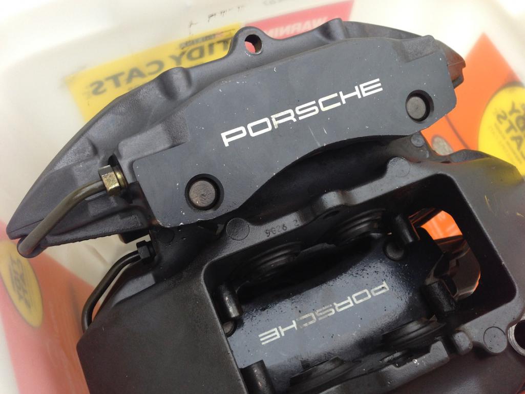

CptTripps Brakes arrived!
...and they're wrong. ... Aug 30 2013, 06:49 AM

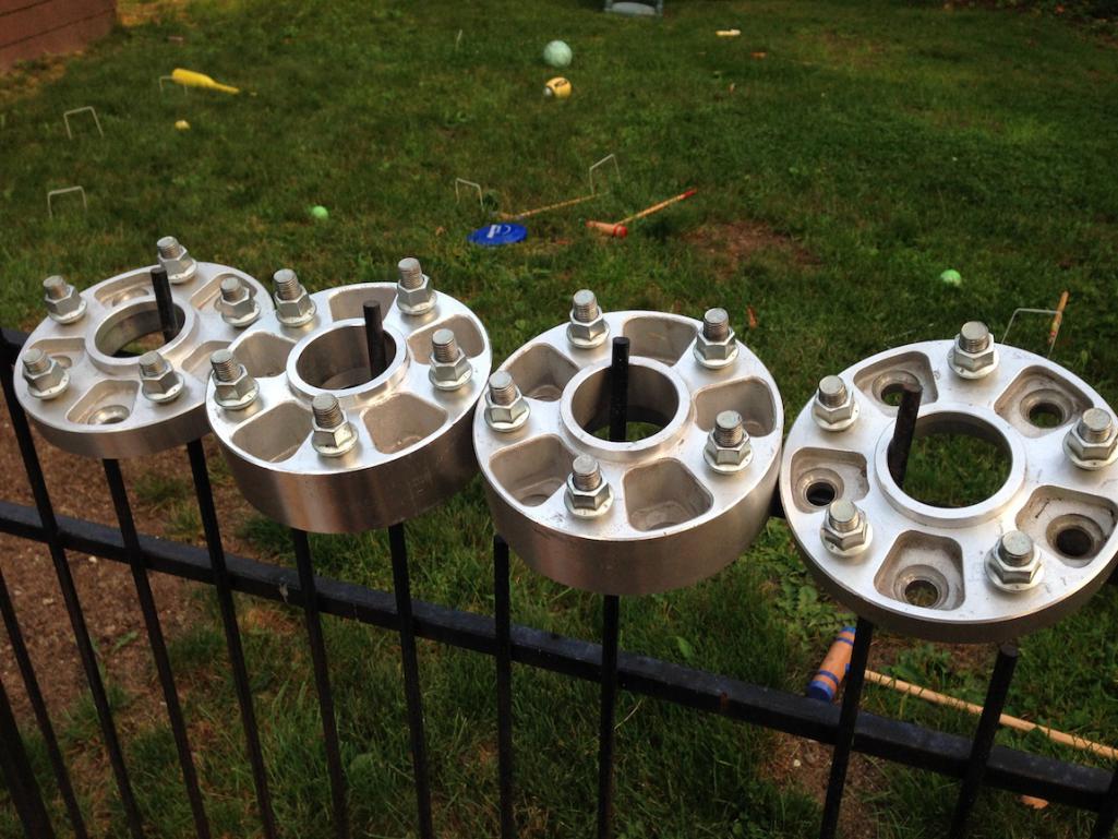

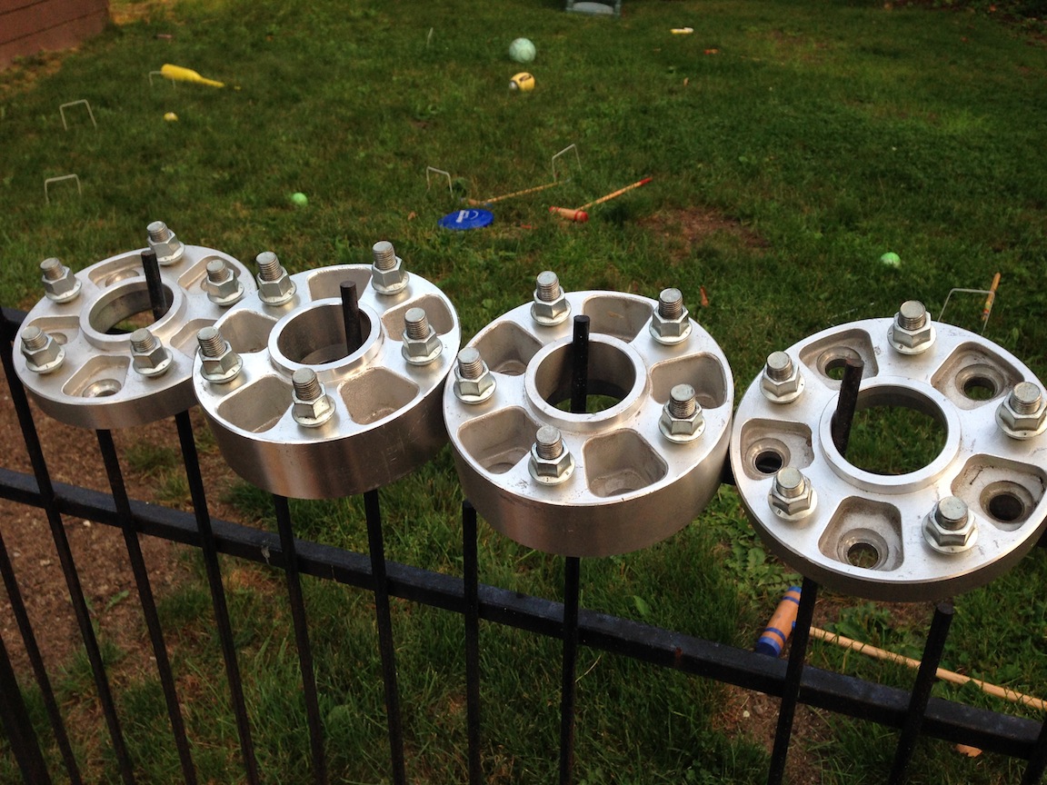

CptTripps Parts fairy showed up today...with a great deliver... Aug 31 2013, 12:44 PM

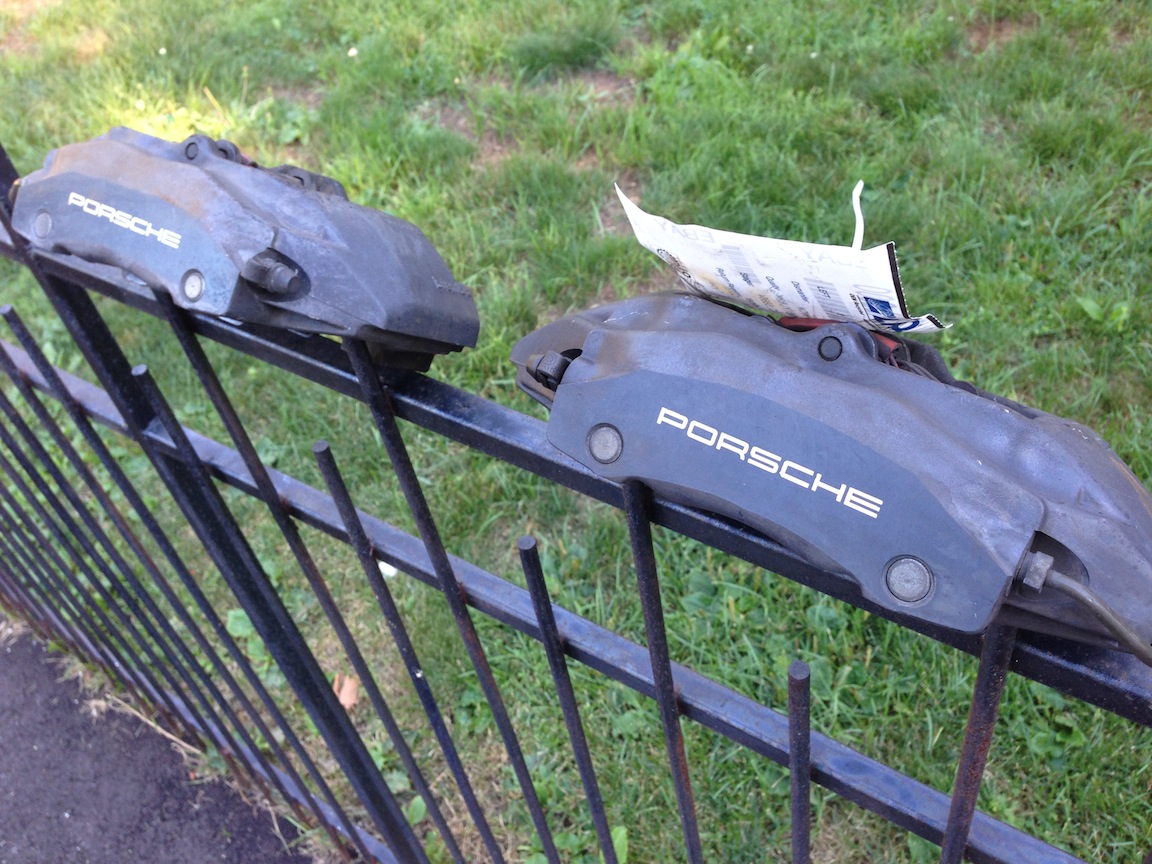

CptTripps Got the RIGHT calipers in today. They're quite... Sep 5 2013, 06:57 AM

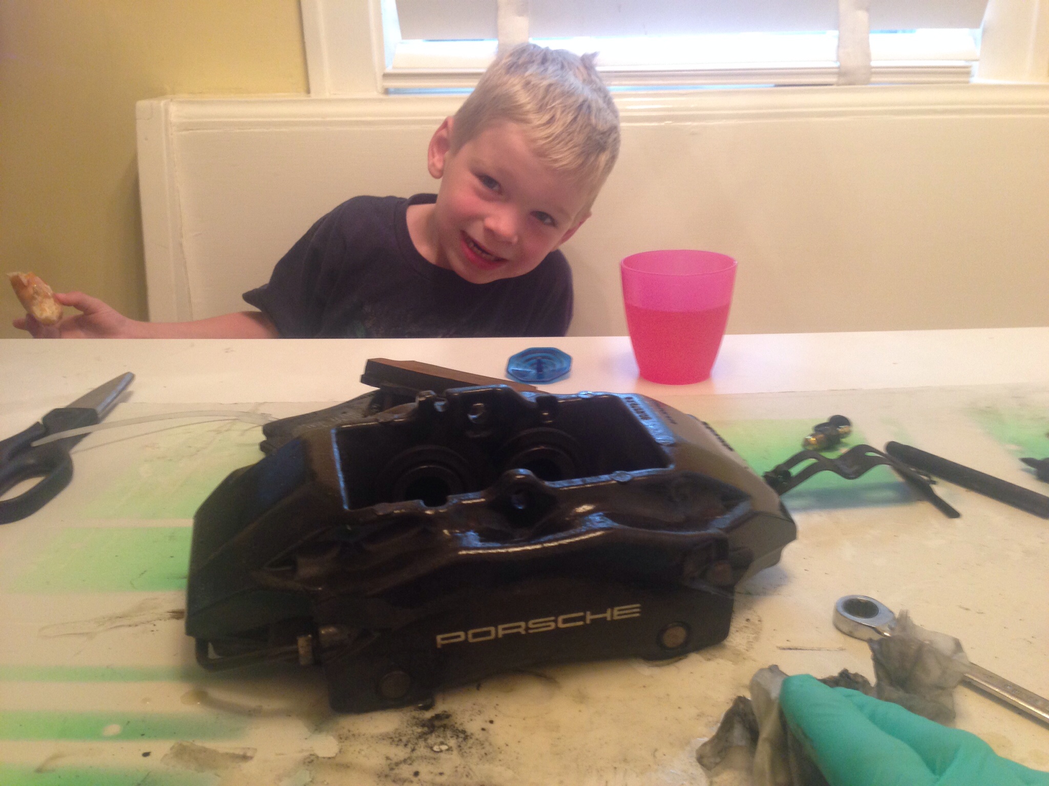

CptTripps I spent the morning with my son Oliver, cleaning t... Sep 8 2013, 07:39 AM

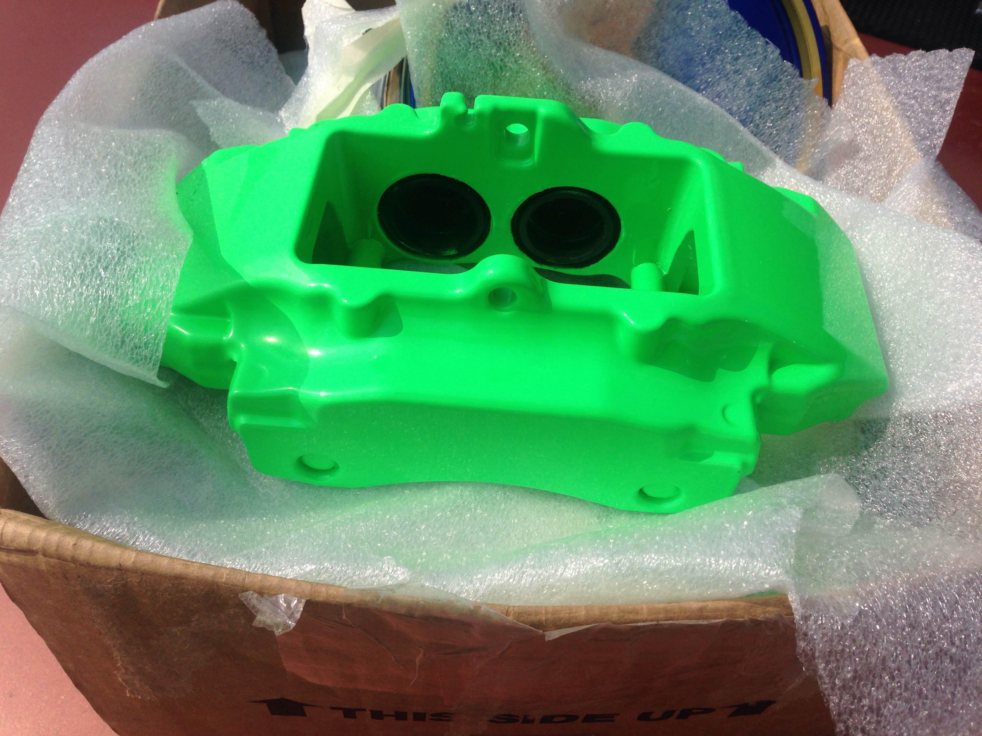

CptTripps Dropped the Calipers off today for Power-Coat. The... Sep 9 2013, 06:22 PM

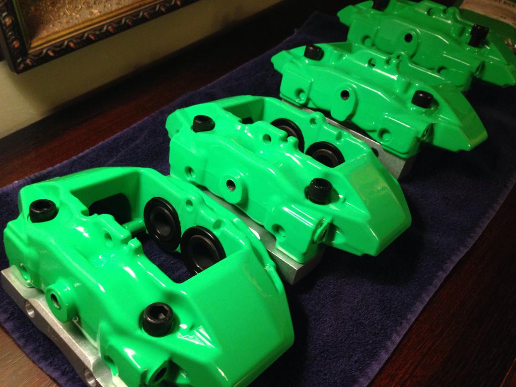

CptTripps Got the calipers back from powder-coating. They lo... Sep 11 2013, 10:59 AM

CptTripps Got the calipers sorted last night. Started rebuil... Sep 12 2013, 01:46 PM

Chris H. Dude those calipers look like candy. Wow. Sep 12 2013, 04:18 PM
CptTripps
They ... Sep 12 2013, 09:10 PM

CptTripps The calipers were powder-coated...the "PORSCH... Sep 25 2013, 09:01 AM
