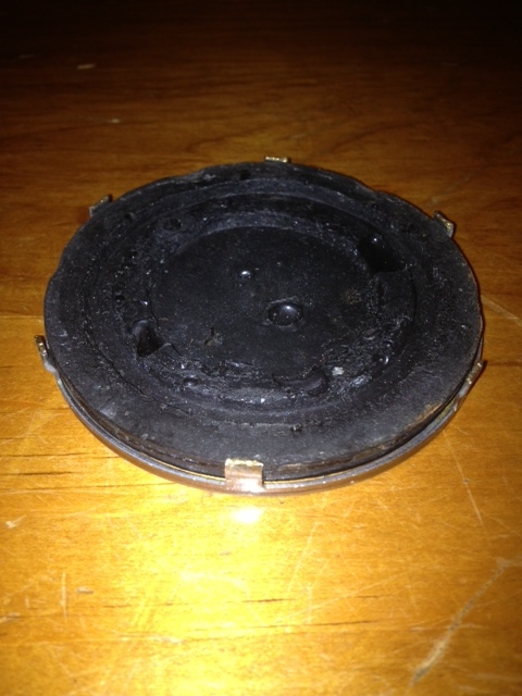

Working on my steering wheel and i need some hints on removing the chrome ring to replace and install new leather crest. tried to bend tabs in both directions and it wont let go? If I break it I will cry
Thanks

Hi Andy! (IMG:style_emoticons/default/bye1.gif)
You might want to PM or email Gustl, as IIRC he restored his puck at the link below...
http://www.914world.com/bbs2/index.php?showtopic=217037

Andy - the chrome ring is removd by pushing the small chrome tabs from the back of the button. Go slow, be carefull. The ring might be tight in the black plastic. There are replacement parts available if things go wrong but there not cheap or origional. These buttons are used quite often by the early 911 crowd so there are many resources available besides our friend Gustl.
Keep going on the build (IMG:style_emoticons/default/smilie_pokal.gif)

Andy, it's just like mepstein wrote
you have to be careful, because the ring fits very tight
but with enaugh patience, it should be possible (IMG:style_emoticons/default/biggrin.gif)
