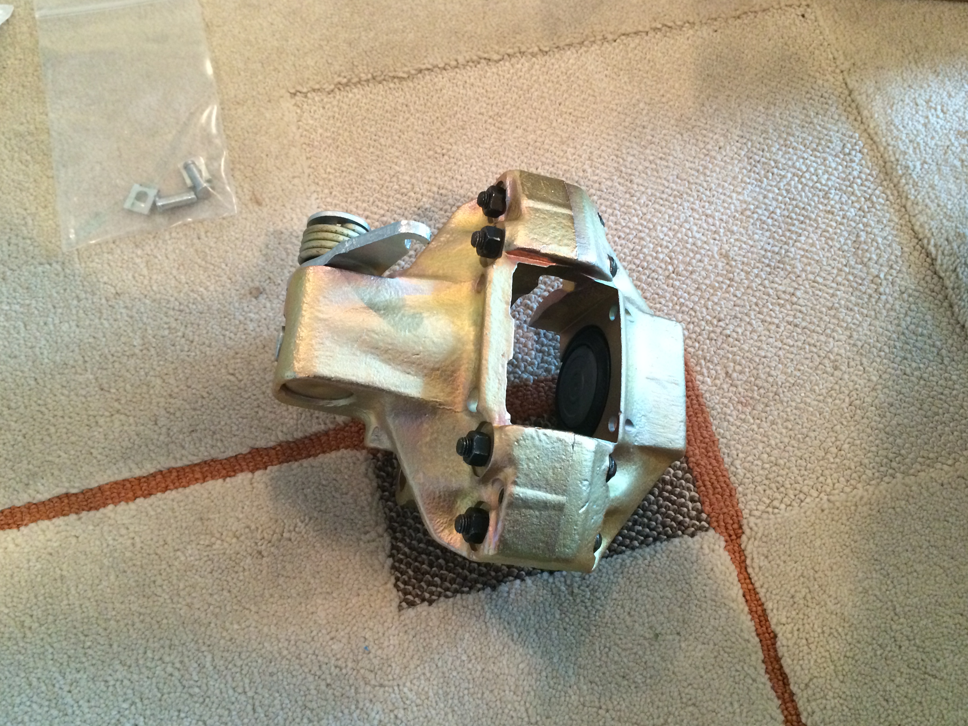

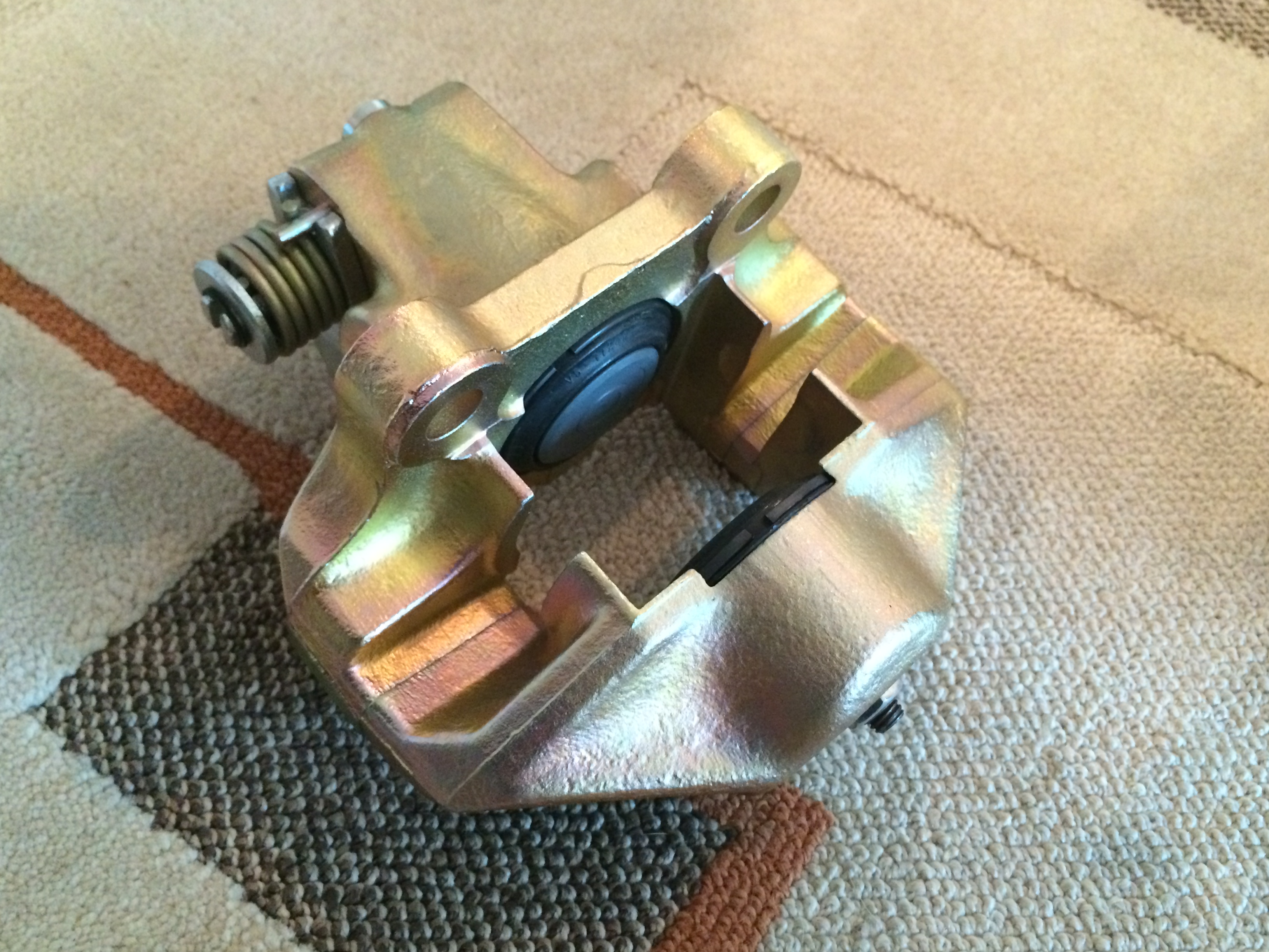

Rear calipers look a little better. I'll try to clean them up a bit before putting them on. (IMG:style_emoticons/default/smile.gif)
-Steve

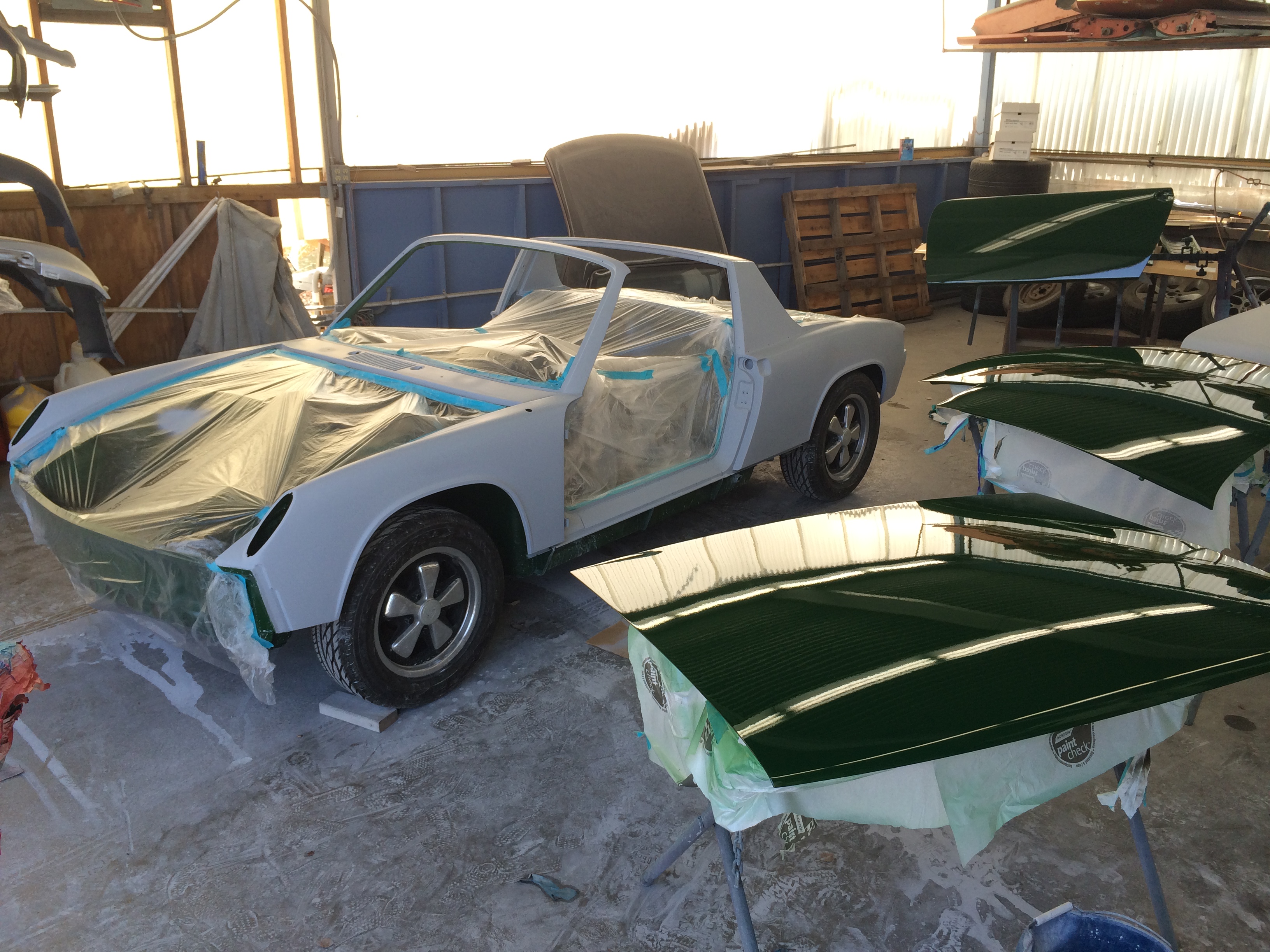

Body to be painted next week. No more white and almost back to Irish Green...
-Steve

I had sort of a strange question from the body shop today.
SHOP:
After review ...<snip>..., but we had no time for
color sand and buffing. So I just need to know how flat you would like the
finish product, I will take care of any dirt specs or drips. I know we
discussed leaving some orange peel but it is up to you.
ME:
Ok, understood. I'd like it to look really, really, nice. To be honest, I wasn't aware that some people intentionally left any orange peel.
SHOP:
but we had no time for color sand and buffing
ME:
I guess I assumed this was just part of the quote to "paint the whole car".
Regardless, how much time or money are we talking about? I don't want to cut corners now to save a small amount of time because this final work can have a major impact on the final product. So what's it take to make it really nice? I understand it's not a "Ridler show car", but the initial orange peel I saw the other day was way too much (looked like it was just sprayed which I understand).
My initial thought is I'd like it to be at least as flat as the original 1970 paint was, and probably a little better. I'll also research more to figure out what the right answer is.
So, 914world, any tips? How much orange peel is "right" for our cars?
-Steve
Maltese Falcon
post Jun 10 2014, 12:14 PM
Post #133
Posts: 5,267
Joined: 14-September 04
From: Mulholland SoCal
Member No.: 2,755
For my dollar with new paint, it has to be wet sanded and buffed . An original painted 914 + its texture (original patina) is there for the next buyer; or with a re-spray = a better looking car but no longer original paint/ texture. As far as affecting the values of the 914 at the selling point, some people want the unrestored patina / others welcome fresh + perfect. I think that color change affects value downward. I think your body shop is taking the short road on your deal.
Marty

No peal. Blocked, buffed, polished, hand rubbed. BTW: Single stage not clear coated. The reflection looks softer like factory paint.

Talk to ScottyB...there's also the option of factory finish if it's been polished for the past 40+ years. One of our 356 friends wanted a factory finish, which means orange peel....saw another guy's original paint car that's been buffed/polished for 50 years...naturally he wanted his paint like that. FWIW the car won best of show at the Deutsche Marque Concours
Basically if you want it to look old stock, you'll have to buff/polish the orange peel out.

QUOTE(rick 918-S @ Jun 10 2014, 10:07 PM) *
If it's been curing this long, a good block sand and a good polishing would do wonders on it. !!!
