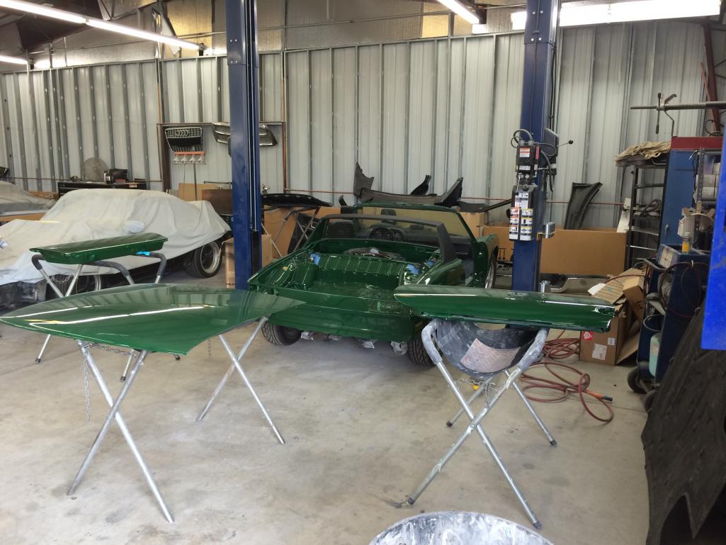

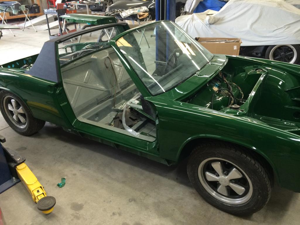

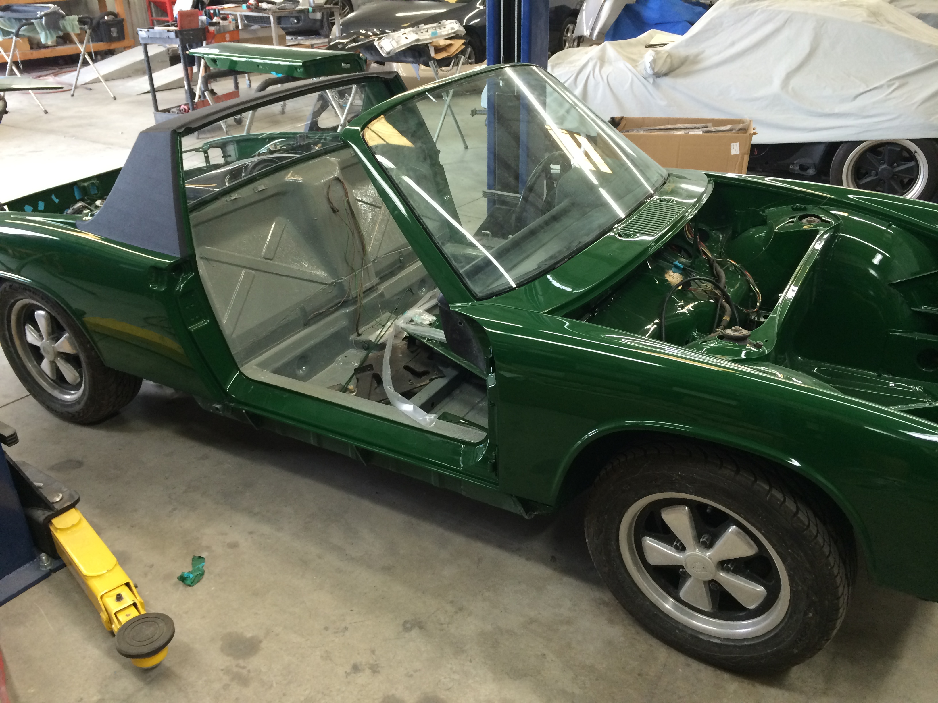

Getting closer... (glass is back in)
-Steve

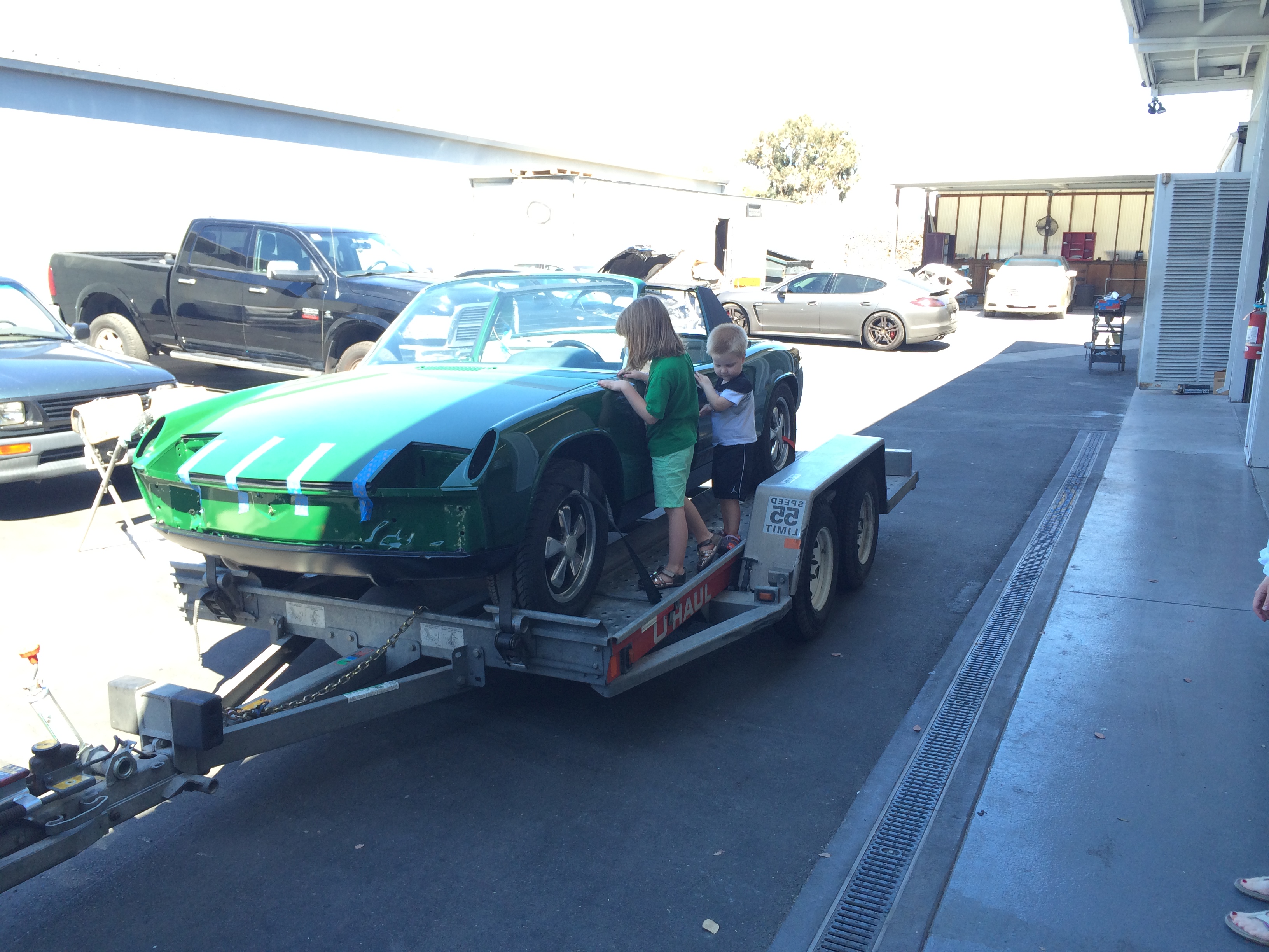

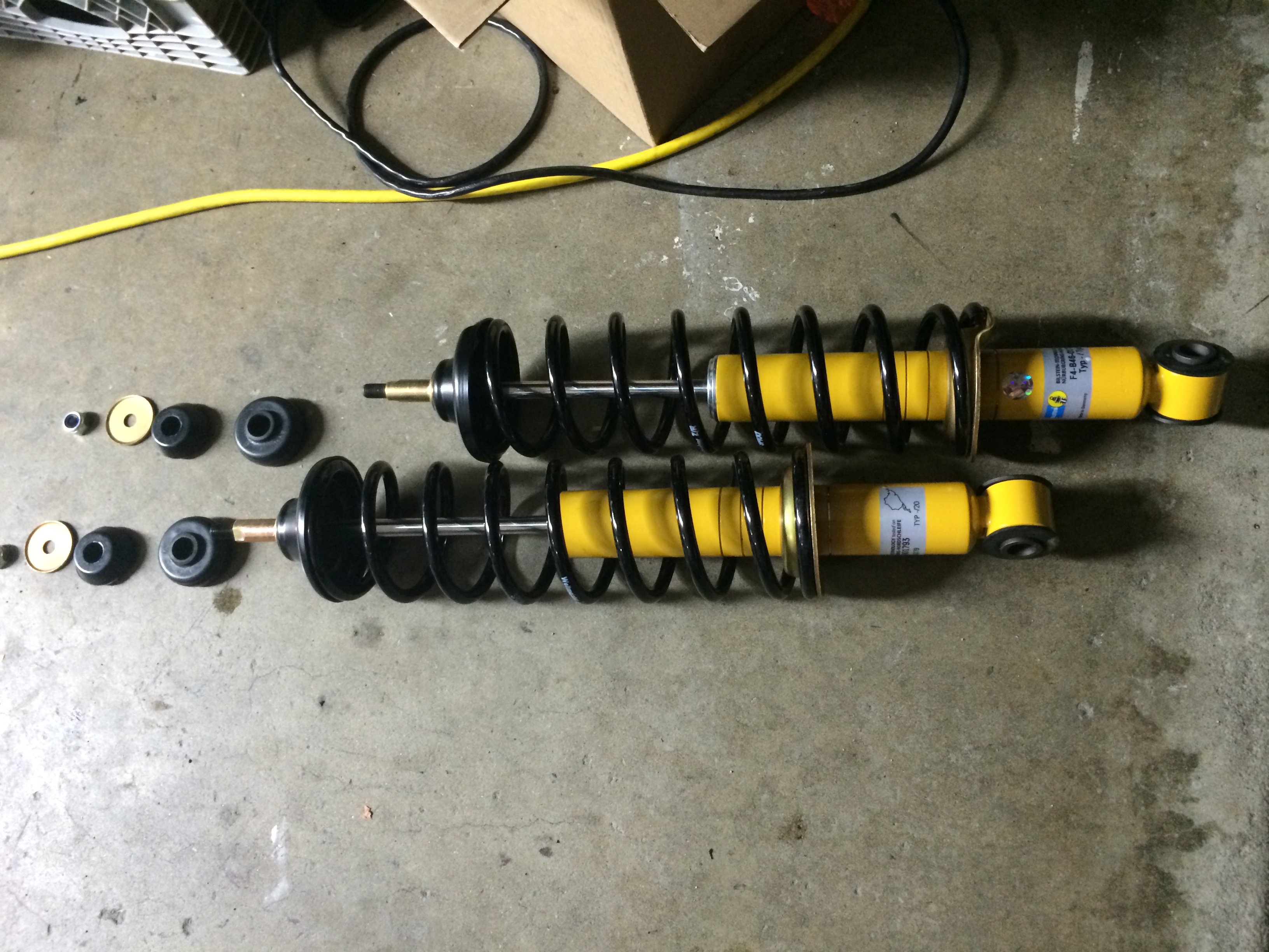

On the way home for further dis-assembly (suspension) and then re-assembly.
-Steve

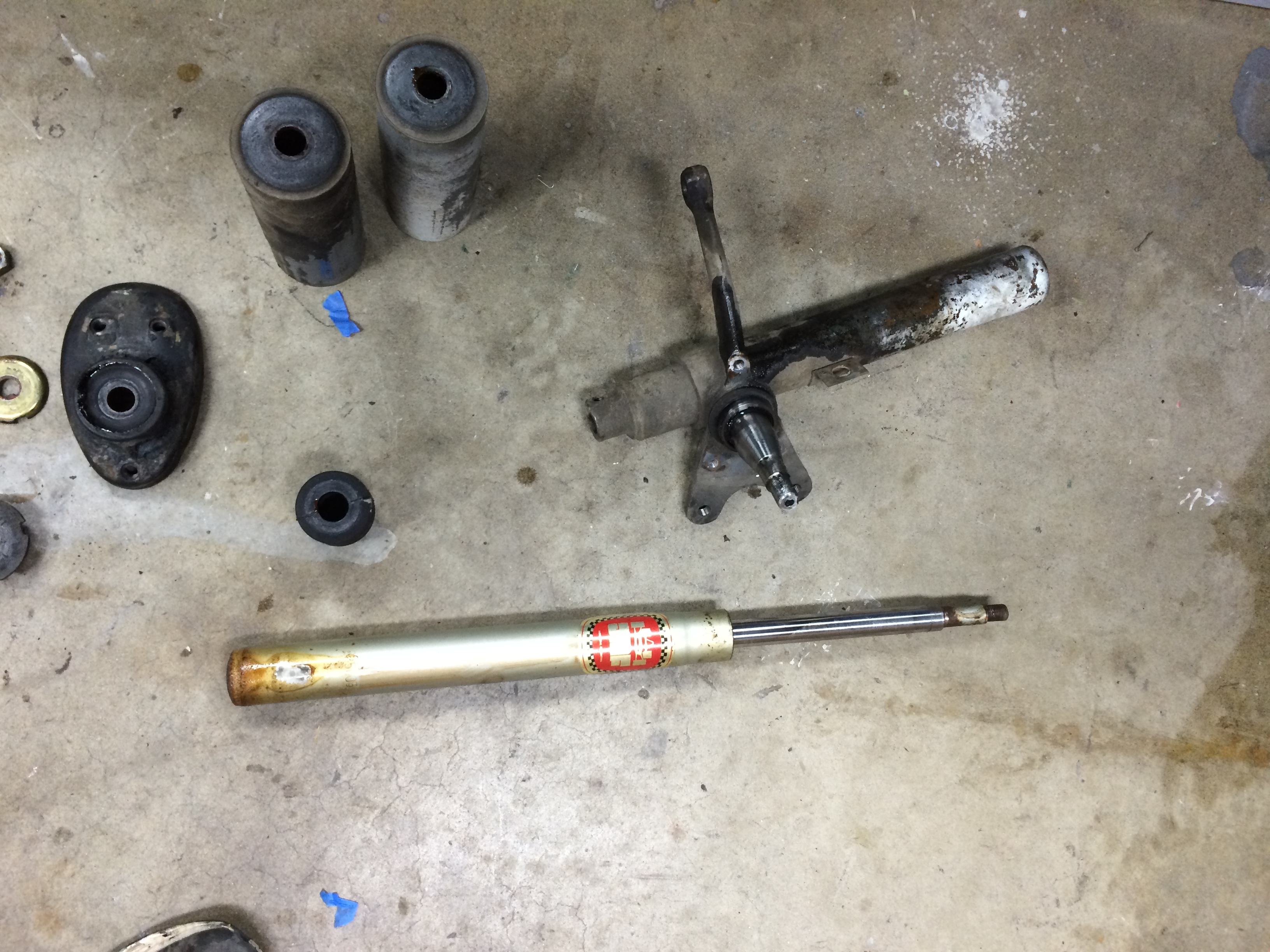

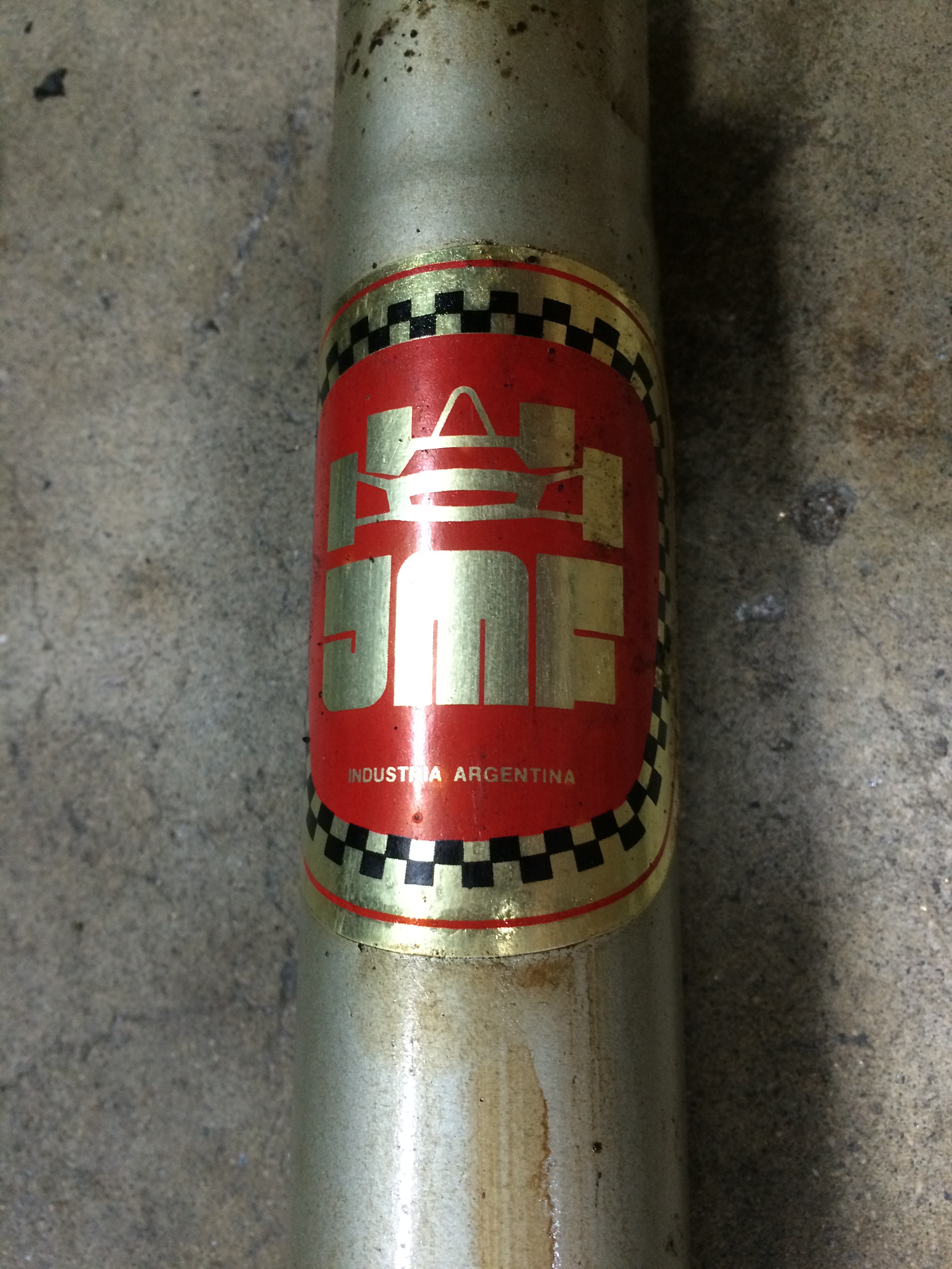

Anyone ever heard of this brand of shocks? It was on all four corners.
All the suspension components on this car were totally shot - most were original. The other strut insert fell apart and leaked oil everywhere when I pulled it out.
And it still had the original (long) rear springs - I hadn't removed a set of those in 15+ years or so. I don't have a spring compressor, but my kids were amused how I could "shoot" the retaining nut and plate across the yard. It was relatively safe operation; I setup an 914 shock part artillery range in the front yard because I knew what to expect after having been quite surprised many years ago.
-Steve

Hmmm.... ?
https://www.google.com/?gws_rd=ssl#q=JMF+argentina
-Steve

You had to look that up? (IMG:style_emoticons/default/biggrin.gif)
Strange though, didn't know he had his own line of signature shocks...

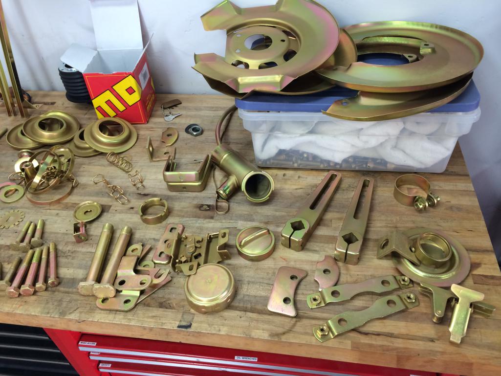

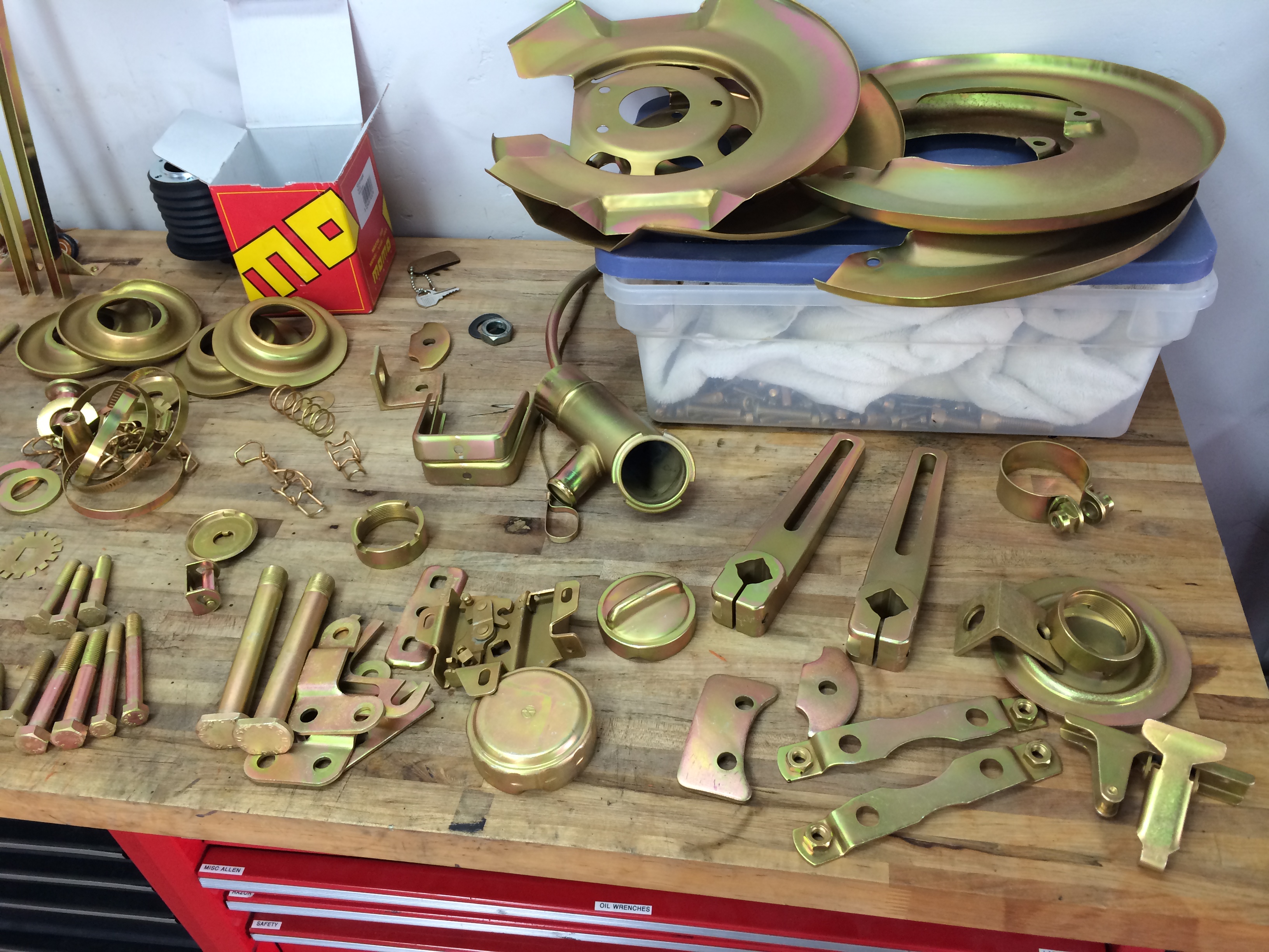

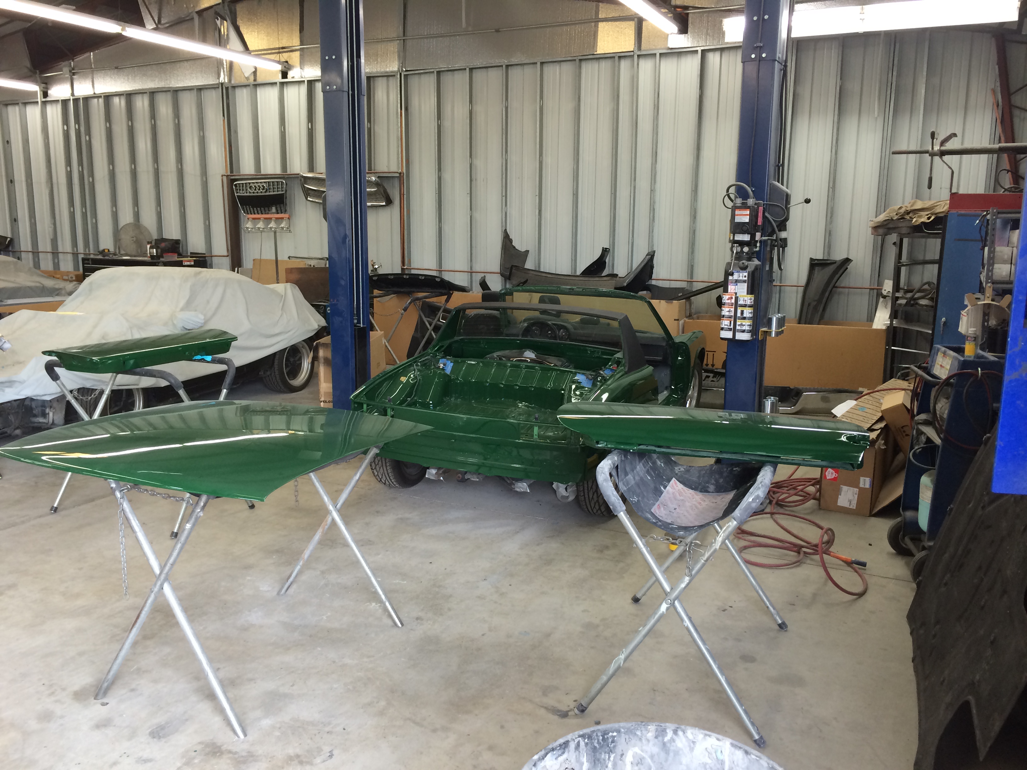

Most of the plating and powder coating is done now. It's always hard to put cars back together like this and not make it too nice - this car will be 100% driver. Why do I need to re-plate the window guide that is inside the door that no one will ever see? I have no idea... (IMG:style_emoticons/default/smile.gif)
-Steve

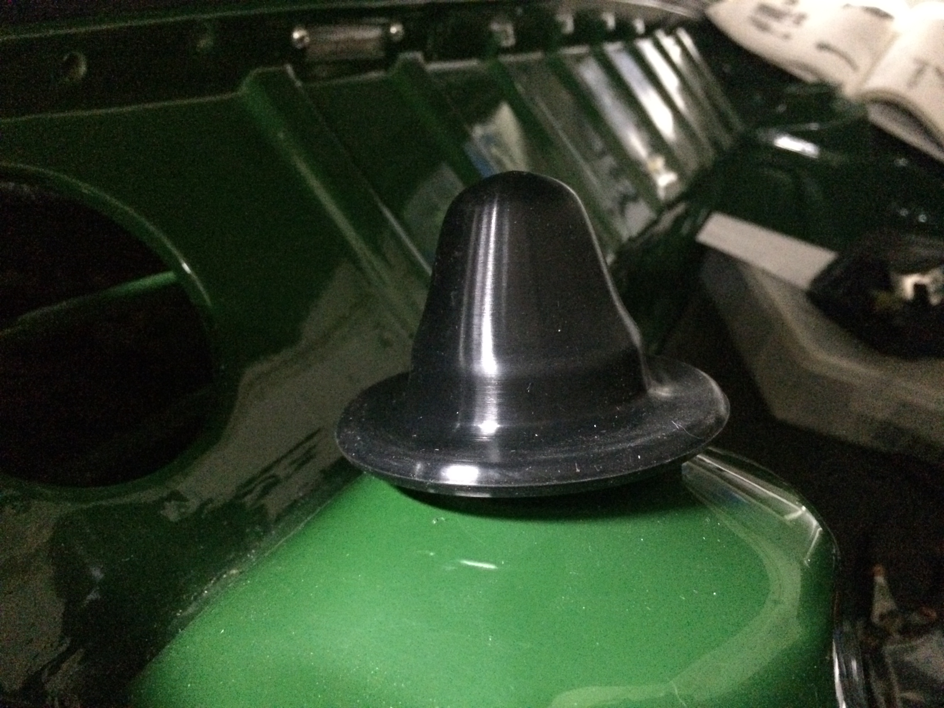

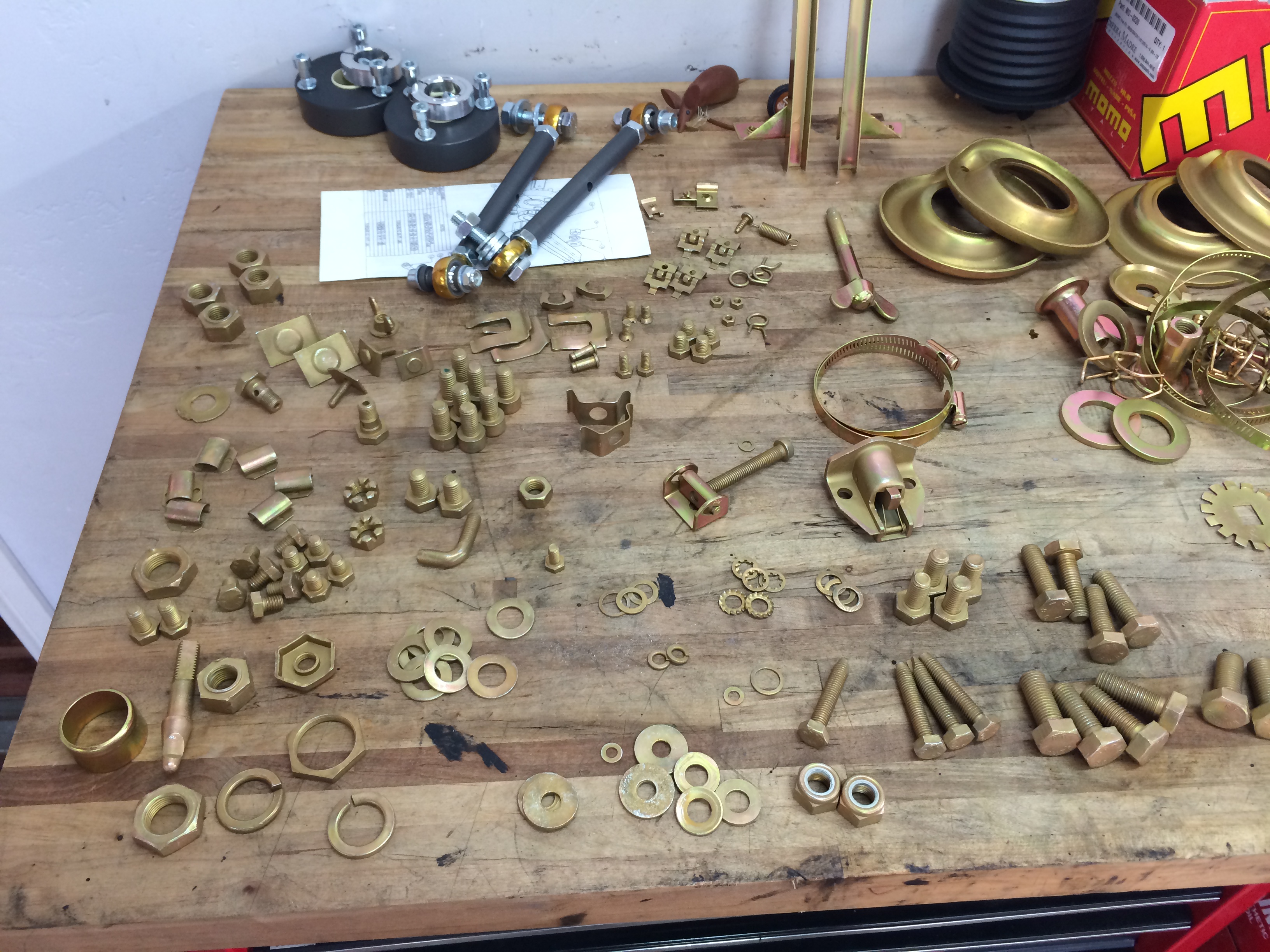

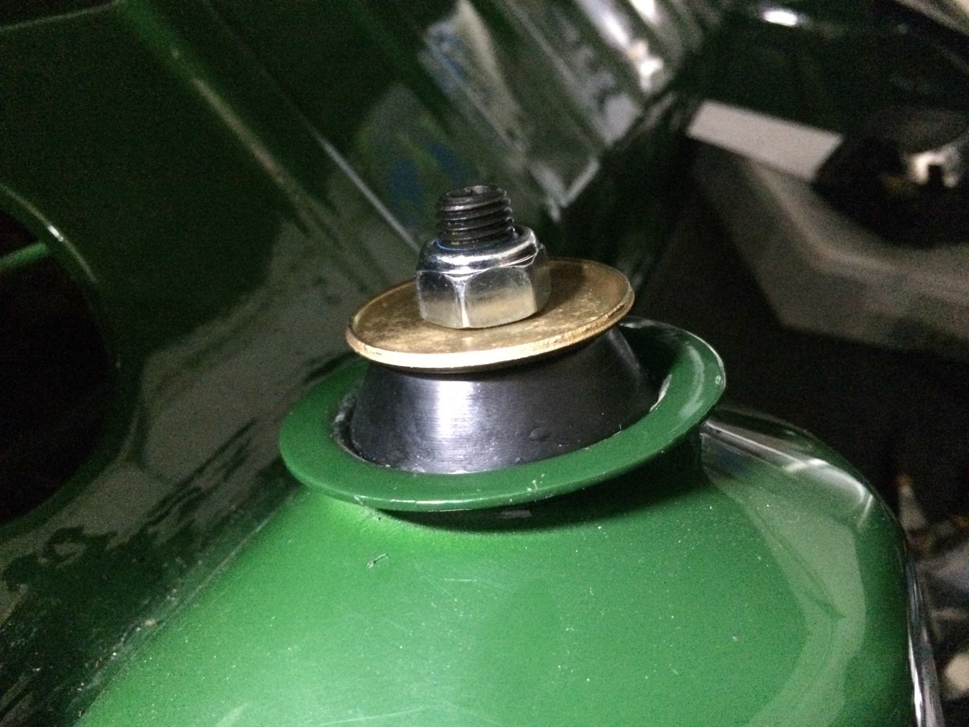

That "upside-down washer" on top of the rear shocks never looks right to me, but I'm pretty sure that's what the Haynes manual says.
It's been a while since I've re-assembled a stock shock mount. Is this right?
-Steve

another... Is this right?

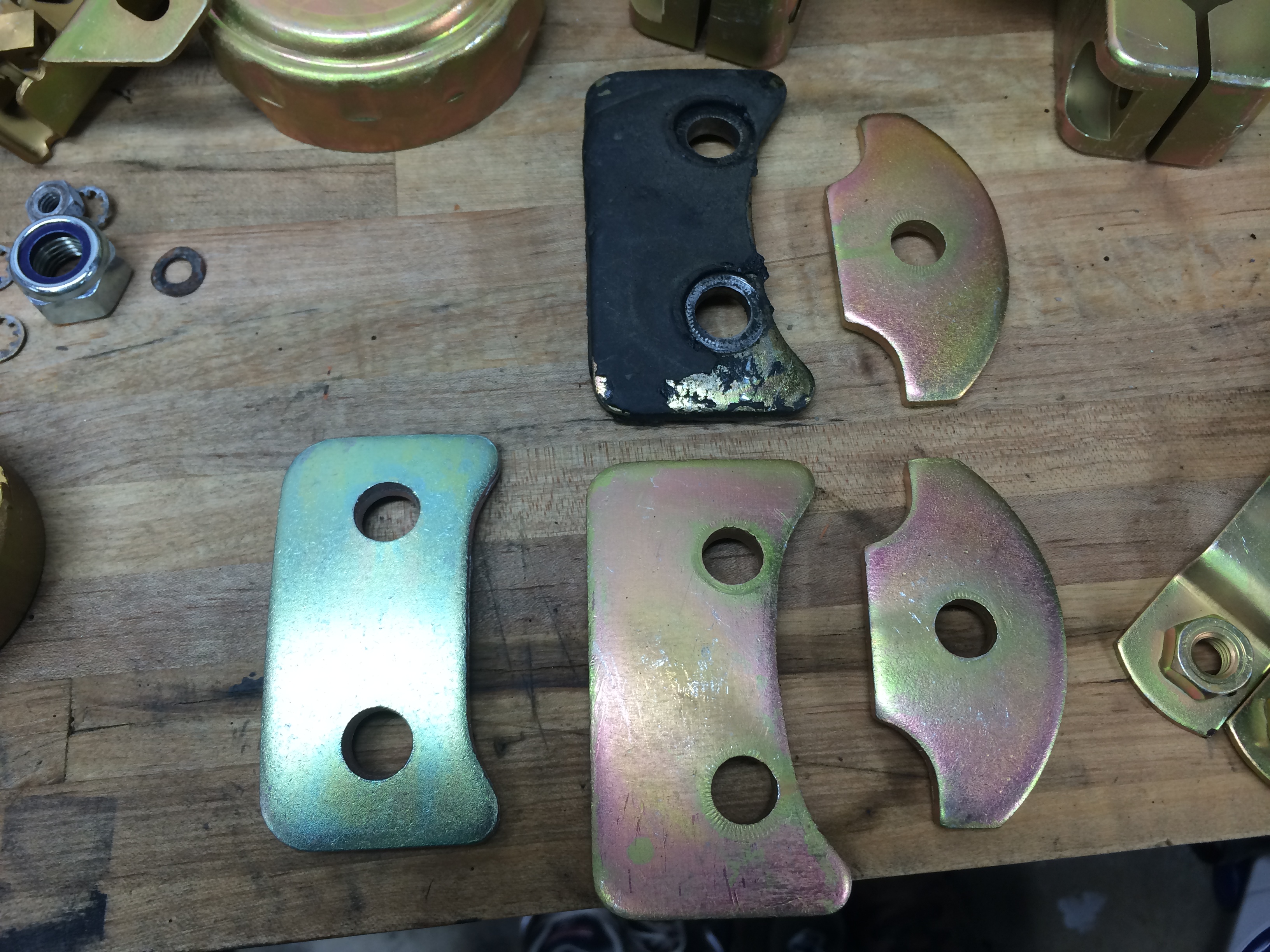

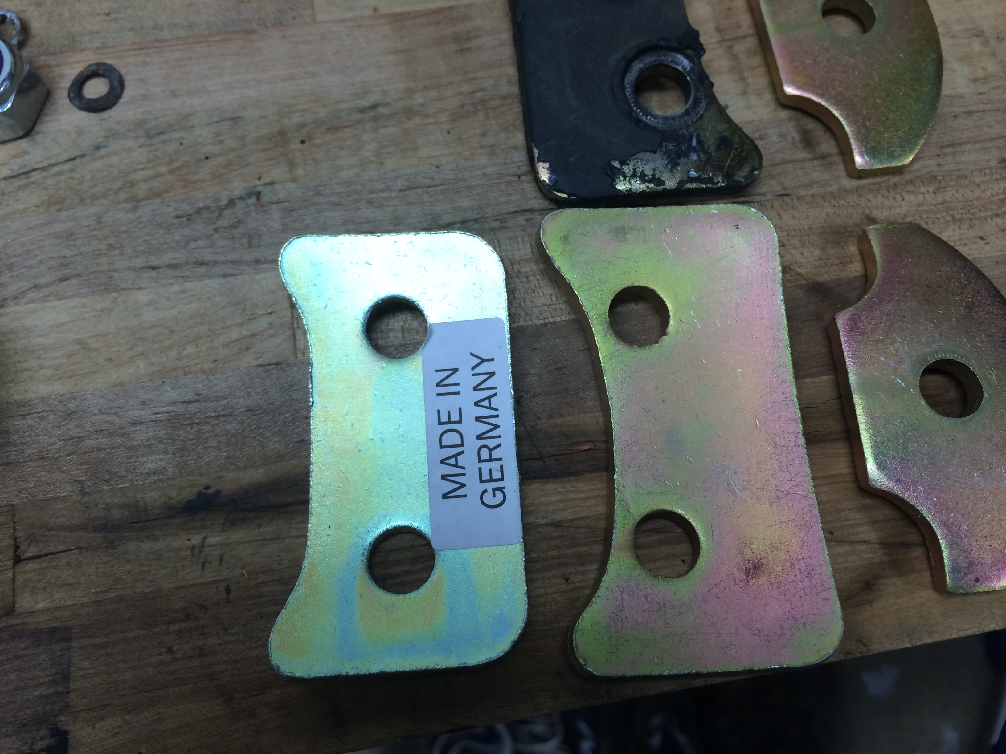

Another new item I learned is that the front shock mount plates are not all the same. I ordered a new one that came from Porsche, and it doesn't match the originals - it's a little smaller.
-Steve

And yes... I re-plated those shock mounts and then I'm going to cover them up with black -6 goop again. I'm an idiot. (IMG:style_emoticons/default/smile.gif)
-Steve

The smaller mount looks like the one for a early 64-68 911.

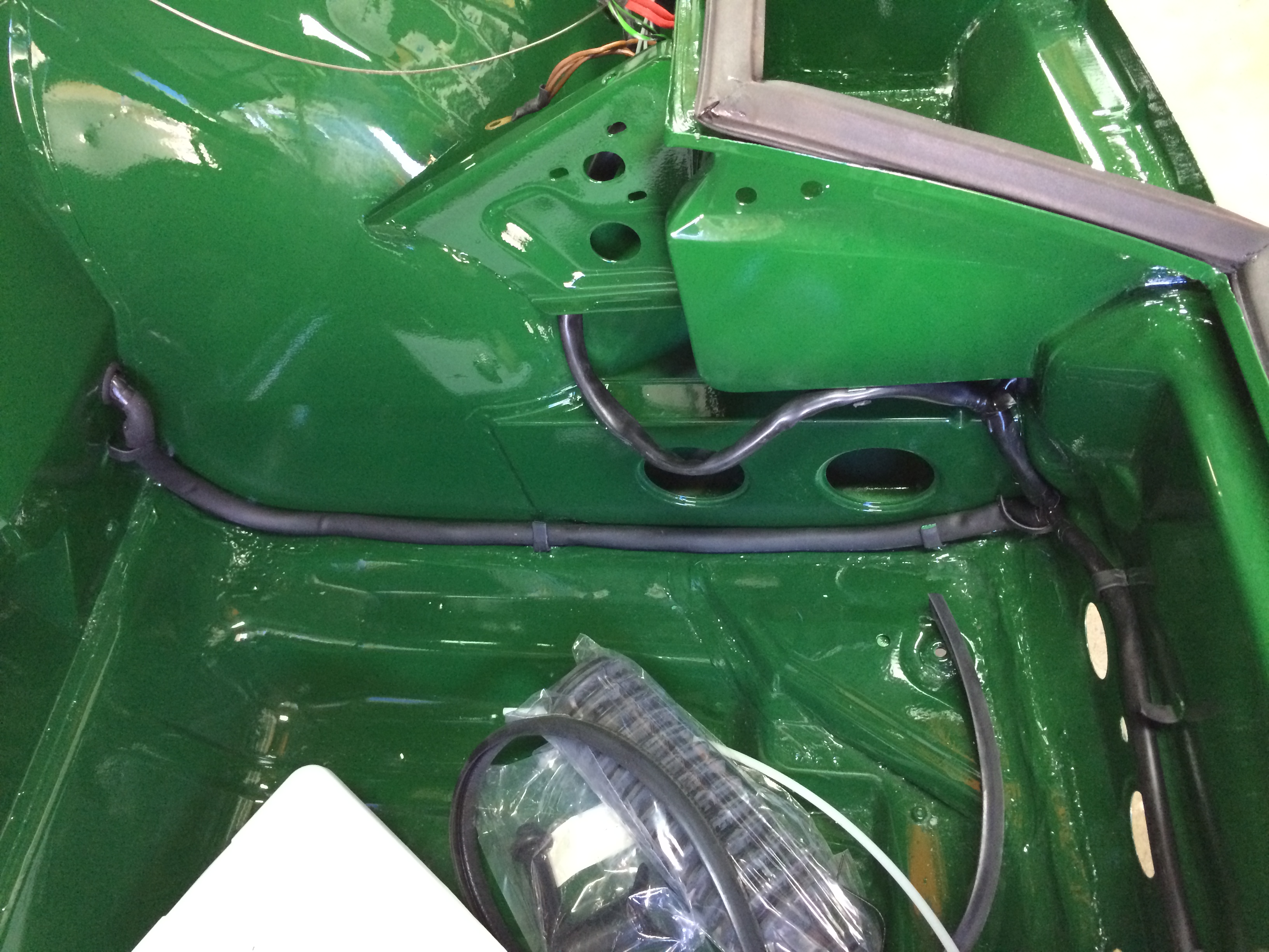

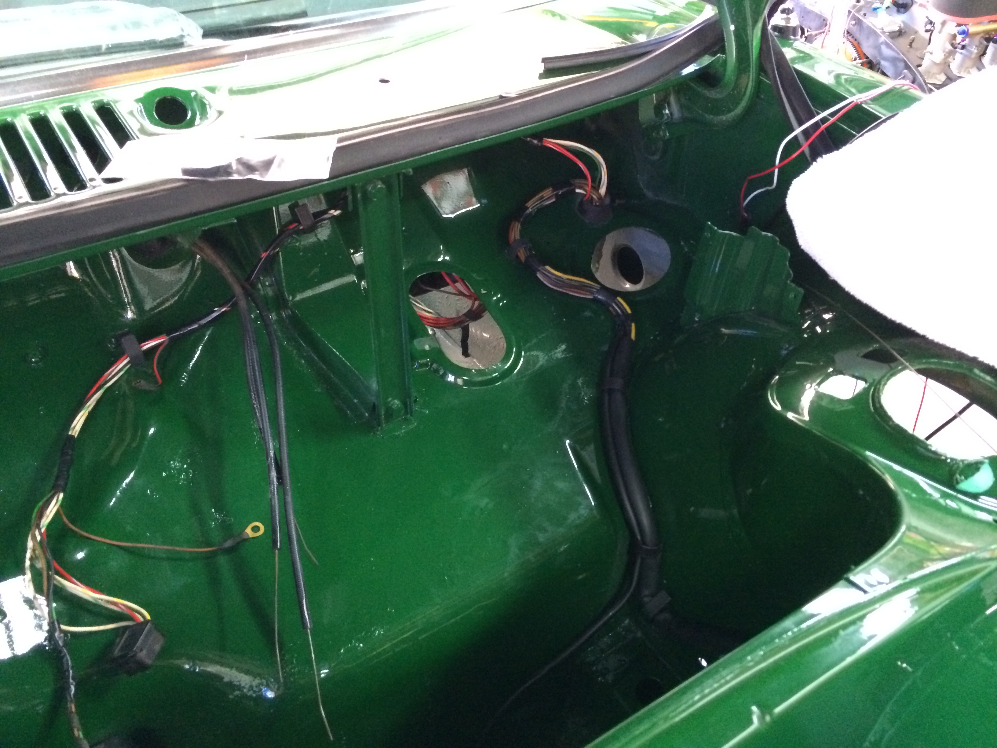

Lots of work on the 914 this weekend, but not a whole lot of progress to show. I got the engine grill, rear lights, bumper, and valence installed, I thought I'd tackle the front turn signals. But, to do that I had to:
- Fix old hacked "repairs" in the original wiring harness
- Clean up old (white) overspray on the wiring harness
- Clean up the grounds.
- Install power antenna (to add to wiring harness).
- Apply heat shrink tubing to all the wiring harness tie downs. Man, I forgot how many of these things there are up there! They are everywhere.
So, about 6 hours later (literally), I had the front turn signals installed and working.
-Steve
