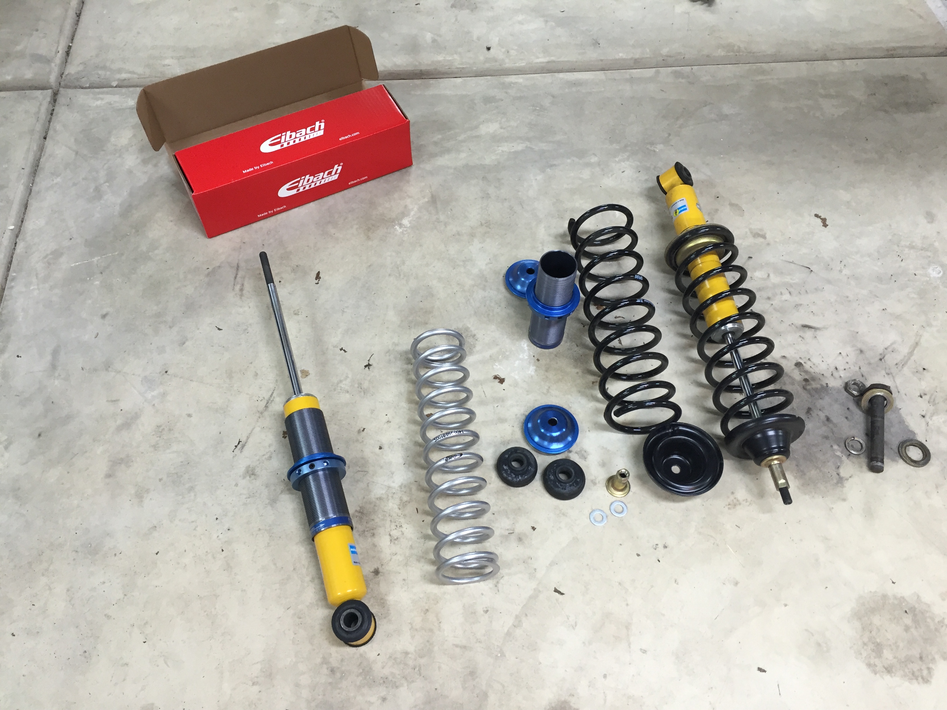

I finally got around to replacing the 3.5" ID 100# springs with an adjustable collar with 2.5" ID 100# springs.
Maybe I'm getting old, but I really like how a fairly stock 914 handles, which is why I stuck with the 100# springs. Car has:
- all new suspension rubber bushings/etc (Elephant I think)
- stock front torsion bars
- 100# rear springs
- Bilstein shocks/struts
- 19mm Tarrett front sway bar
- 185/65 P4 tires
- fairly high ride height
And I think it just rips. Comfy (as far as 914s go), corners almost perfectly flat, and the grip can really exceed anything that I probably should be doing on public roads. Or, again, maybe I'm just getting old. (IMG:style_emoticons/default/smile.gif)

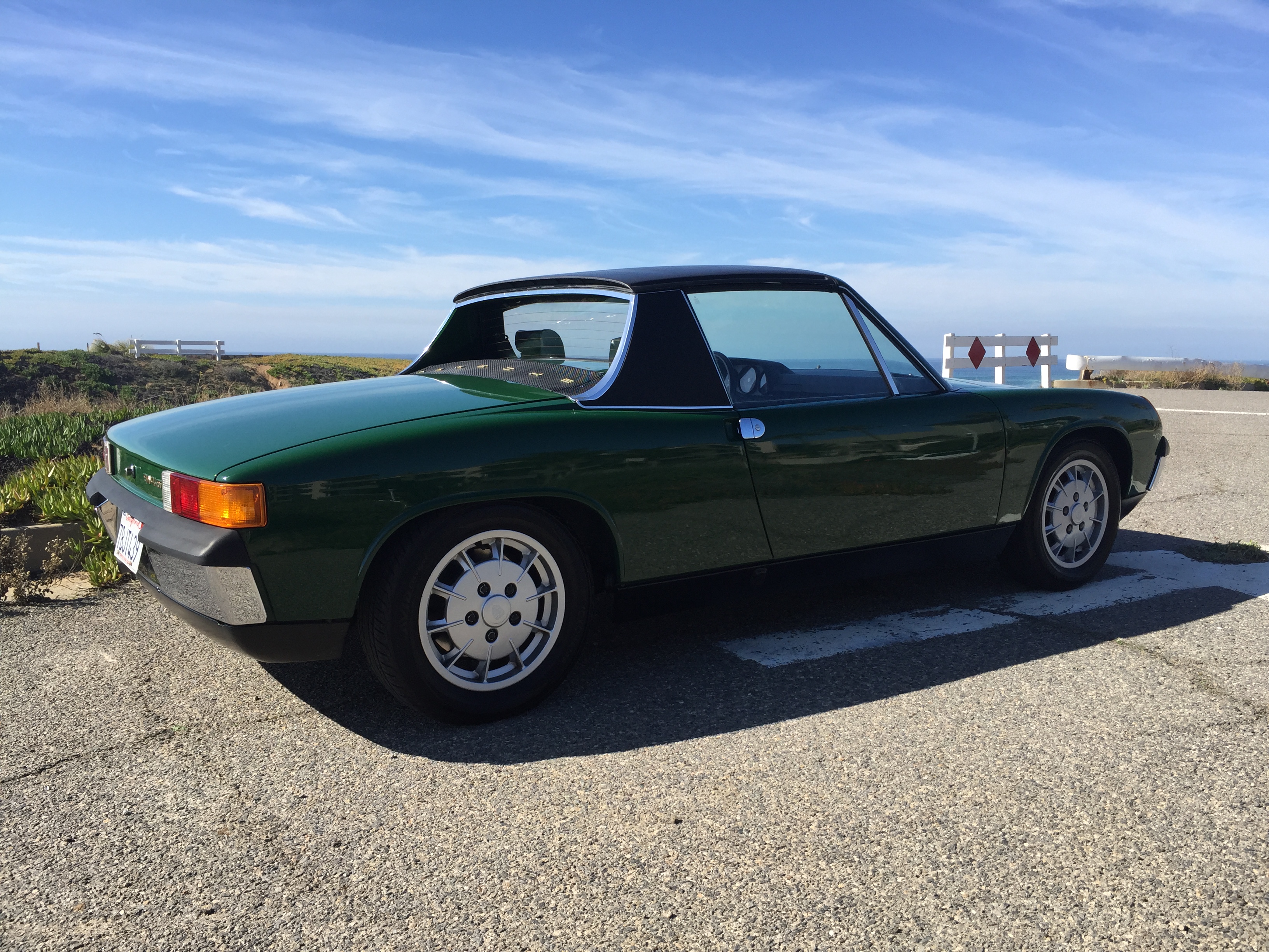

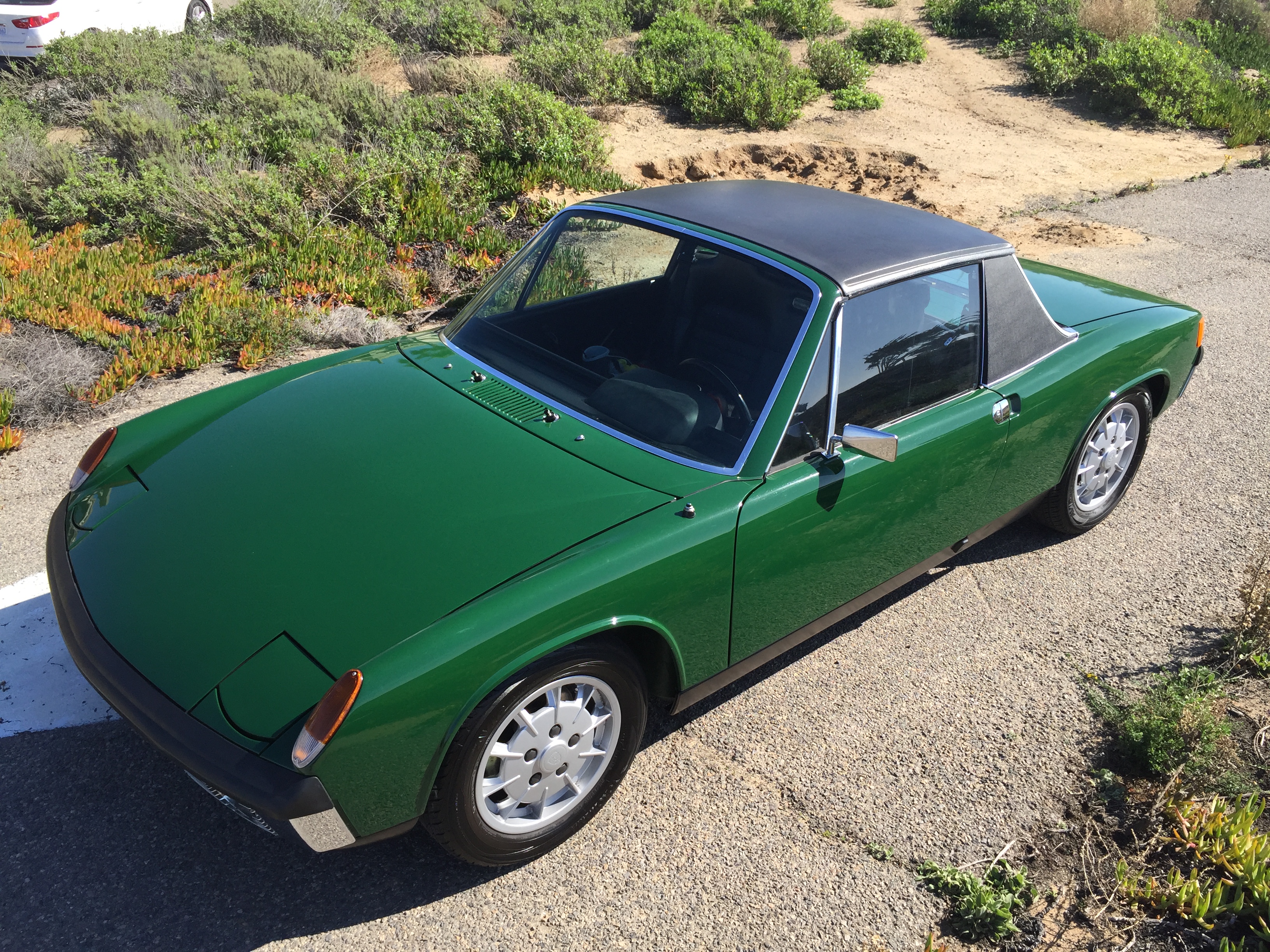

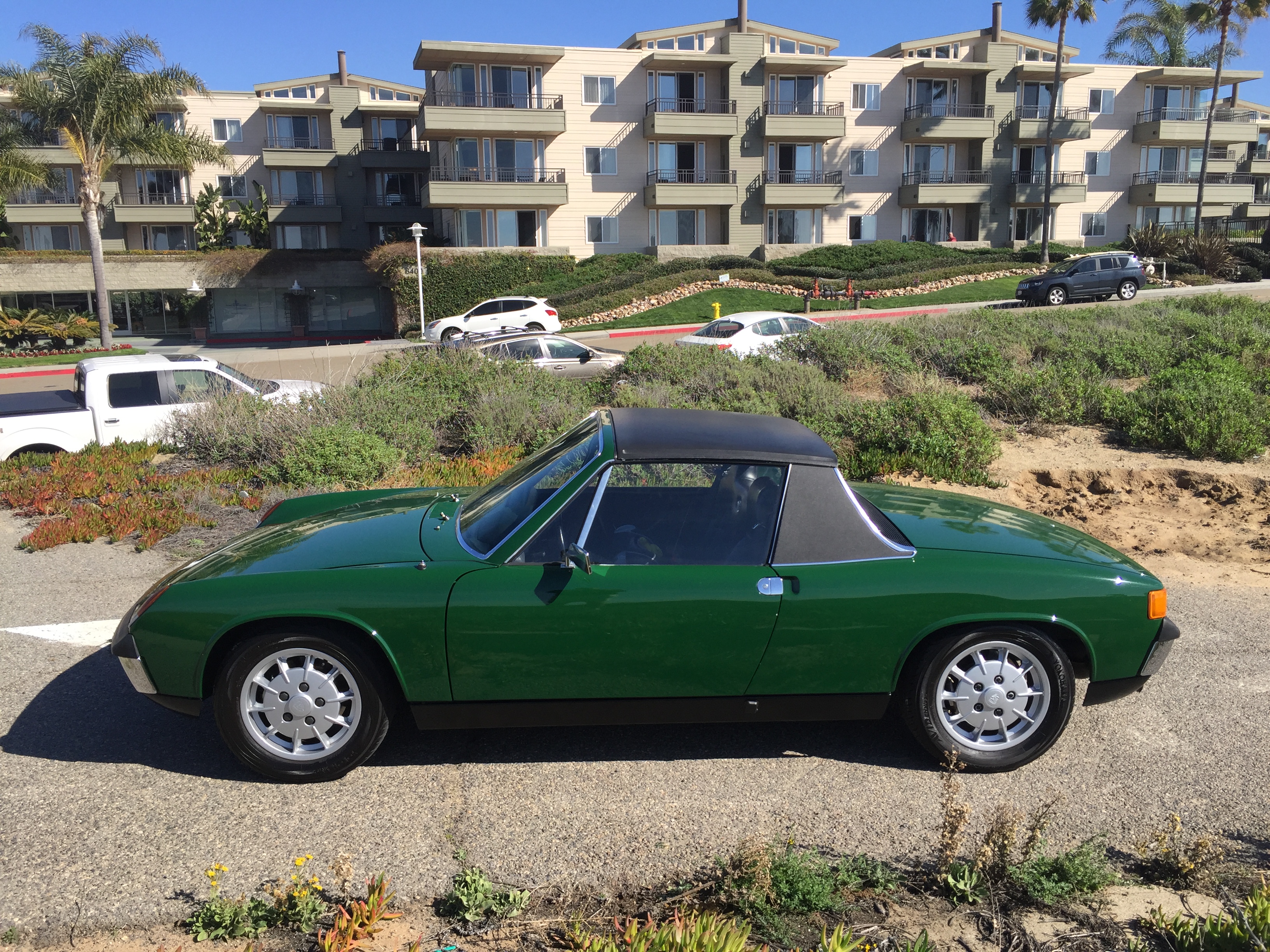

When I did this, I also wanted to raise the back a little (3/8" or so) because it looked a little off. New ride height is in photos below.
With these relatively soft/stockish springs, what is surprising is the left rear corner will drop about 1/2" (a lot!) when I sit in the car (6'6" 270 lbs). So it's not exactly corner balanced, but I did set the ride height even on a left/right basis when I had about 270 lbs of big rocks in the drivers seat.

That is my fav color for a 914.

Most every original Irish green car I've seen has had a crappy color change. Usually some red or white. The wheels and bright work set the IG off.

Paint and the Gas burners look stunning !

Boy that is NICE. GOOD JOB! Love the euro lenses and absent side markers!! And love those wheels on that car!
