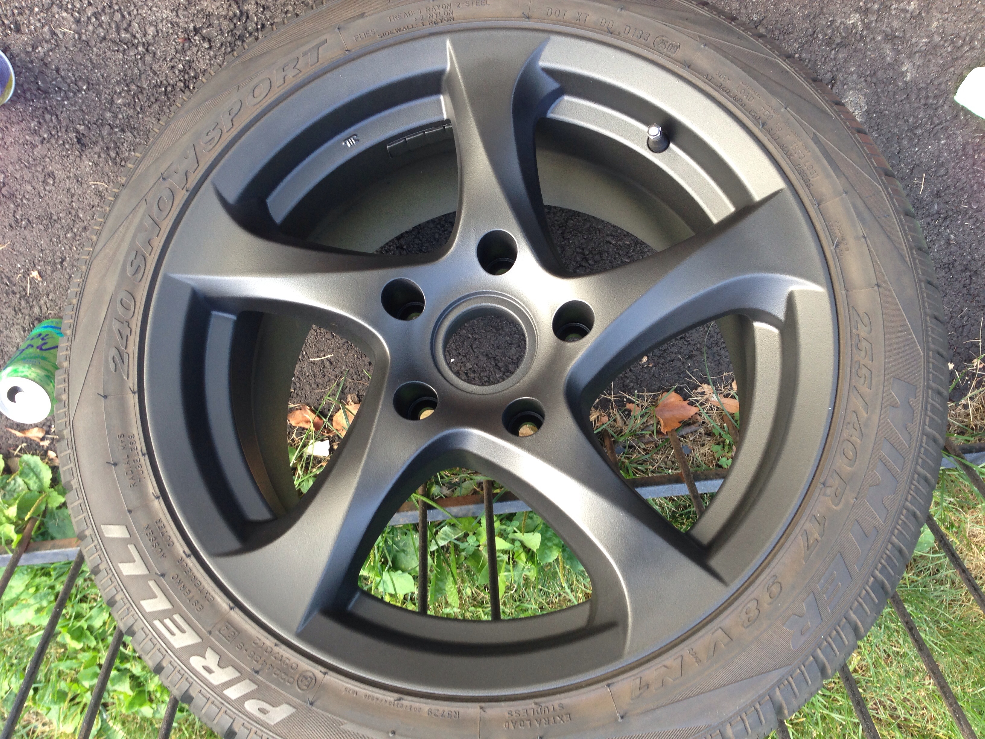

I bought a few cans of the spray to see what it would look likely my rims. VERY easy to spray on and got great coverage. I am going to let it dry for a fee days, but here's what it looks like now.

That looks SWEET!
I bought a can to do a two-tone on my daughter's softball batting helmet, but haven't done it yet. Also been thinking about doing my wheels. Hmm, looks like a holiday weekend project...

Home Depot carries the base colors (White, Black) for only $4.50 a can! I also bought a can from HD of the "Glossifier" that I'll do a coat of on another rim (on top of the black) tonight to compare with this rim. I can always peel it off later. I figured I'd start with the Black on these rims to see how it would look from an application & finish standpoint.

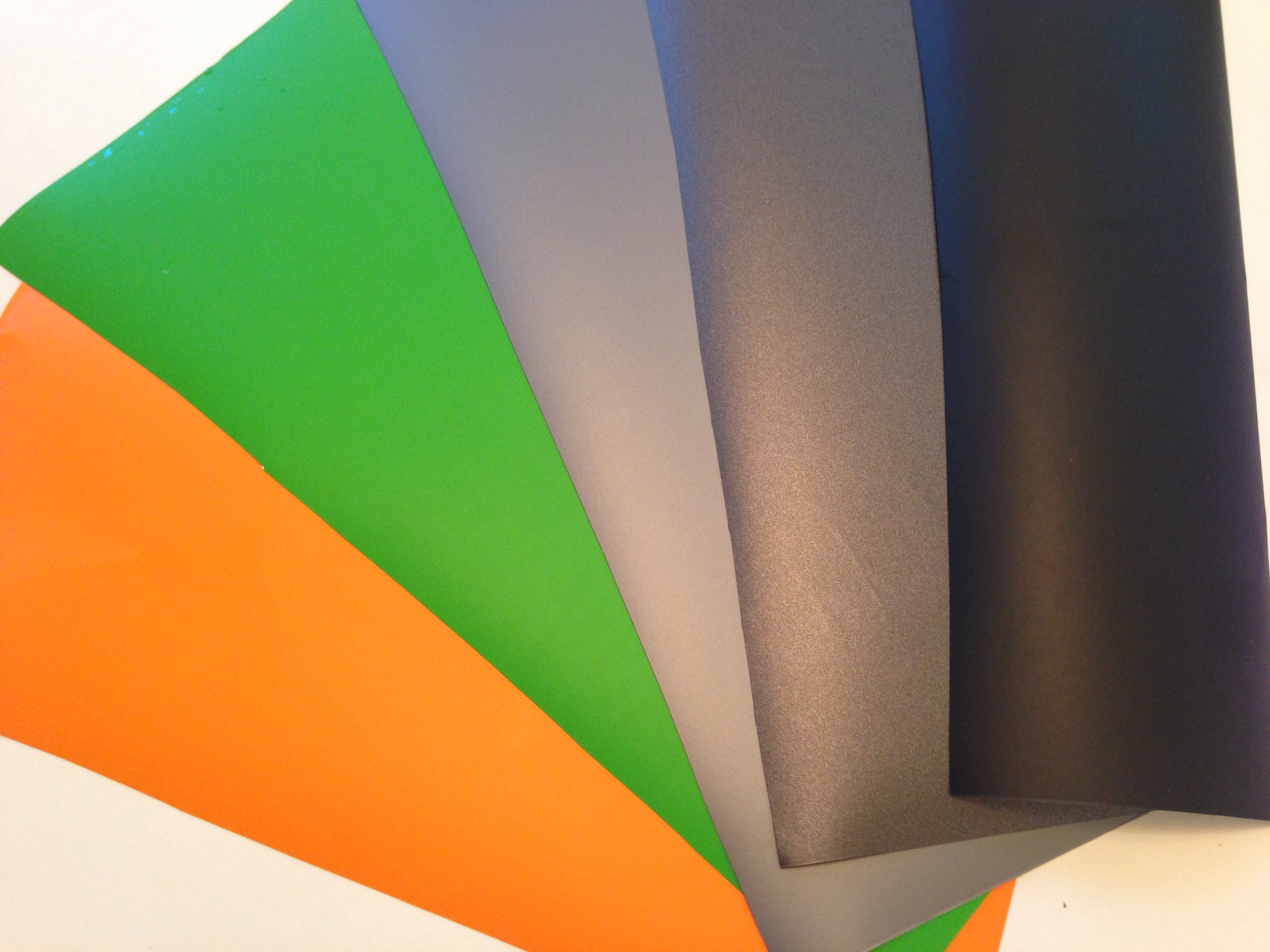

Got my Scotchprint samples today.
Immediately, I can see that this will be a lot higher quality than the PlastiDip. The other side of that is PlastiDip will be more forgiving for sure! I'll need a very smooth finish to ensure I'm not making a small inperfection MORE pronounced.
I'm going to put a few pieces on my car a little later today.

QUOTE(CptTripps @ Aug 29 2013, 10:24 AM) *
I've been thinking of doing this to either Fuchs or Mahles. Seems like a matt finish? More pics?
