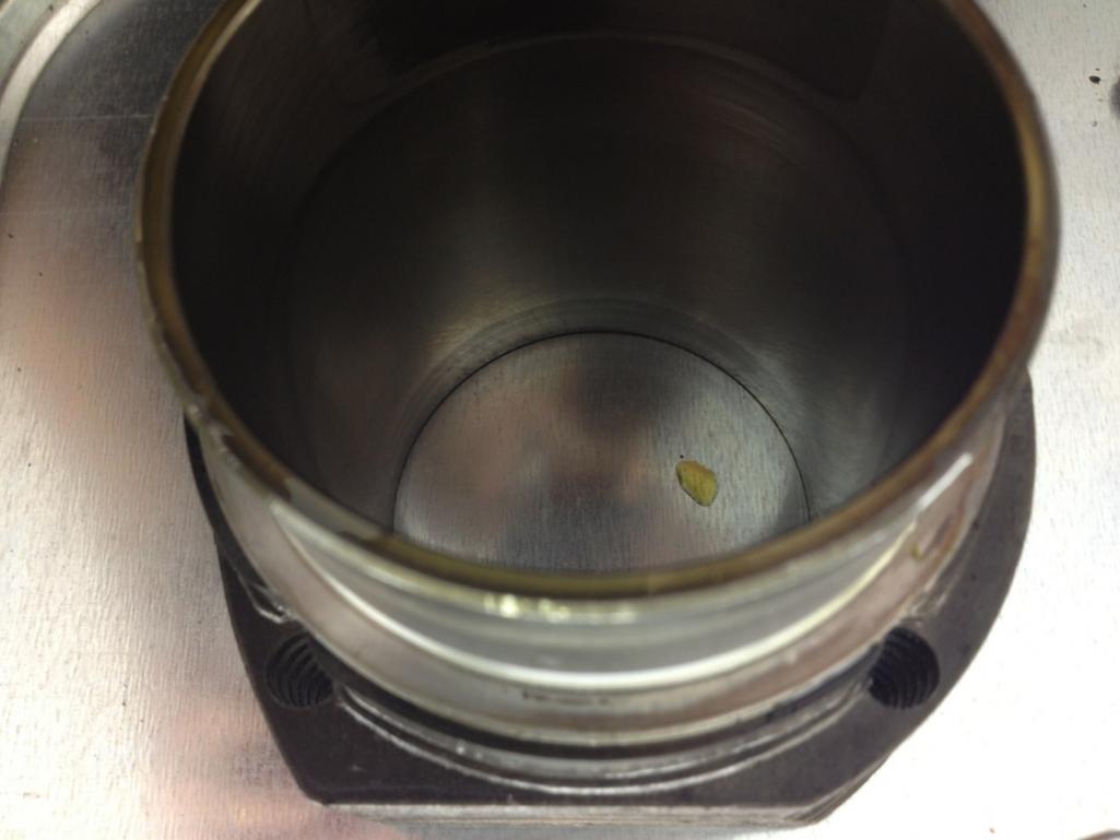

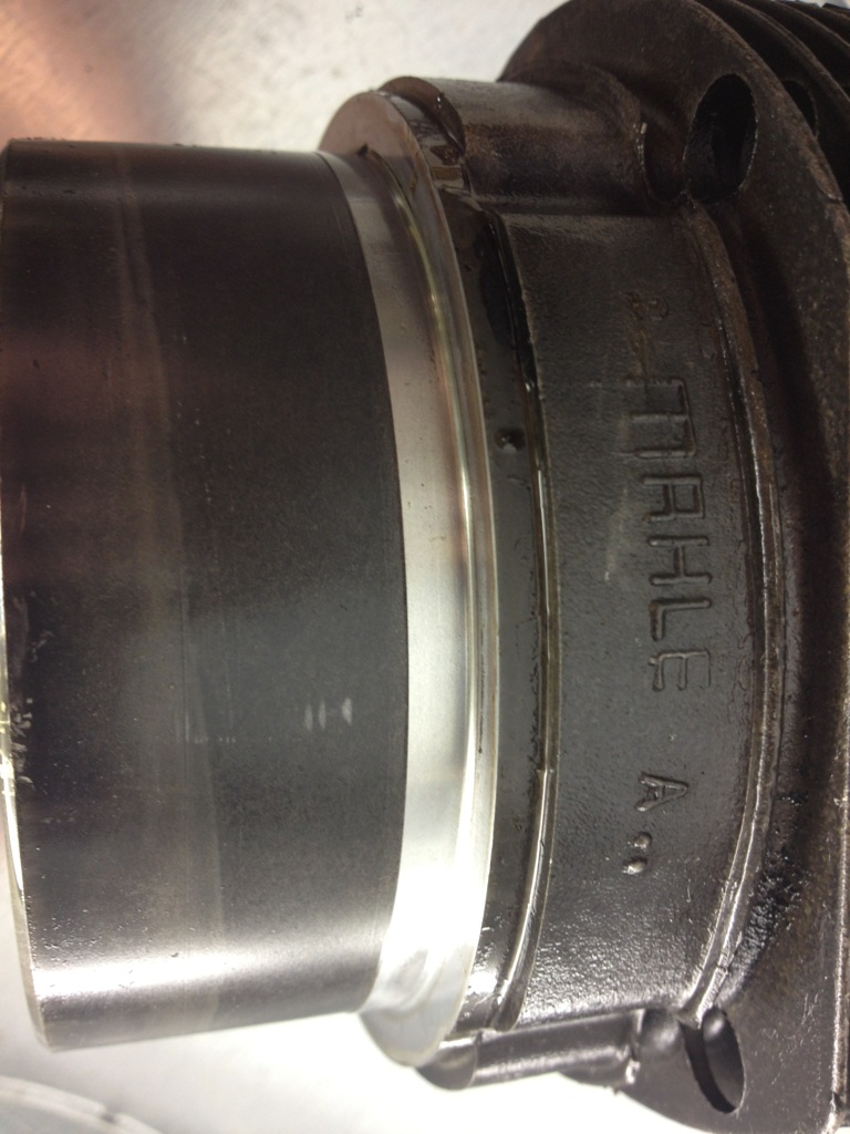

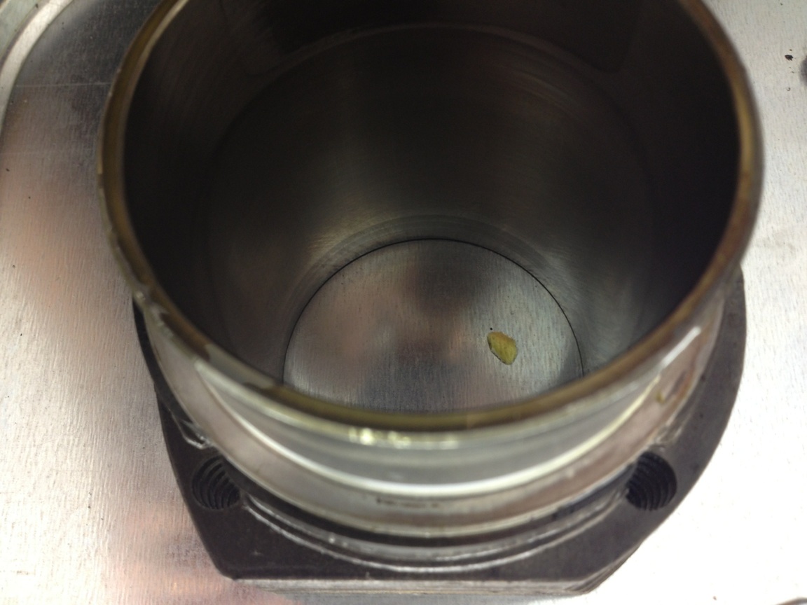

Cylinders [Mahle]

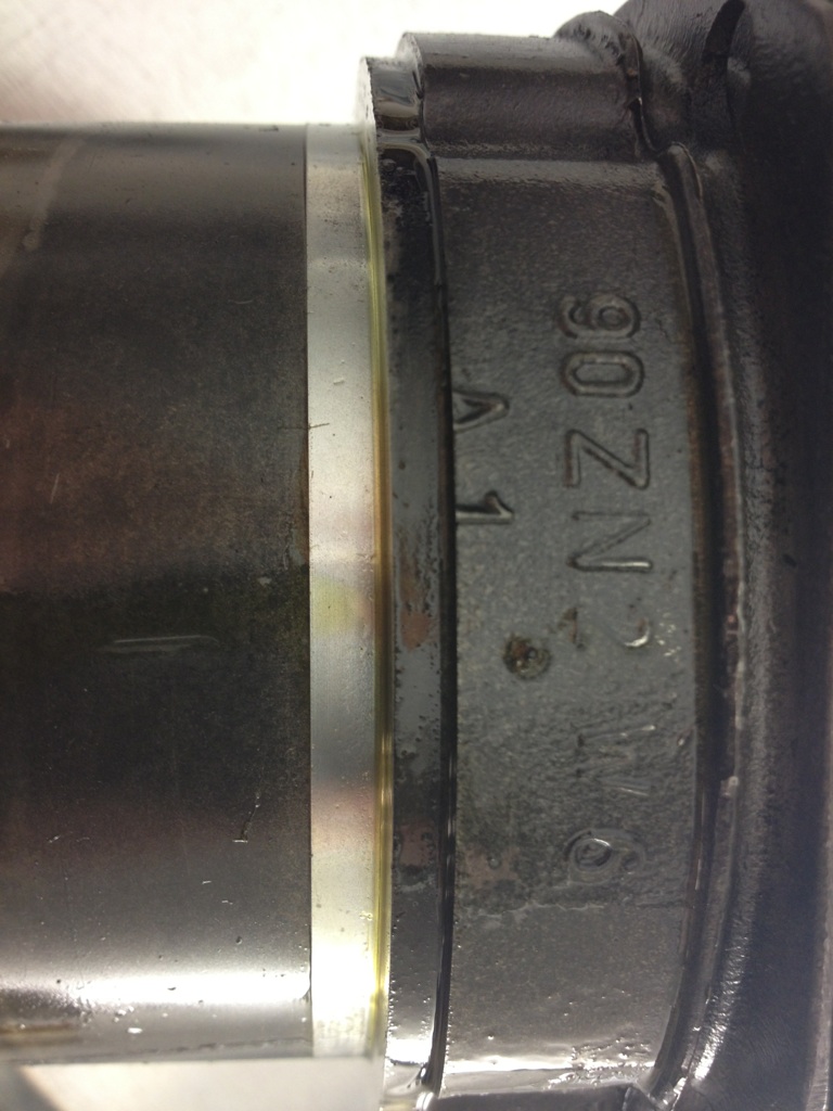

90 ZN 2 W6 [5x]
90 ZN 2 W5 [1x]

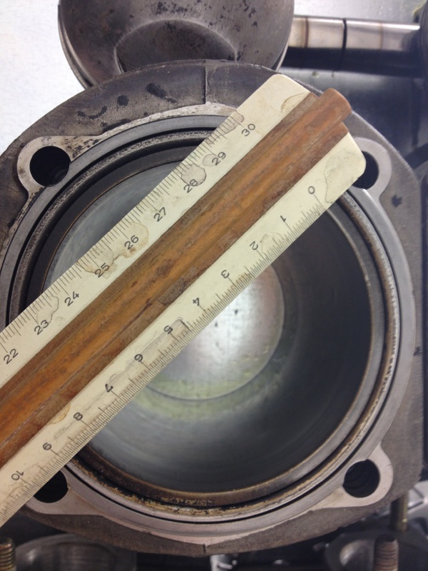

Diameter 84 mm
Total Hight 120 mm
Pistons [3 Piston Rings]
Hallmark 1: 83.95 [84 mm]
Hallmark 2: Sp 0,05
Are these the stock cylinders?

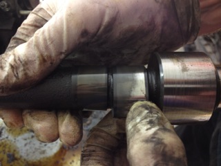

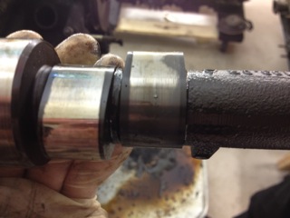

left 901.105.183.OR [965?]
right 901.105.110.1R

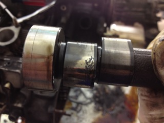

Here it gets wired. With Wayne Dempsey's great book, I think this is a S and a L cam out of two different engines. Was that something a lot of people did?
Also the wear marks on them are pretty bad: See pics

I don't know enough about flat sixes but those cams look NFG... (IMG:style_emoticons/default/barf.gif)
I'm sure there are better aftermarket cams than S, T or L.

I think Jonathan at GPR is building a 2.5. Seems to me, FAR in the past, we used a 2/2.2 crank and rods with a 2.7 bore and special pistons. Betcha if you Google it you'll get all kinds of answers. BTW, a 2.7 is a 2.4 with a larger bore. You might want to go for that ............. The lobes on those cams can be welded and reground.

the 90zn cylinders should be 90mm unless they have been sleeved.

To the cap'n: they could be rewelded, the problem though is, that they out of two different engines… an S and E/L… so they dont fit or shouldnt?!
So the Jugs are stamped 90ZN which I guess now should be 90mm bore but they messure 84mmm I guess they are sleved, so 2.7 jugs to 84mm reduced, (= with a 66mm stroke that should be 2.3 or less…)

84P8 are 2.2S pistons
Mahle for about 8yrs ? uses the 90mm casting and does the 84mm bore and they are Nikasyl coated inside, The old ones were aluminum fins with cast iron liner.Biral. Your piston and cylinder set is 4k

for a regrind or weld up.
look at the big end of the cams, grinders usually stamp the grind number on that end. no matter what the casting numbers are.

I have same cylinders as you 90ZN2, but they are as well 84mm
