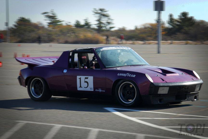

I haven't changed the springs need to confirm the actual rates on the car currently, after running the last event of the season with a good set of Hoosier R35's I believe most of my handling issues were as a result of my tires not suspension. The R35's have enough grip to the awaken the suspension. I finished 2nd overall out of 63 cars only .4 sec behind a very fast well setup 911 GT3. I was 1st in PAX (IMG:style_emoticons/default/smilie_pokal.gif)
(IMG:http://www.914world.com/bbs2/uploads_offsite/scontent-b-iad.xx.fbcdn.net-10399-1384263372.1.jpg)

Awesome. Did you get a video?

The battery in my gopro died after the first run. (IMG:style_emoticons/default/hissyfit.gif)

OMG isn't it always about the tires? (IMG:style_emoticons/default/dry.gif) (IMG:style_emoticons/default/biggrin.gif) (IMG:style_emoticons/default/beerchug.gif)
