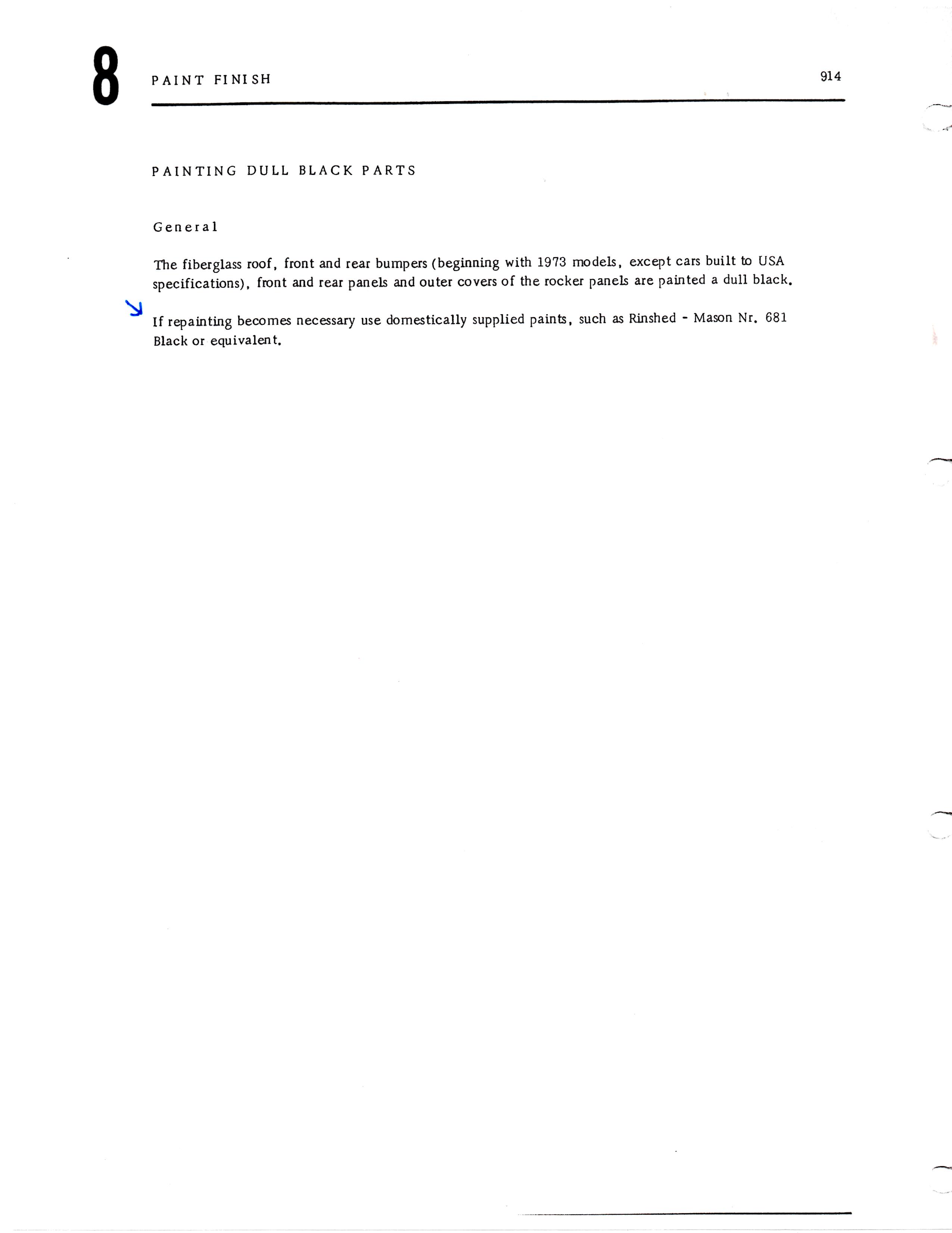

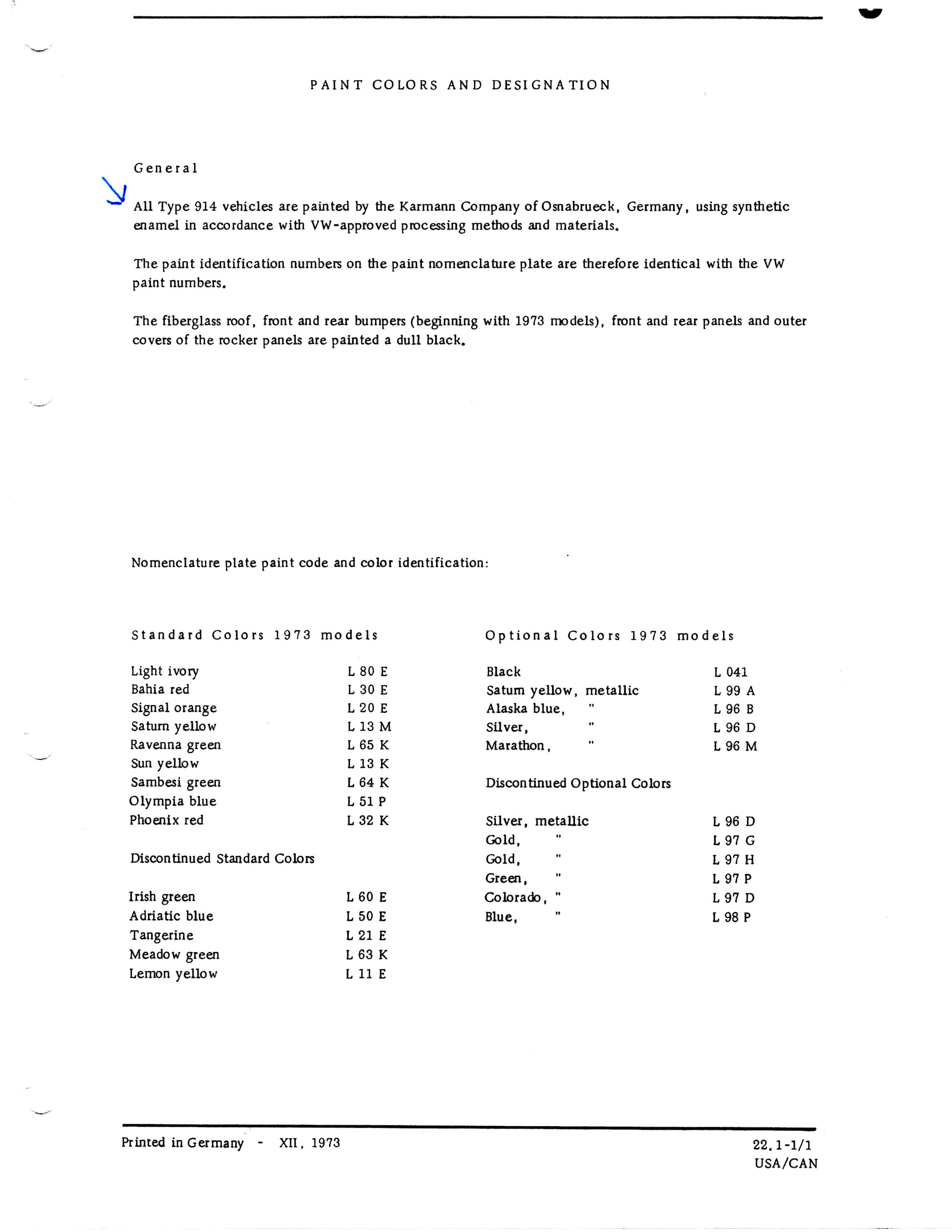

QUOTE(OmaPossu @ Sep 22 2013, 07:54 AM) *
I have asked Porsche Classic for help to have correct painting to my six. It took 3 months to have answer and it was: Please tell your 914:s VIN.
And now waiting again..
Is there a classic Volkswagen site where this primer could be found? Attached ImageAttached Image
