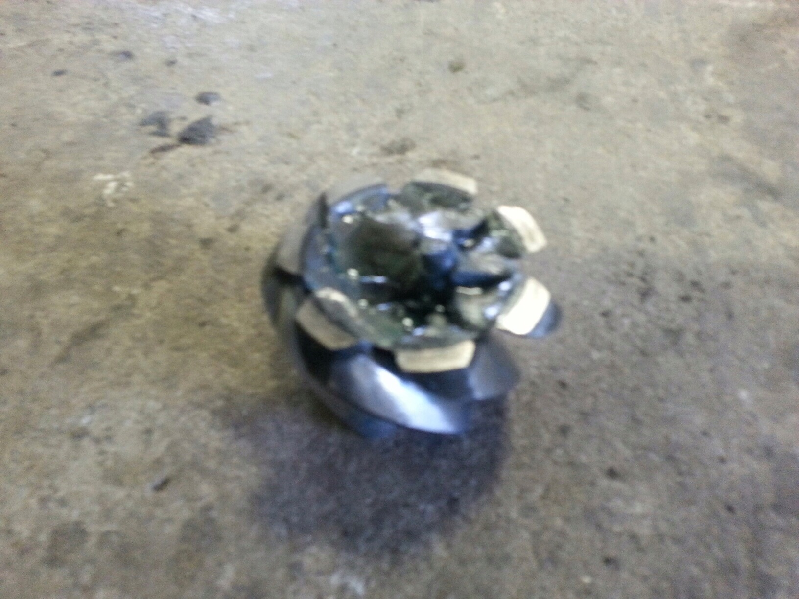

Anyone guess "Pinion Gear"?
It wasn't the CVs or clutch, and both wheels were moving independent, even when it was in gear, so I just swapped the whole trans for the one I had in my basement.
I got this pic from my friend about an hour after I left. He couldn't wait to figure it out.
I guess a 901 isn't the best option for a V8 conversion. Renegade rebuilt this Trans in 2008, about 6,000 miles ago.

A 901 is OK for a V8 if driven properly. You must ease off the clutch in second gear to get going, then you can hammer on it. BTW, don't ever use 1st gear.
If you pop the clutch with lots of gas, you will break it!. If Renegade rebuilt it, it may have a flipped H gear in 5th position. Great for a V8. Standard 5th gear is way too low.
