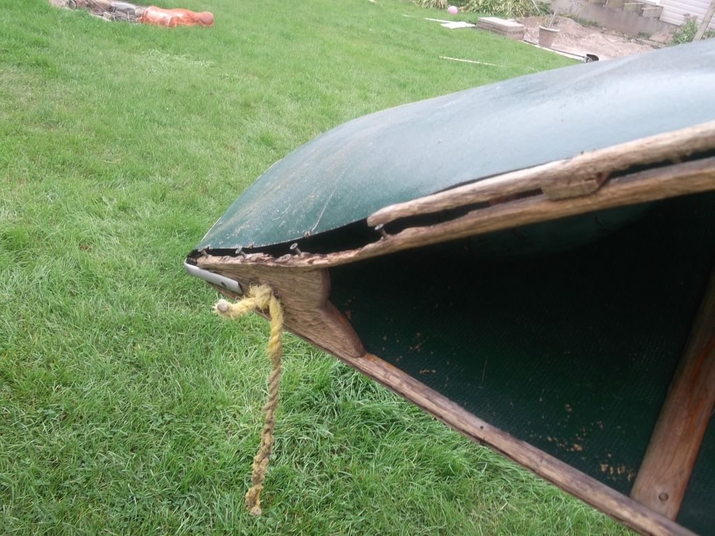

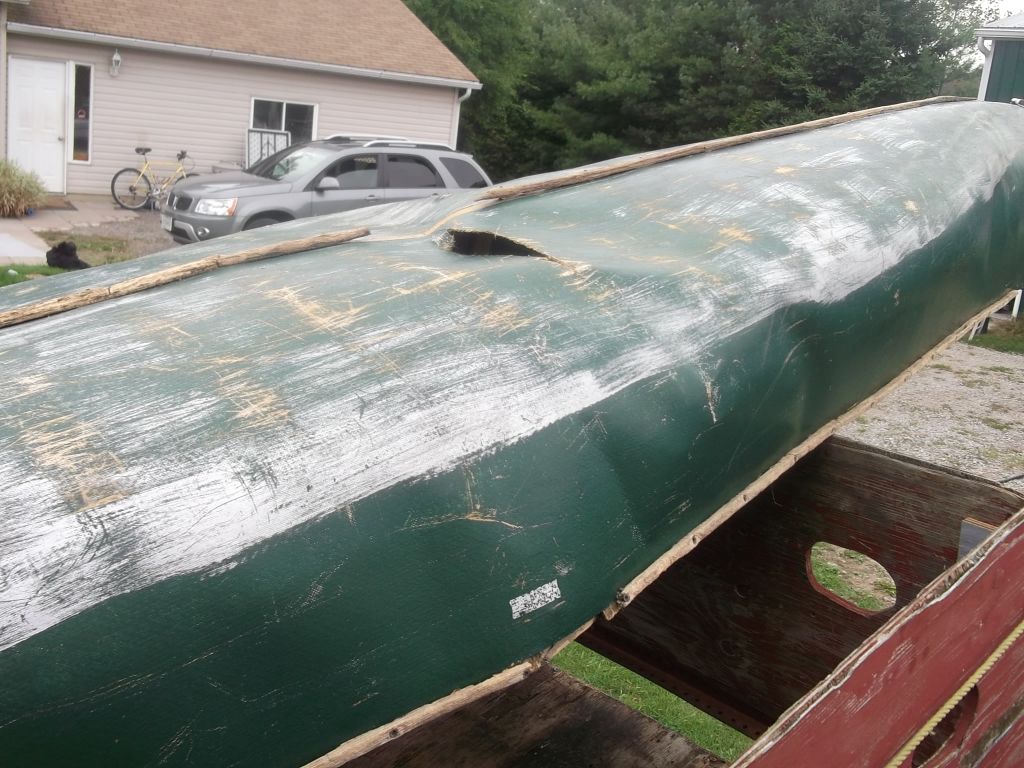

Over the winter I'd like to repair my dad's canoe. I know it looks bad, but the main skin is kevlar, the woodwork is cedar and fairly simple, plus there is enough bits to copy. I have the tools, my trade is cabinetmaking. Only thing missing to copy is the yoke, but the old one sucked anyways
The kevlar repairs will be the only thing hard-ish to do and this is where the question comes in....
Can I cut this in half and add 3 feet to the center?
It's a 15-1/2' canoe and it's looking like I need a 3 person canoe. If the wife was into it I'd get another canoe, but if it's just me and the 2 kids I'd rather have just one canoe. Most 3 person canoes are 18-19 feet.
Any tips would be welcome (IMG:style_emoticons/default/smile.gif)

Kevlar is almost like fiberglass and uses the same techniques. I would be a little concerned with the structural integrity after adding 3 feet..
That is probably a vacuum molded product. Very hard to duplicate in the garage. You could build a buck and layer it on old school style. It will not be as smooth or as thin but should work.
How concerned with looks are you?

You can vacuum mold in your garage, and it is recommended with Kevlar to get the epoxy resin into the weave. BTW, Epoxy is nasty stuff. It will take a large bag, and a good pump.
I would lay it up on the inside then bridge the gap. Add structure to tie it all together, then spray new gel coat on the outside. Then spray wax on the outsdie of the gel coat. The wax will actually protect it and allow it to cure properly. You can then buff it out.
If you skip the wax, it will not cure for almost the entire season. Did a jetski once, and learned th hard way. (IMG:style_emoticons/default/headbang.gif) Once it has cure you can buff it to a super gloss shine.
Option #2 is use the existing shell as a form, wax the shell and make it your plug. You could then make it out of carbon fiber use a clear gel coat, and have a ricer canoe. Just need a few stickers, and a fart can.

I know it looks bad but the woodwork is the easy part, all pretty simple stuff. I would have to make forms for the ribs and a steam box for the bending, but it's not as hard as one may think. The material cost to repair the holes and wood (without the extension) would be only be a couple hundred dollars and 4-5 Sundays. I have most of the wood needed, just what ever the epoxy costs.
QUOTE(kg6dxn @ Sep 20 2013, 05:10 PM) *
I only care about function and that it's light. This canoe weighed 48 lbs. when new. The ribs give it the structure, the broken ribs why it looks so warped.

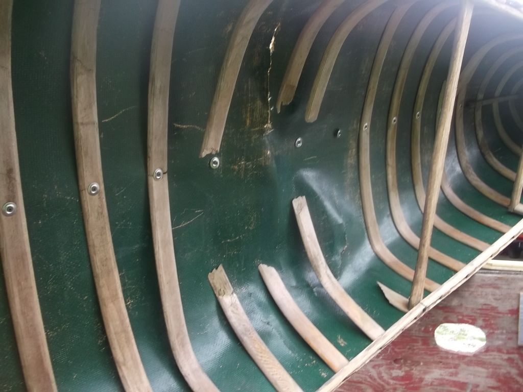

Rebuild it. Don't Frankenstein it and add to the middle. I don't think that would be safe.
This boat will be carrying everything you need to survive as well as your family.
Eastern cedar over western for strength and fibre length on your ribs.
PVC tubing can make a quick steam box.
I have done lots of fiberglass repairs. Never Kevlar.

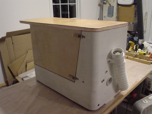

Disagree with prior post. Epoxy is easy to work with, just make sure you use correct resin/hardener ratio, easy to do using WEST system pumps as they give correct mix.
Epoxy is stronger than polyesther and makes a stronger bond.
Kevlar is very hard to cut, I went thru several pairs of shears before finding one that would cut the stuff. Using kevlar is not necessary, you could use fiberglass or carbon cloth for the extension, just have to use a bit more thickness with the glass. It might be a good idea to incorporate a foam or balsa core in the new area, this will make the structure much stiffer than a single skin of either kevlar or glass. hardest part will be to make a form to get the proper shape. Suggest laying visiqueen plastic sheet over a good section of present hull and then lay-up new outer skin over this. it won't stick to the plastic and will be a good match to the form needed. then support it somehow and add more glass, carbon, or kevlar to the inside to get the thickness you want. Fair it into the old hull in at least a 12:1 ratio.
Forget gelcoat as it doesn't adhere well to epoxy, To get a smooth outer surface, using WEST lightweight 410 filler mixed into epoxy and trowel thin layer over skin using wide drywall spreader. This stuff will sand easily to get finish you want.
here's sample of epoxy/glass over foam core engine box i did for sailboat project

We built them high school with a mold, but no vacuum.
You will need to make a mold to get the middle shape correct, but it should work.
You will need to make a female mold, then lay the canoe right side up into the mold.
So the mold might be 5 or 6 feet long to help you line it up.
Use plywood bucks, and 1/4 inch plywood screwed into the bucks.
Then sand that, and lay two coats of fiberglass on the inside of that mold.
Sand, fill, paint with epoxy paint, but and wax that mold.
Then you lay everything together and mold you fiberglass on the inside while overlapping into both halves.
Let it set, and put your new gunnels in place, then relapse from the mold.
Then flip it over and finish the other side with new Kevlar to make the bottom smooth.

QUOTE(barefoot @ Sep 21 2013, 09:48 AM) *
barefoot
Excellent info barefoot
I have a local source for kevlar and west system products. Price doesn't seem too bad.
The finish on the canoe is not regular mold and gelcoat smooth, in fact I think it's just painted. If I power wash it hard (3000psi from 2-3 inches) I can blow off the paint/gelcoat...whatever it is, down to the gold colour kevlar. The kevlar may be just a single ply, it's only .055 thick.

QUOTE(balljoint @ Sep 21 2013, 09:42 AM) *
I have lots of local cedar. The PVC pipe steam box is a good idea! And I just need a kettle for the steam.

Wallpaper steamer rented does a great job.
