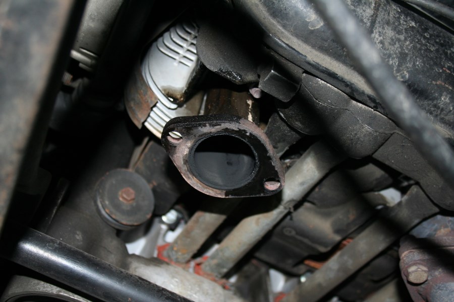

Could this leak be coming from a crack in the head at the valve guide?

Elliot Cannon   OK, I'm pretty sure the inside of the exhaust ...   Sep 25 2013, 02:19 PM
Dave_Darling   :( I'd agree; time to pull that head and have...   Sep 25 2013, 02:43 PM
r_towle   could be headwork, could be junk rings. Pull it, ...   Sep 25 2013, 03:03 PM

euro911   I would go through both heads. It will help to ass...   Sep 27 2013, 01:37 AM
SLITS   Most engines that use guides, the guide for the va...   Sep 27 2013, 06:28 AM
bulitt   Slits has it. The guide has moved in the head. Eit...   Sep 27 2013, 06:45 AM
rhodyguy   remove, straighten, and 'pretty up' the en...   Sep 27 2013, 07:14 AM
lsintampa   IDK, If the valve guide were leaking, it would s...   Sep 27 2013, 10:26 AM
stugray   If the valve guide is loose and leaking, that wi...   Sep 27 2013, 11:04 AM
914_teener   I am with Mark......, Elliot.... I'd do both ...   Sep 27 2013, 12:04 PM
Elliot Cannon   I am with Mark......, Elliot.... I'd do both...   Sep 27 2013, 12:18 PM
SLITS   You two should get a room. Can I pick on you now ...   Sep 27 2013, 01:31 PM
Elliot Cannon   You two should get a room. Can I pick on you now...   Sep 27 2013, 07:02 PM
r_towle   It looks like it moved. I would re-ring it, but th...   Sep 27 2013, 02:01 PM

Elliot Cannon   I finally got the head off. These are cylinders ...   Sep 30 2013, 05:00 PM
Elliot Cannon   The cylinder walls look pretty good to me. I can...   Sep 30 2013, 05:02 PM
Elliot Cannon   I pulled out one of the ceramic valve lifters. Af...   Sep 30 2013, 05:05 PM
Elliot Cannon   I'll be pulling the other head off soon and fi...   Sep 30 2013, 05:10 PM
StratPlayer   Elliot are those 94 or 96mm pistons?   Sep 30 2013, 06:59 PM
Elliot Cannon   Elliot are those 94 or 96mm pistons? 96 pistons ...   Sep 30 2013, 09:20 PM
SLITS   Not much wear .... you can still see the cross hat...   Sep 30 2013, 08:01 PM
r_towle   Can you see the valve guide on the vale in questio...   Sep 30 2013, 09:23 PM
Elliot Cannon   It has dual springs and I can't see anything.   Sep 30 2013, 09:25 PM
