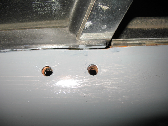

I need advice. The PO replaced the stock mirrors with Talbot racing mirrors and I want to reinstall the stock mirrors. The problem is that he drilled through the stock backing nuts in the doors to get the mounting u-bolt in! (IMG:style_emoticons/default/headbang.gif)
What would be the best way to re-mount the stock mirrors?

You may have to shop for longer stainless fasteners, remove the vent window and install the mirror with nuts on the backside.
The vent window isn't hard to remove. Pull the trim card. there are two bolts through the door below the vent or corner window. Then remove the nut holding the vent window adjuster at the bottom of the door. Then remove the vent window adjuster from the bottom of the forward glass guide attached to the corner window. This will allow you to pull the corner window up and out of the door. You will then have a fairly clear access to the bottom of the mirror support.

Depending on the size of the drilled holes, you could also try to get some Rivnuts to put into the holes and then have new threads to use.

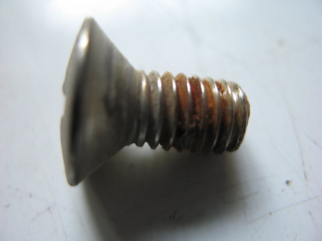

jimkelly
post Oct 4 2013, 07:44 AM
Delaware USA
Posts: 4,969
Joined: 5-August 04
From: Delaware, USA
Member No.: 2,460
pic of stock bolt
GaroldShaffer
post Oct 4 2013, 08:16 AM
You bought another 914?
Posts: 7,631
Joined: 27-June 03
From: Portage, IN
Member No.: 865
The stock bolt is the same as the ones used to hold the door striker plate in the door jamb.

I don't currently have the stock mirror screws. Does anyone happen to know the diameter and thread count on those screws?

Use cage nuts like shown in the pic.

QUOTE(e_artiles @ Oct 5 2013, 12:35 AM) *
How do the cage nuts work? Do they hold on to the sheet metal?
it works like an anchor bolt. Be placed in the hole from outside, becomes fixed while you tighten the bolt. No need to remove door panel.

QUOTE(e_artiles @ Oct 4 2013, 08:30 AM) *
M6 x1.0 is the OEM screw threading
