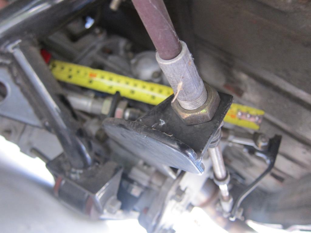

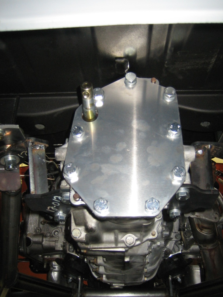

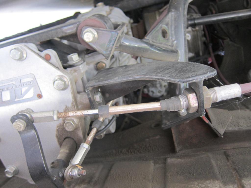

I can't find the thread now, but I promised some photos of my Subaru cable linkage, with a rule for dimensions. Seem to be several projects getting to this point, so hopefully it will be helpful. I wrenched my back so it's been slow, sorry, but here are a few.
General layout. The cable going through the center of the photo is anchored on the left at the sheath to the main bracket, then connects to the shift rod bracket on the right, attached to the shift rod coming out of the transmission. That cable is the shift rod in and out. The rotational cable connects to the bottom of that same shift rod bracket, on the right. The main bracket is the important piece, it locates all the cable sheath anchors. This is the best view of the reinforcing gusset that keeps everything stiff.
(IMG:http://www.914world.com/bbs2/uploads_offsite/i379.photobucket.com-2618-1381090895.1.jpg)

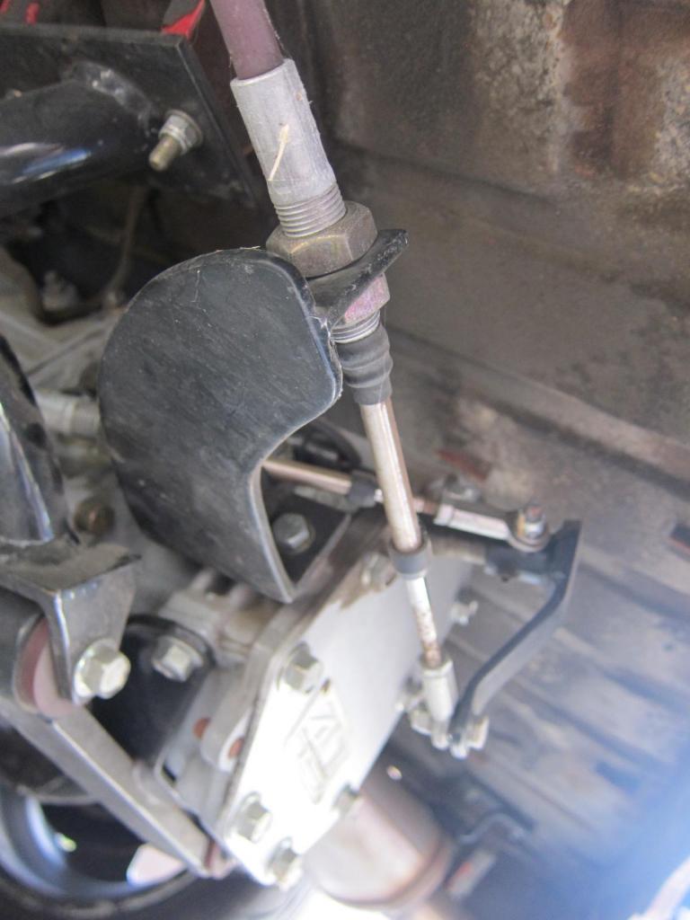

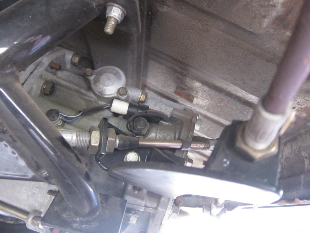

Same view from below and a little further back so you an see the cable sheath mount for the rotational cable.
(IMG:http://www.914world.com/bbs2/uploads_offsite/i379.photobucket.com-2618-1381090895.2.jpg)

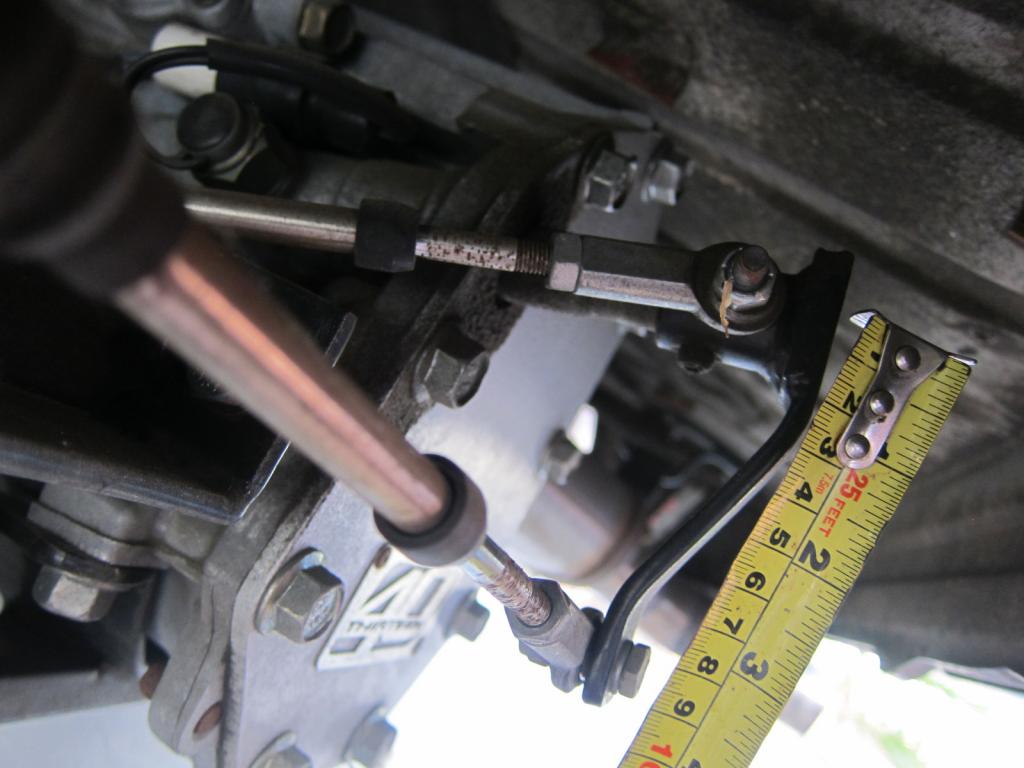

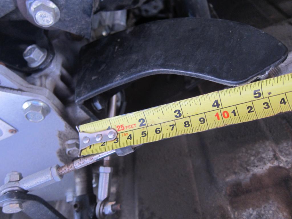

Same direction of view, but a little around the main bracket so you can see the shift rod bracket. That's the important dimension for full throw of the MR2 shifter, 8.5cm from the center of the shift rod to the cable heim center.
(IMG:http://www.914world.com/bbs2/uploads_offsite/i379.photobucket.com-2618-1381090895.3.jpg)

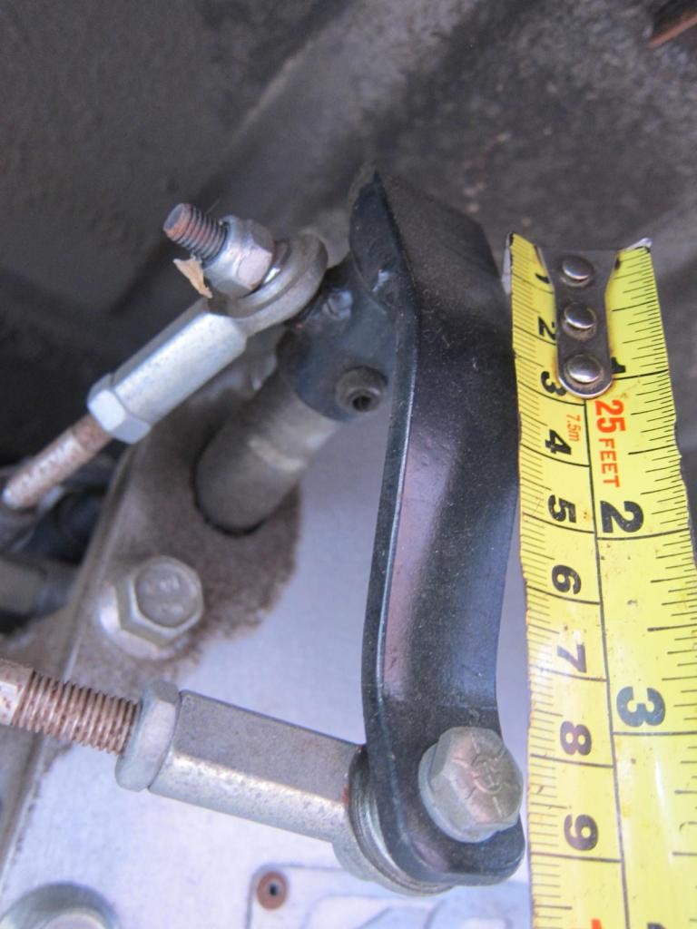

Another, that same bracket and dimension. This is the best view of now that bracket attached to the transmission shift rod:
(IMG:http://www.914world.com/bbs2/uploads_offsite/i379.photobucket.com-2618-1381090895.4.jpg)
Same components, different view. The main bracket curves out from the transmission mount to put the sheath attachment point out in the same plane as the shift rod. In the photos above you can see the shift rod bracket is bent in toward the rear of the transmission to keep that cable movement in the same plane. You can also see more of the main bracket gusset (that triangular shape). Need that gusset to keep it all stiff, minimize cable shifter "mush".
(IMG:http://www.914world.com/bbs2/uploads_offsite/i379.photobucket.com-2618-1381090895.5.jpg)

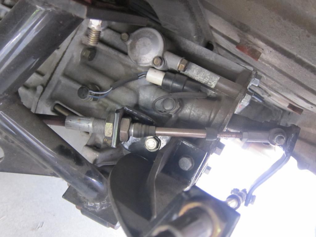

Different view, same stuff.
(IMG:http://www.914world.com/bbs2/uploads_offsite/i379.photobucket.com-2618-1381090895.6.jpg)

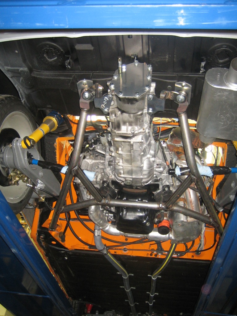

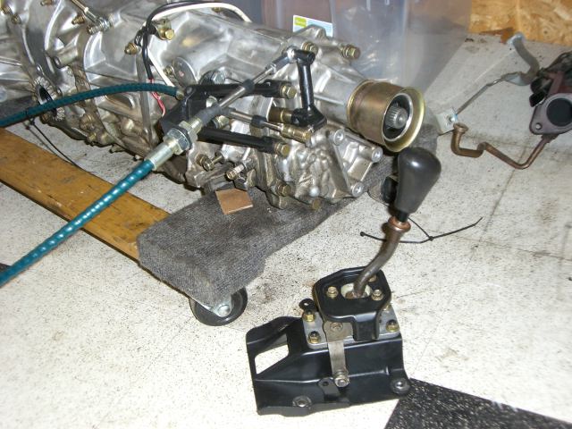

Layout (during the build) of the modified MR2 shifter inside the car. That verticall piece of flat stock between the cables from the shifter to the sheath mounting tabs makes the whole thing stiffer, eliminating a lot of the movement and making the feel a lot more precise. Note that there are adjustments everywhere in the system, every cable end. There's also a video of the shifter working in my build thread, ink in the sig, below.

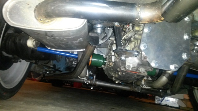

two other pics I like of db's car are these. knowing the pns for the cables and where they were ordered from, would be gold.
(IMG:http://www.914world.com/bbs2/uploads_offsite/i379.photobucket.com-2618-1268145998.7.jpg)
(IMG:http://www.914world.com/bbs2/uploads_offsite/i255.photobucket.com-2618-1269179837.11.jpg)

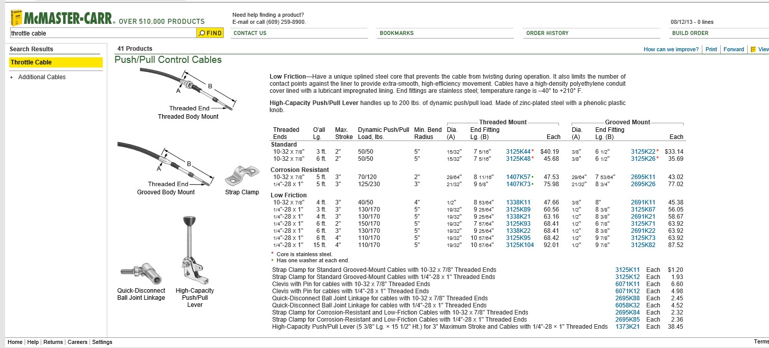

Heres where I got my cables from control cables
When I measured for them I used ploy tubing to get the correct length.
Bob

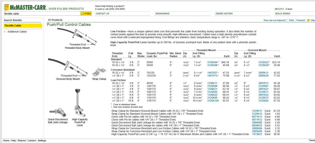

Member No.: 1,659
If you are looking for a second source we get Morse (push-pull) cables for our race cars from Midwest Controls.
http://www.midwestcontrol.com/part_family.php?id=3
