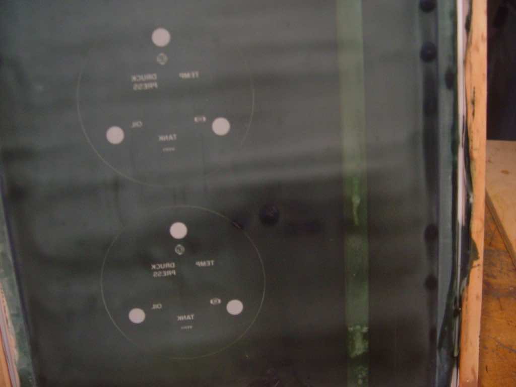

I tried two exposures with the inexpensive silk screen kit to make the stencils. Had I tried this first I would have stopped, cause they aren't horrible. But they are all a bit off. The high exposure leaves things out and the lower exposure of the emulsion made everything too blocky. I might in time get it, but it would be hard.
This is a screen emulsion after exposure and wash. I was psyched at this stage. If it was for a T-shirt it would be great.

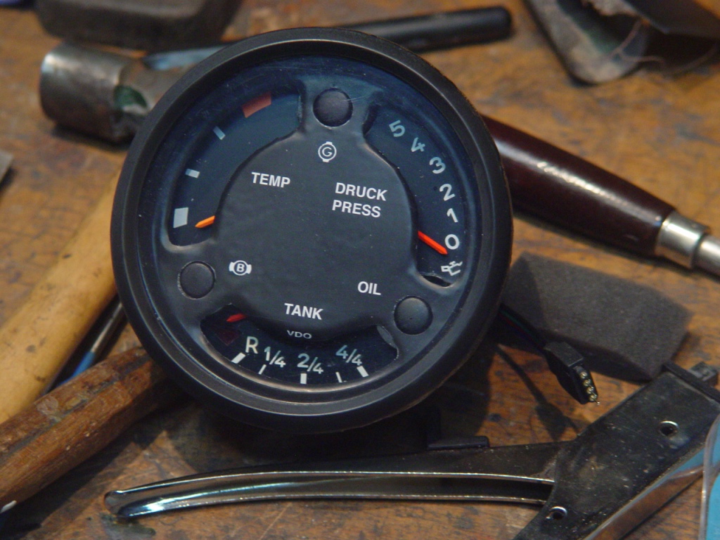

I went back to the press-on vinyl with some mods in technique.
So what do you think about this:
If it doesn't fall apart on it's own, it is what will go into the car.

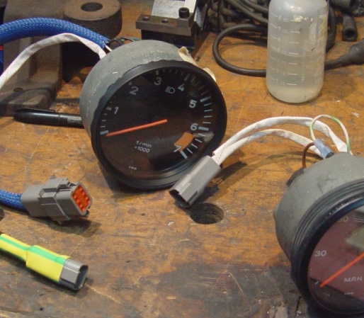

I also decided to follow Andy's method and simplify the wiring. Especially as the LED runs 4 wires for the colors.
Deutsch connectors from Jegs/ebay.

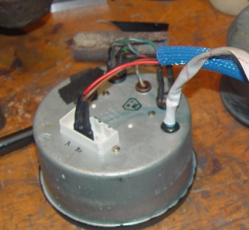

So the back looks like this. It says 11/85 and is from I think the donor car for the 3.2. However there are only 3 spade connectors for the tach part. I think that is all I need: power, ground, and signal.
If you have any insight into wiring the tach to the DME I would welcome it.
Also, I have had enough for awhile. I want to hear the motor crank more than have a cute gauge. Do you think it is good enough as a stopping point? I will be back at it as the snow closes us in, but for now.
