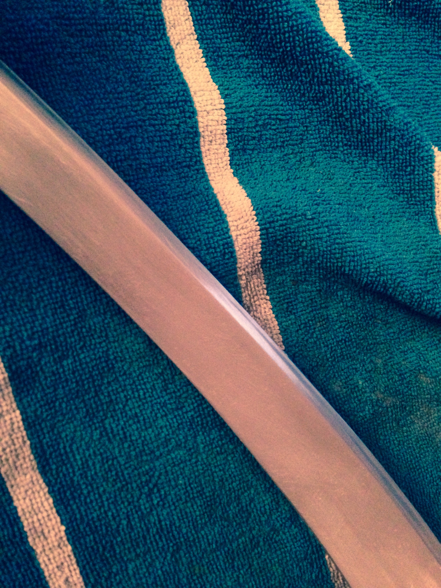

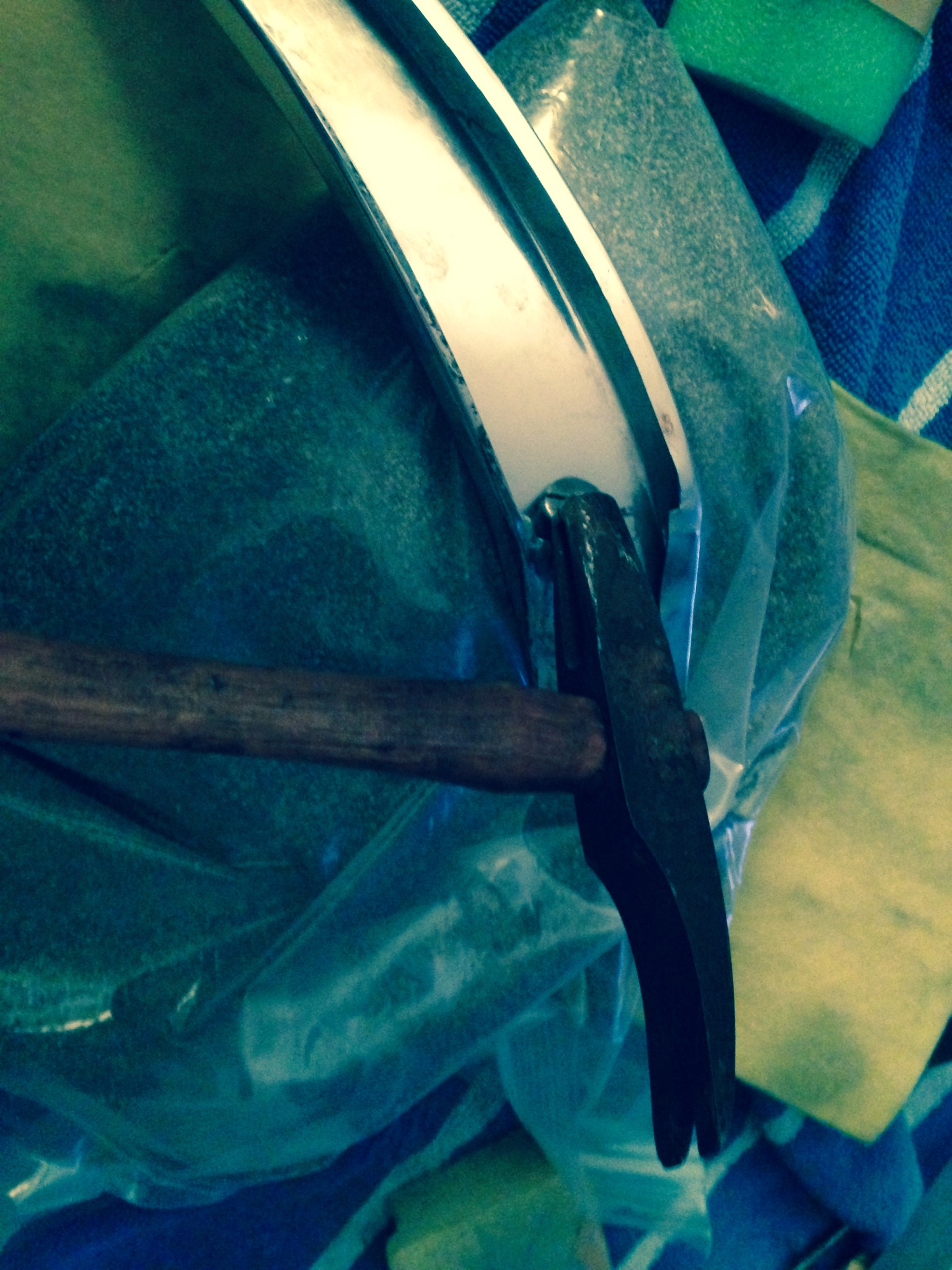

I decided I might as well fix the trim that came with my car because I wasn't going to be able to afford a set that looked like new. First i used a baggie of sand and a small hammer to straighten it and press out the dents

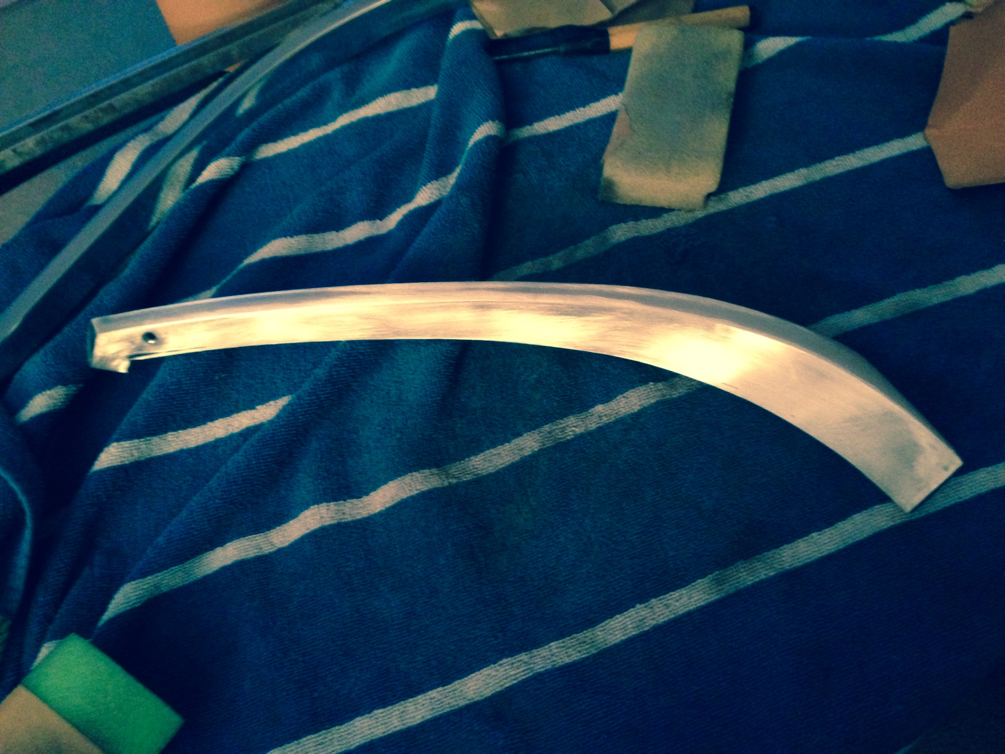

Then I got out the sand paper and took off the finish while sanding down the high spots
Finished product is still a little rough, but the basic shape is correct now.

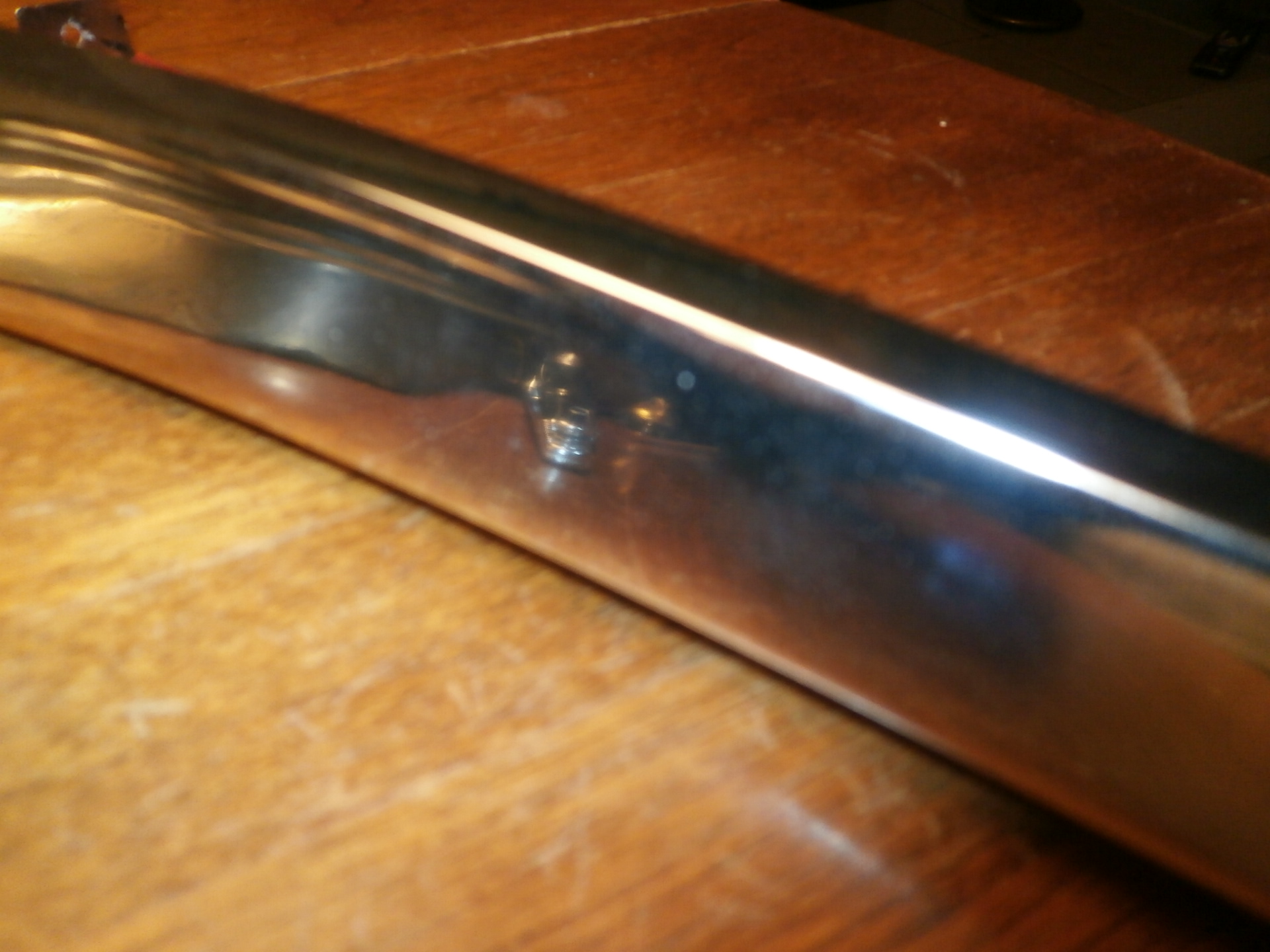

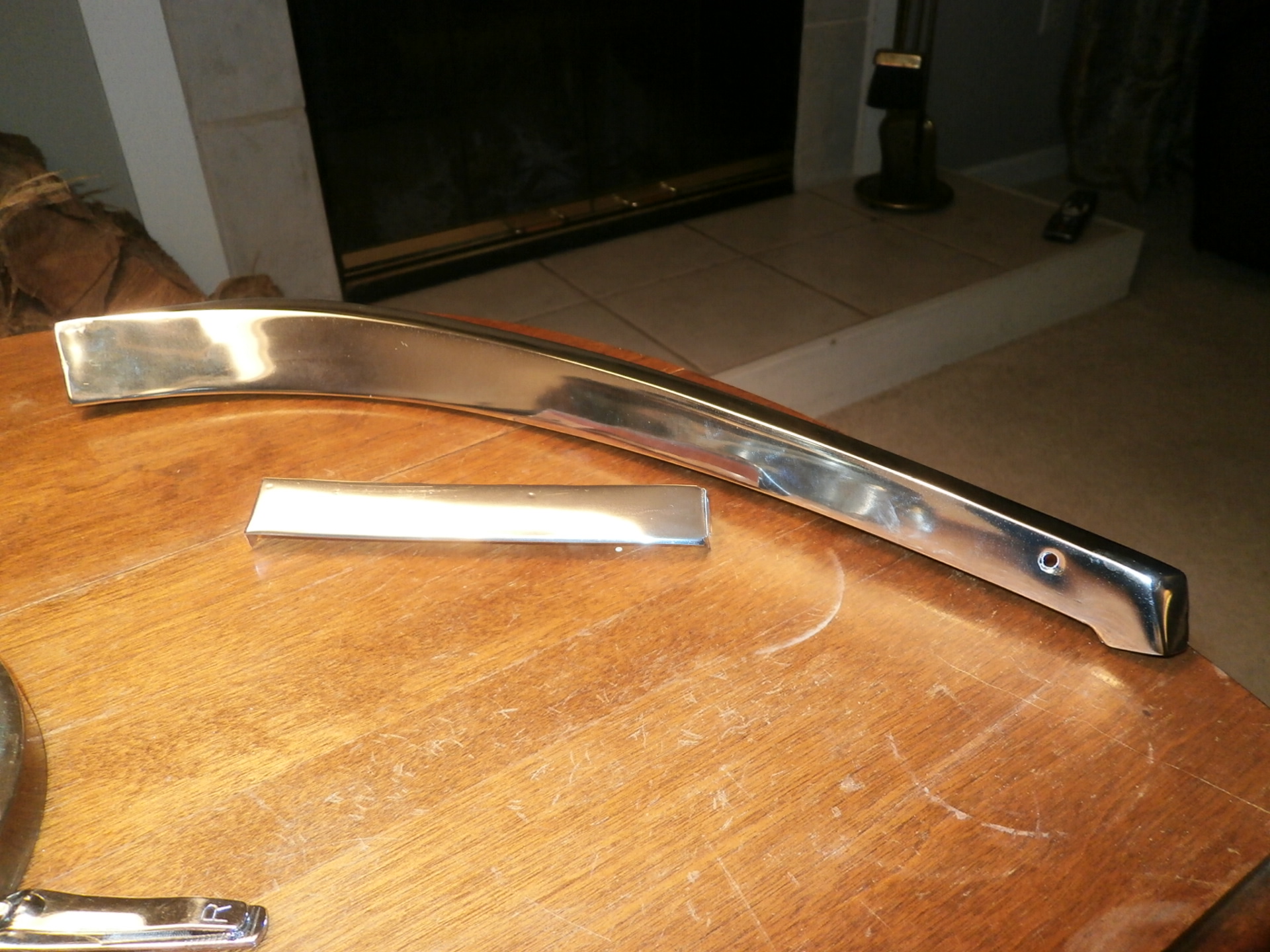

Got a call on Friday and the parts are complete and being shipped back. Cost including shipping back was $240. Sounds reasonable for the three parts if they look original
PanelBilly
post Oct 30 2014, 09:27 PM
Posts: 5,955
Joined: 23-July 06
From: Kent, Wa
Member No.: 6,488
The trim arrive today. Not as good as a new set, but the finish is pretty good. The coating doesn't cover up and of the minor defects in the metal and the metal was too thin to sand anymore.
