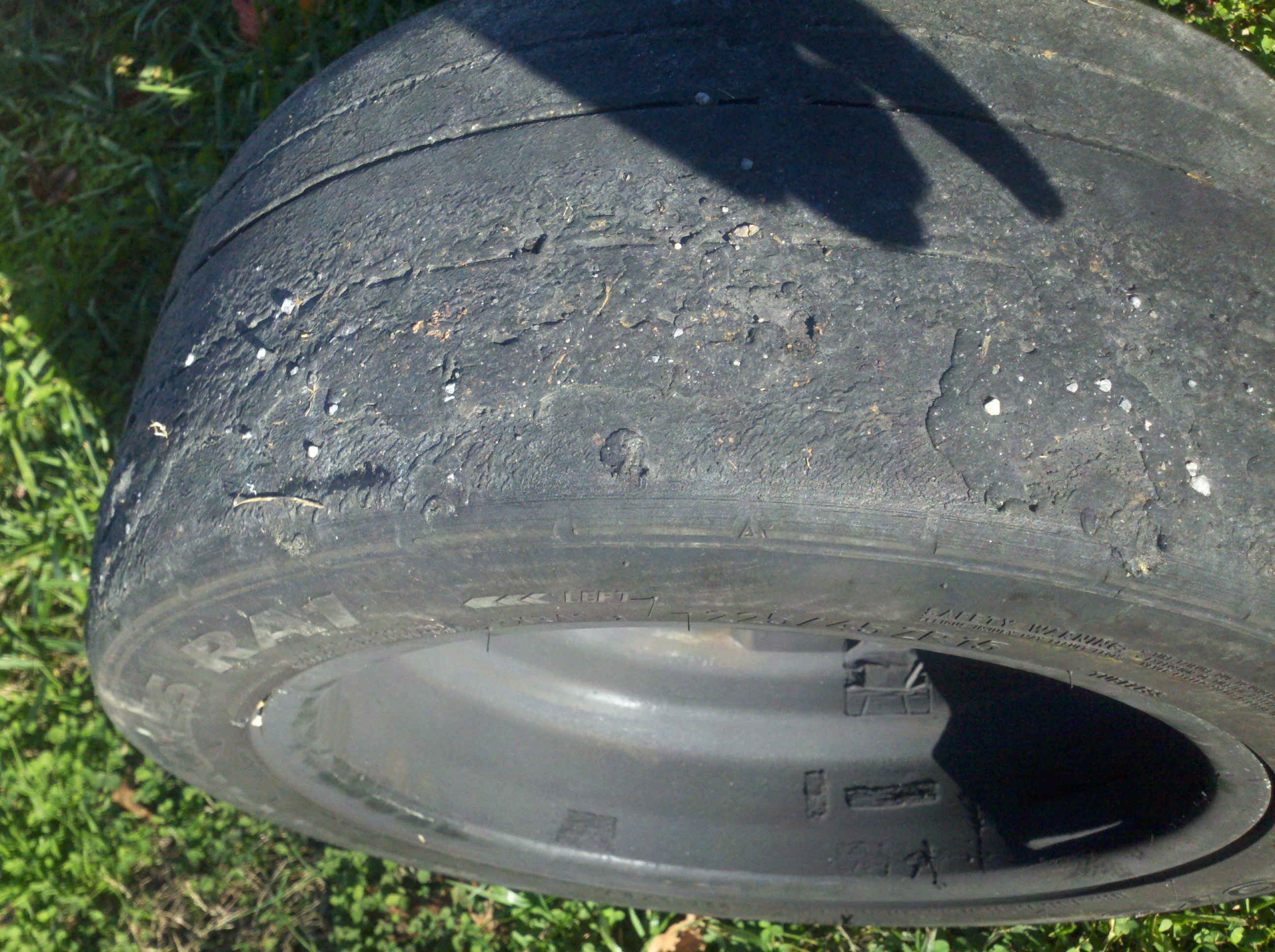

Check out the pattern of the rubber on my RA1's. I did DE's at VIR, Watkins Glen and Summit point since flipping them mid season, so have about 400 miles on track, 15 heat cycles since flipping. These are the fronts....the rears are much more uniform without a buildup of "worms". The buildup is on the inside edges. I'm guessing that it's indicating that I need more camber but I'm maxed out already. Ideas?
BTW, total mileage on track with these tires since new in March is about 1700 with 61 heat cycles & no sign of cording anywhere yet.
