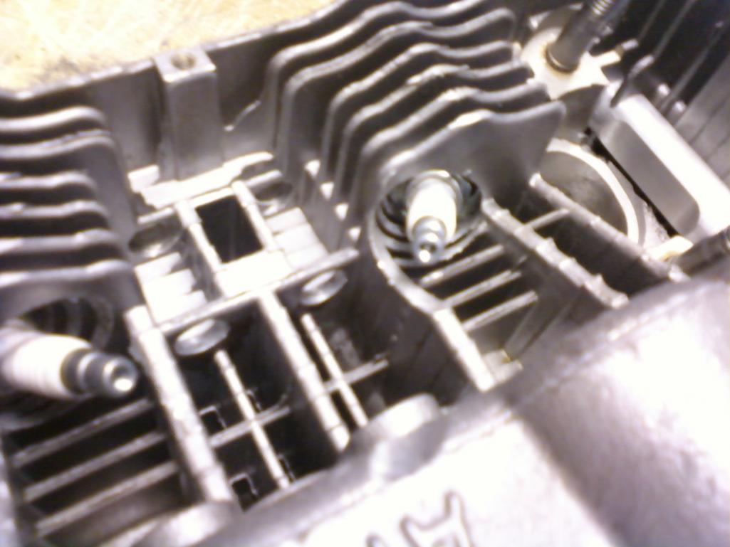

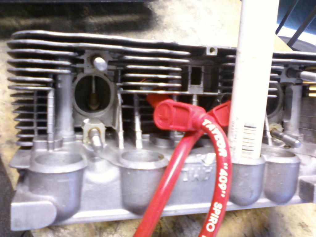

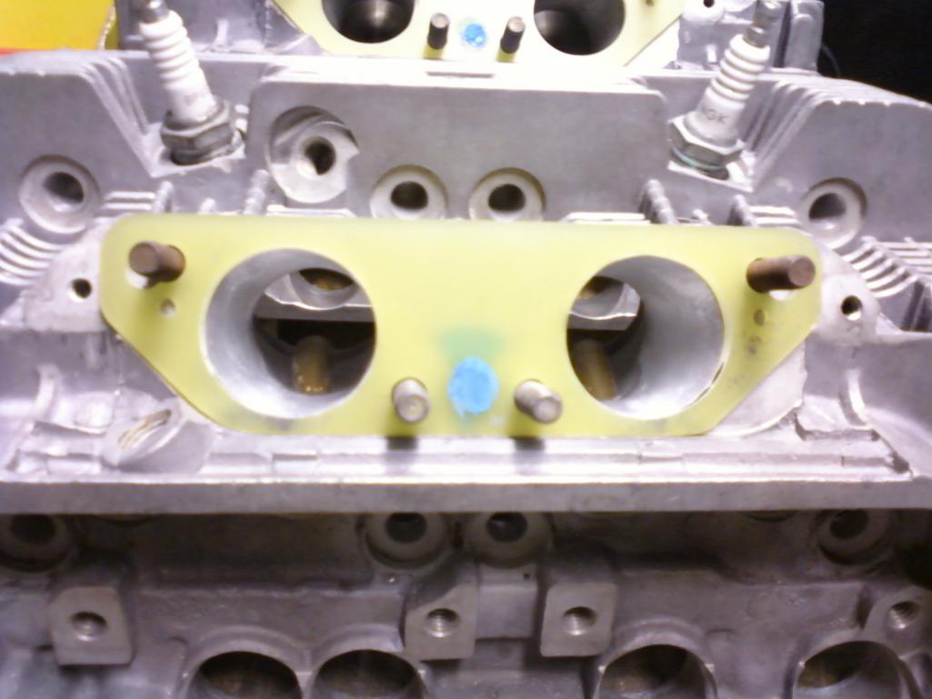

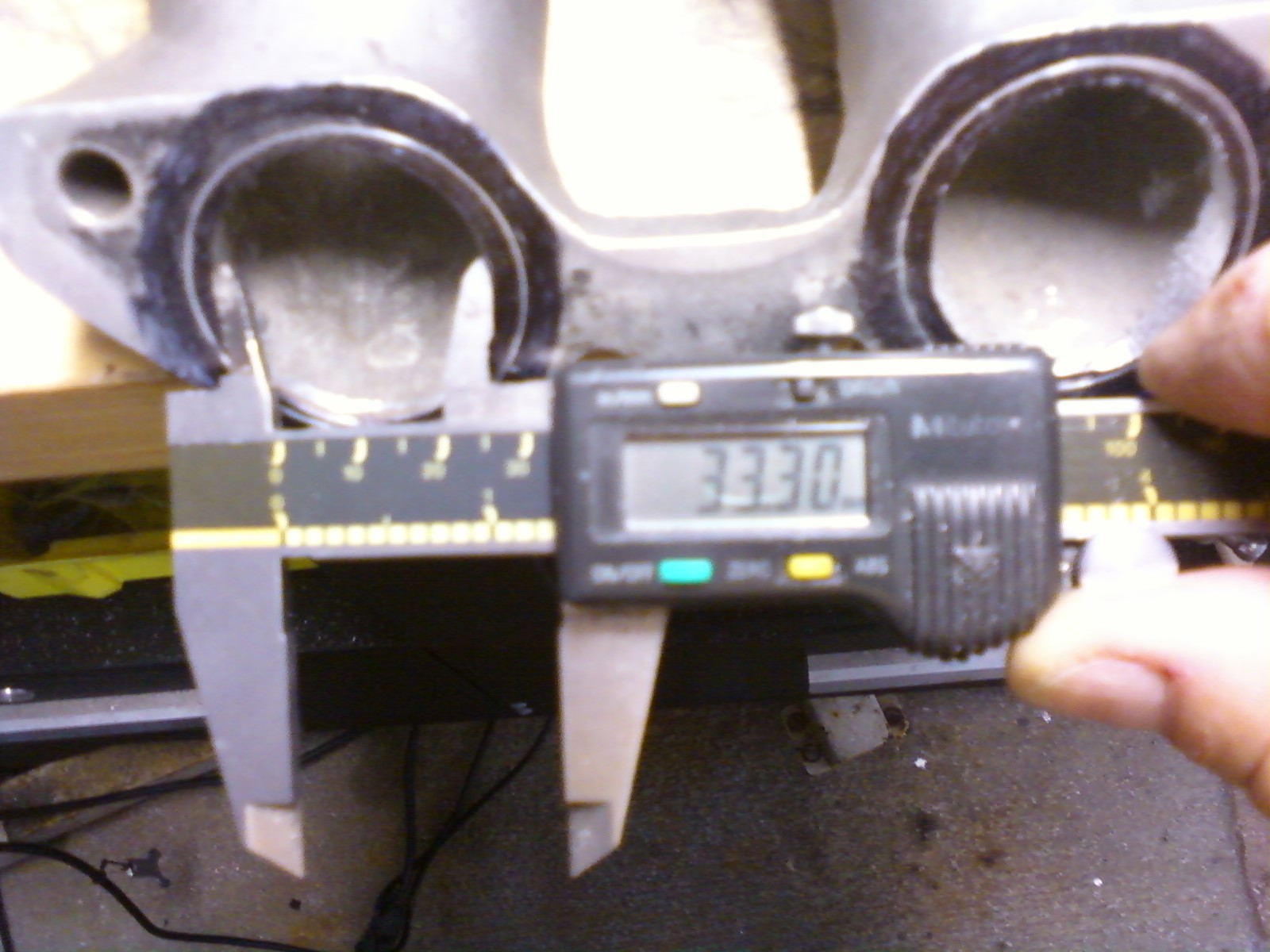

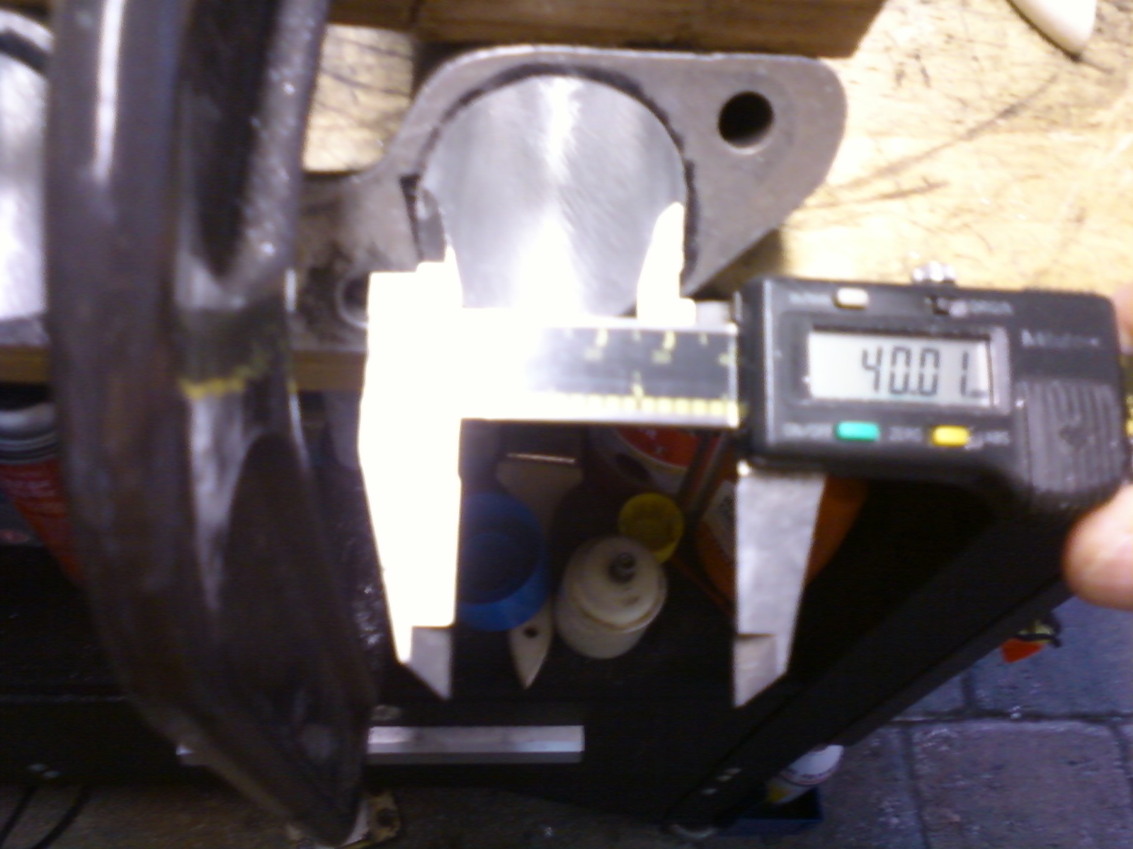

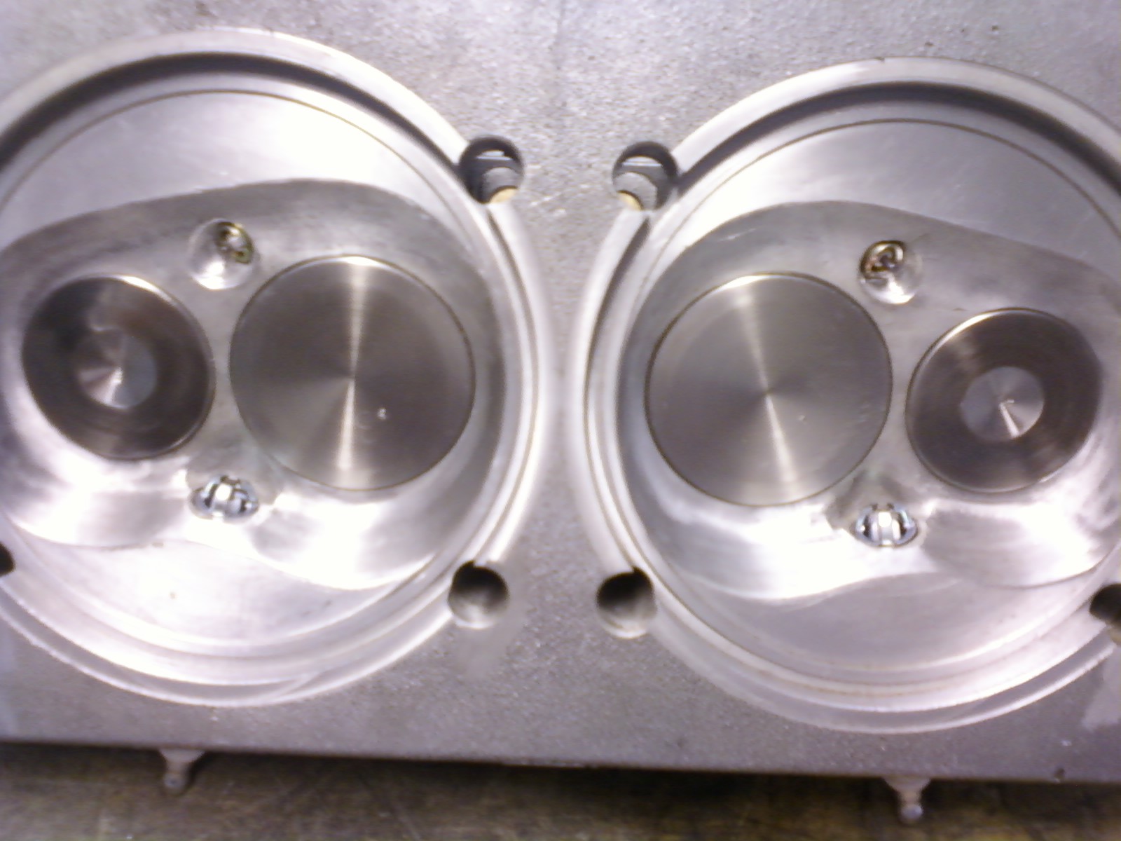

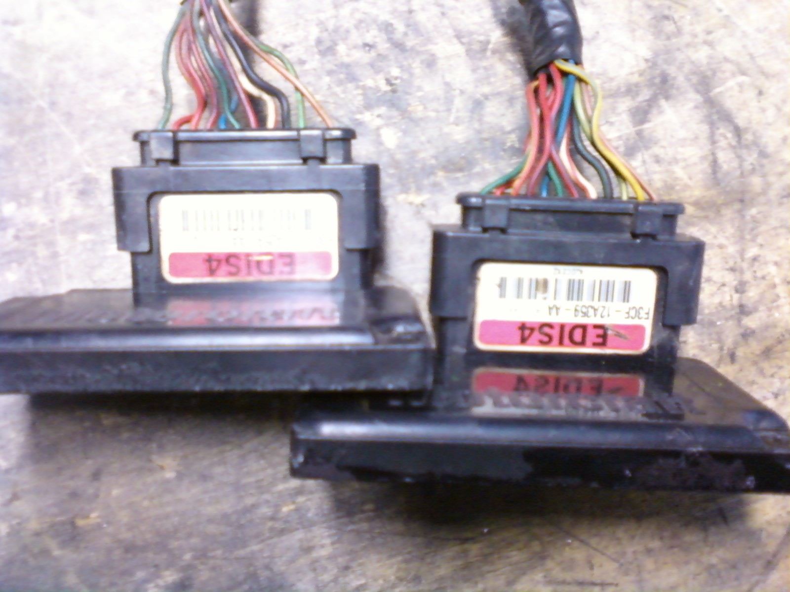

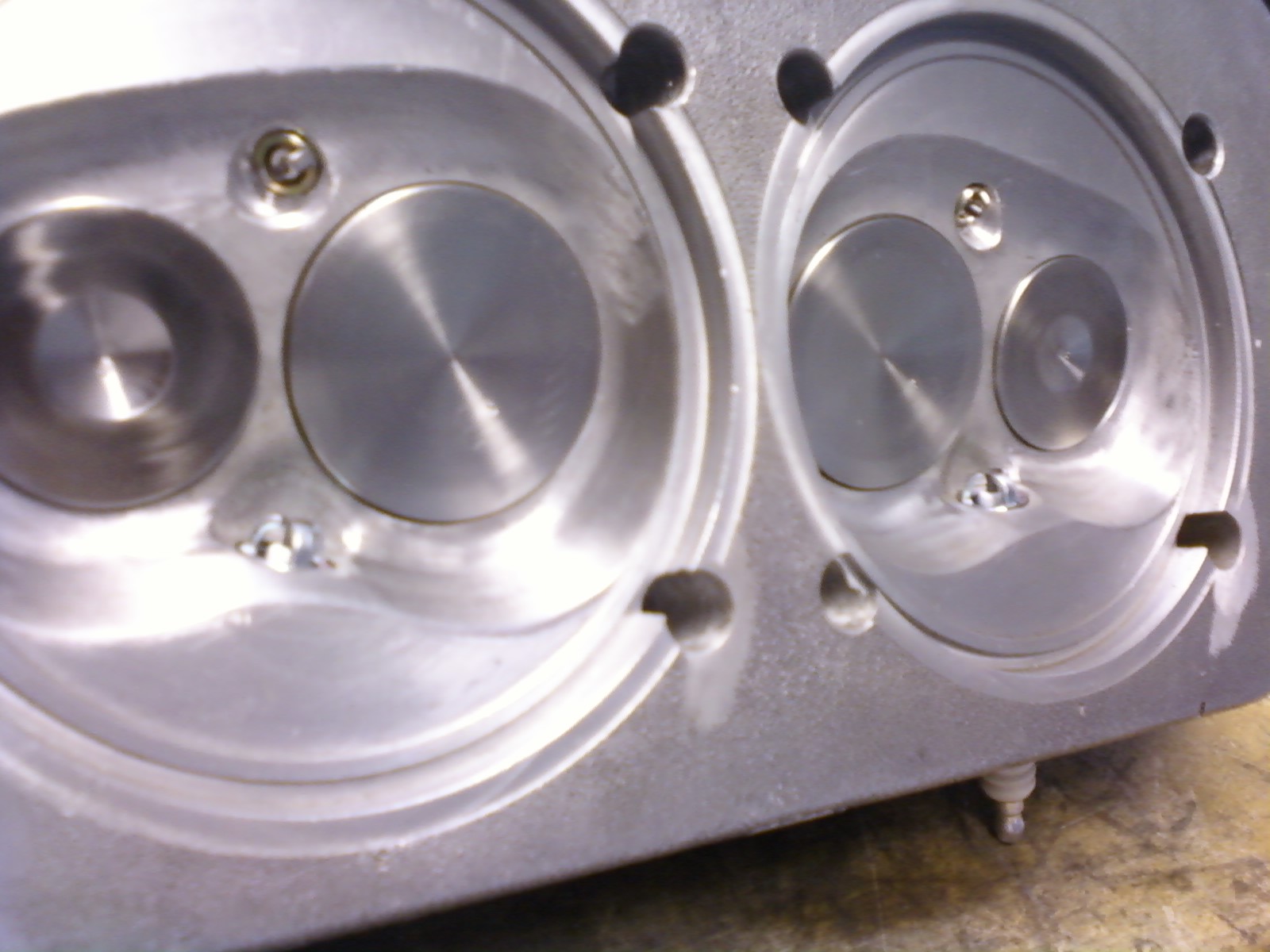

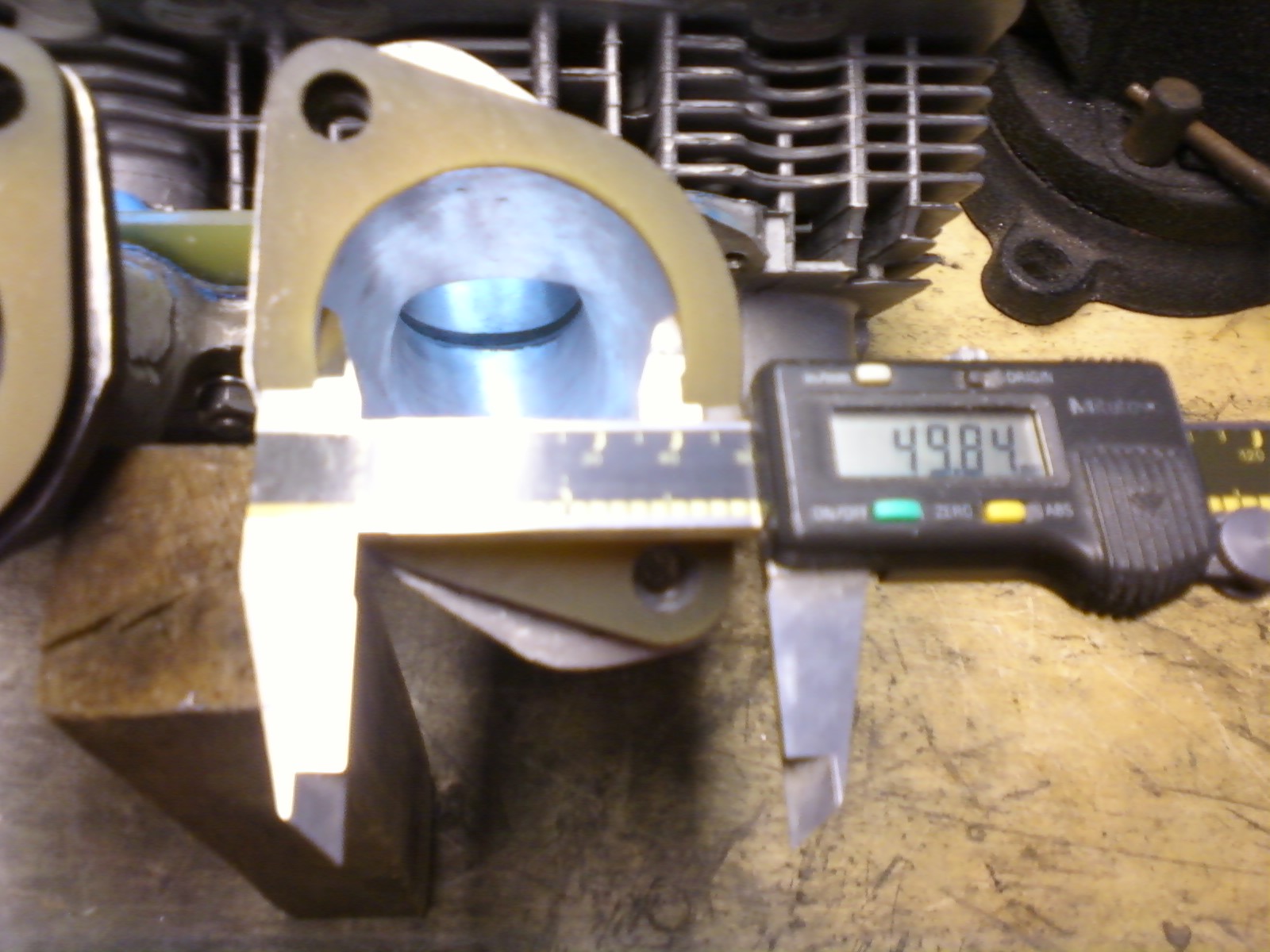

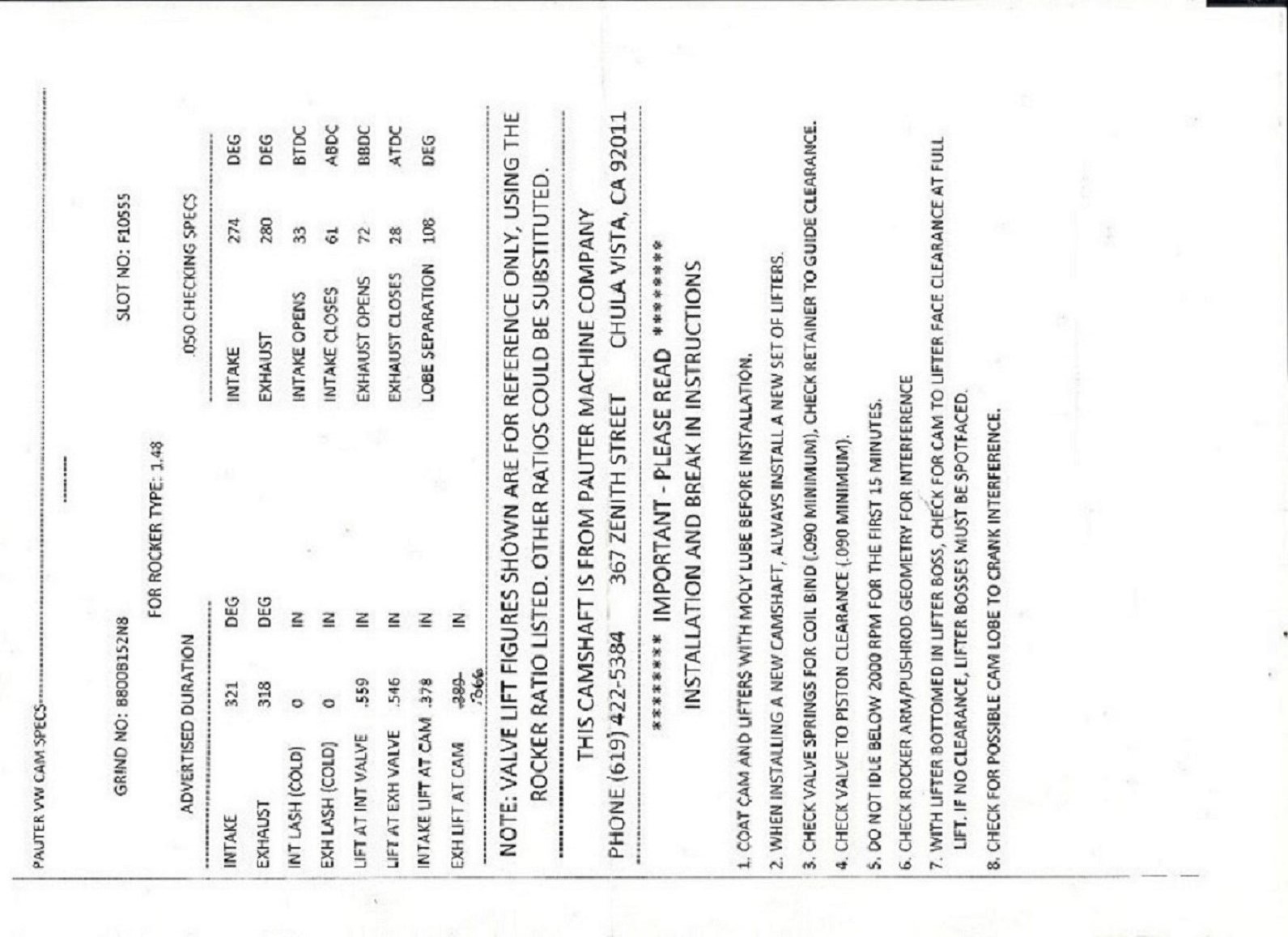

Here's a few pic's of my planned conversion to twin plug with a Pauter cam (IMG:style_emoticons/default/smile.gif) , &
either MSII or MegaJolt with edis4 x 2 for ignition, Bill D.
