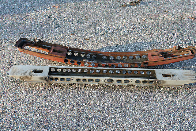

While there are a few of us who like the looks of the late bumper (myself included, depending on the color of the car), there is one really good reason to go with early bumpers – weight. I have seen many figures thrown about, so I decided to weigh them both, including all mounting hardware, fog lights, grills, etc. I was quite surprised at just how much heavier the later bumpers are.
Front:
Early – 20 pounds, included pad, dog bones, lights, grills, and hardware
Late – 46 pounds, including the shocks, and hardware (non fog light bumper)
Rear:
Early – 18 pounds, including pad, dog bones and hardware
Late – 50 pounds, including the shocks, and hardware
38 pounds vs. 96 – 58 pounds, or roughly 3% of the entire weight of the car removed from the two places you would most want to lose it!
