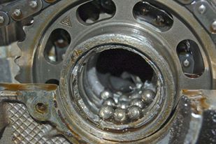

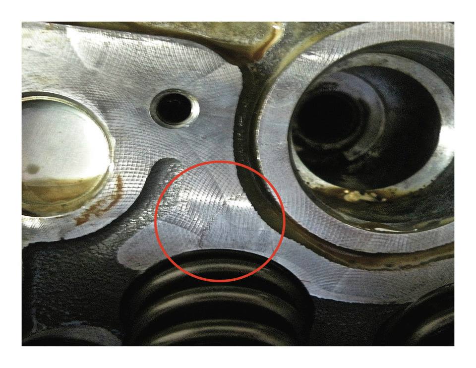

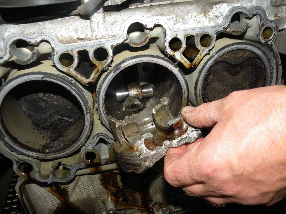

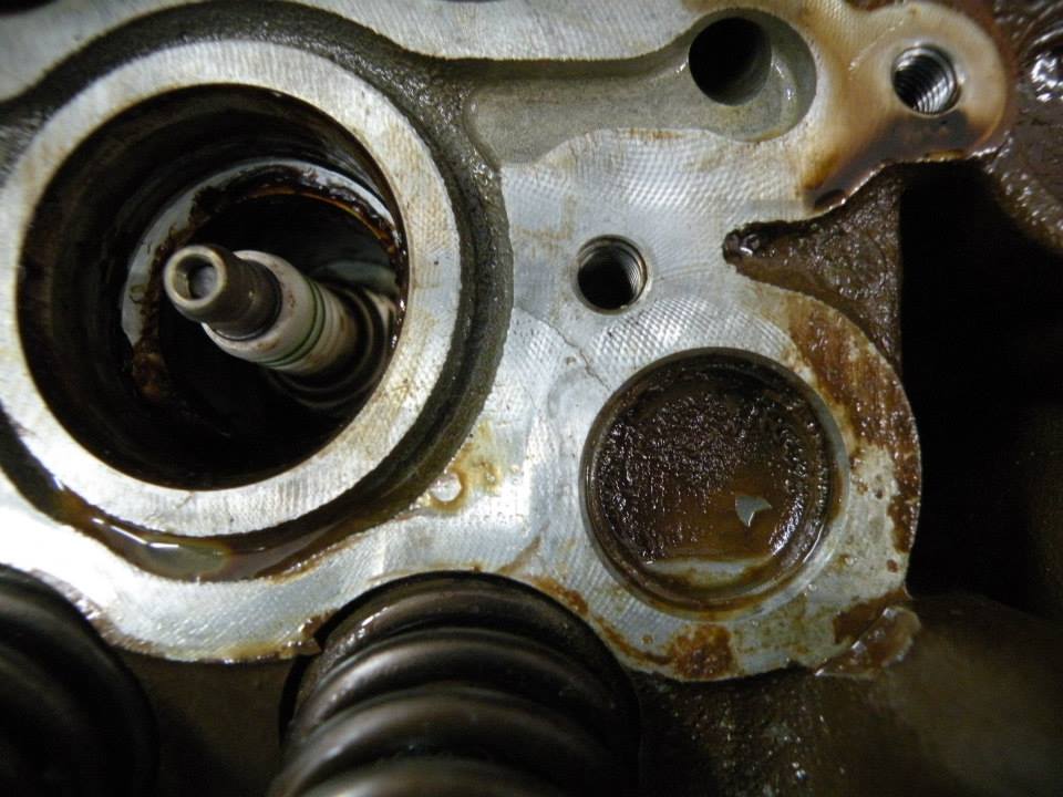

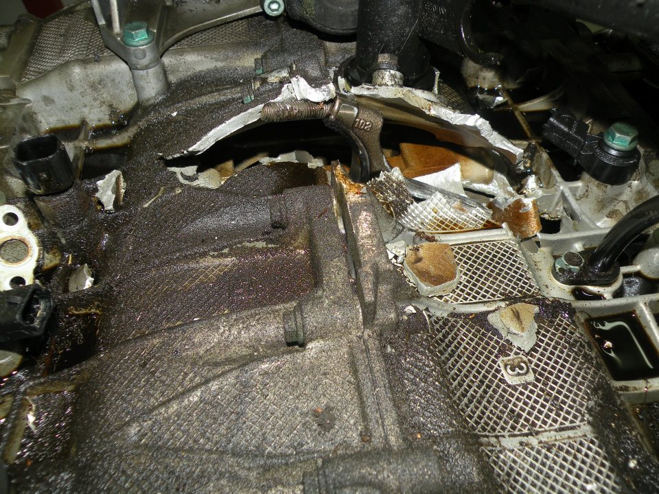

The M96 engines DO NOT blow head gaskets. Period! The MLS gaskets are stronger than the cylinder heads and crankcases.
The symptoms that you have can be caused from a lot of things. We save engines weekly that were deemed junk by others.
You need someone with a clue about M96 engines to really diagnose this.. You won't find that at the dealer level, we pluck cars out of dealer lots all over the country and save them weekly after being deemed junk.
For a taste of the things that we save just see the photos on the facebook page for my Flat 6 Innovations division www.facebook.com/fixabrokensix
Some of those pics will blow your mind.
Have you recently replaced the water pump??
You have a cracked head. These engines DO NOT need to overheat to crack heads, localized hot spots are all thats required. Its not junk, we've resurrected about 40 of those engines this year alone. The 03 engines crack on the backside and the EGR ports weep coolant into the exhaust. Thats what the 03 86S engine does. Nothing new here. No biggie.
I am finishing the engine build photos for my M96 engine book this week :-)
Here's what you can expect..
(IMG:http://www.914world.com/bbs2/uploads_offsite/scontent-b-atl.xx.fbcdn.net-1095-1386210873.1.jpg)
Or this
(IMG:http://www.914world.com/bbs2/uploads_offsite/scontent-a-atl.xx.fbcdn.net-1095-1386210874.2.jpg)
And trust me.. You have a best case scenario for an M96 engine issue. This is what we usually get for a failure call.
Hell, we can even resurrect most of these after throwing away over 100 pounds of OEM parts in every build, blown up or not!
(IMG:http://www.914world.com/bbs2/uploads_offsite/scontent-b-atl.xx.fbcdn.net-1095-1386210875.3.jpg)
(IMG:http://www.914world.com/bbs2/uploads_offsite/scontent-a-atl.xx.fbcdn.net-1095-1386210876.4.jpg)
(IMG:http://www.914world.com/bbs2/uploads_offsite/scontent-a-atl.xx.fbcdn.net-1095-1386210876.5.jpg)
(IMG:http://www.914world.com/bbs2/uploads_offsite/scontent-a-atl.xx.fbcdn.net-1095-1386210877.6.jpg)
