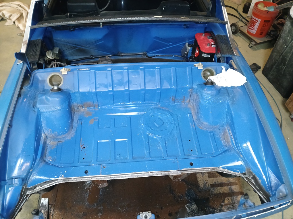

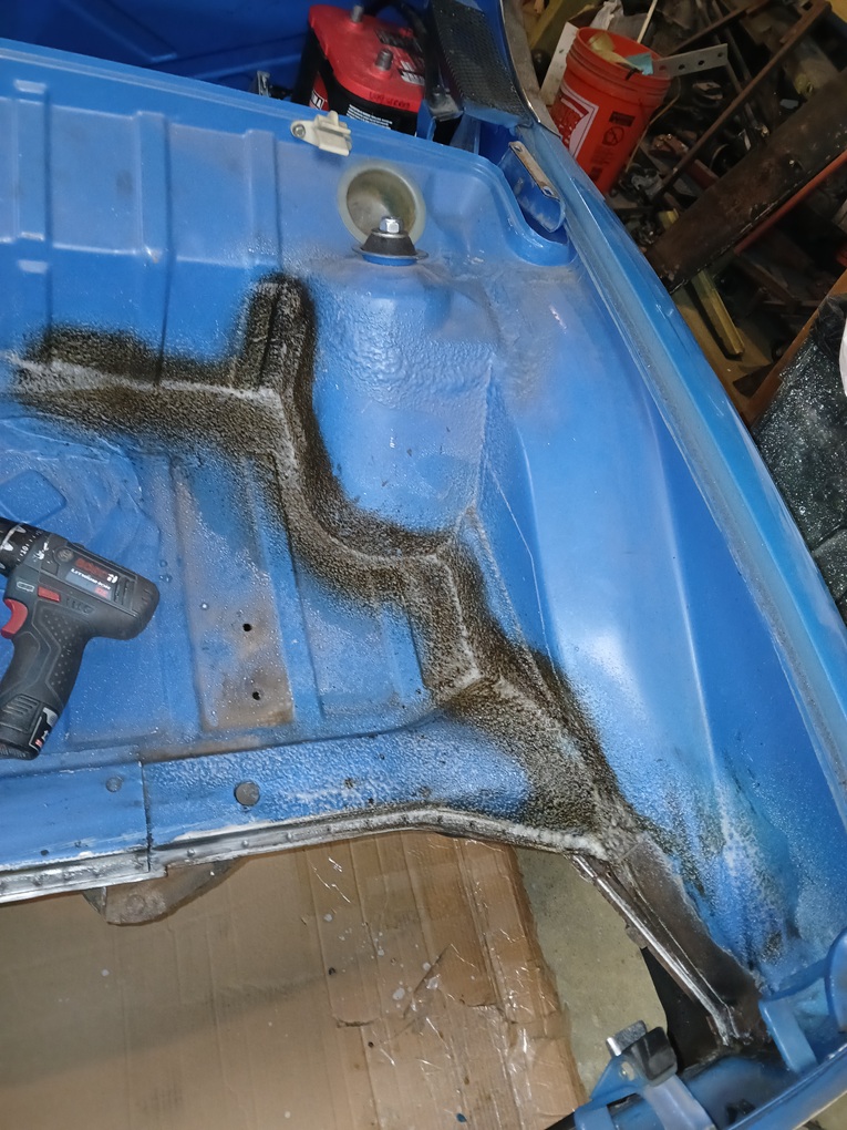

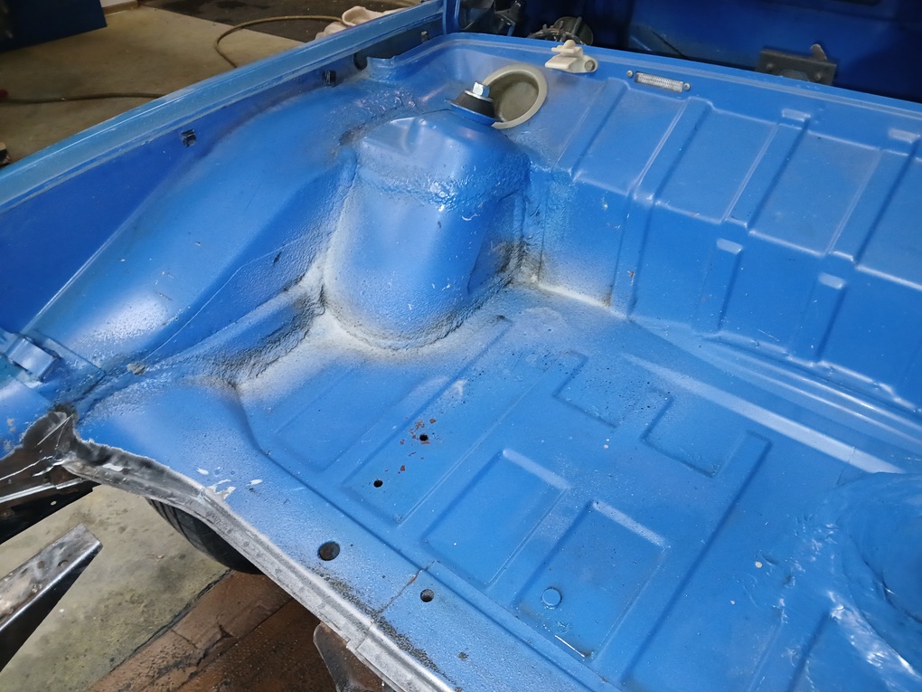

Time to bump this for Ben. His car is back for another little tweak. This time it is the rear trunk pan. I am just doing the minimum repair. The car is really nice. However there were a couple things I couldn't leave though. At some point there was some black petroleum based under coating sprayed over the factory rubber under coating. I am not sure any of you had to try to remove this stuff but it does not come off easy. I ended up using a spray can paint stripper, Heavy grease and oil cleaner, Brass brushes, plastic brushes. dish soap and a crap load of time.
More to come as I get closer to tig and spot weld the rear pan back in.

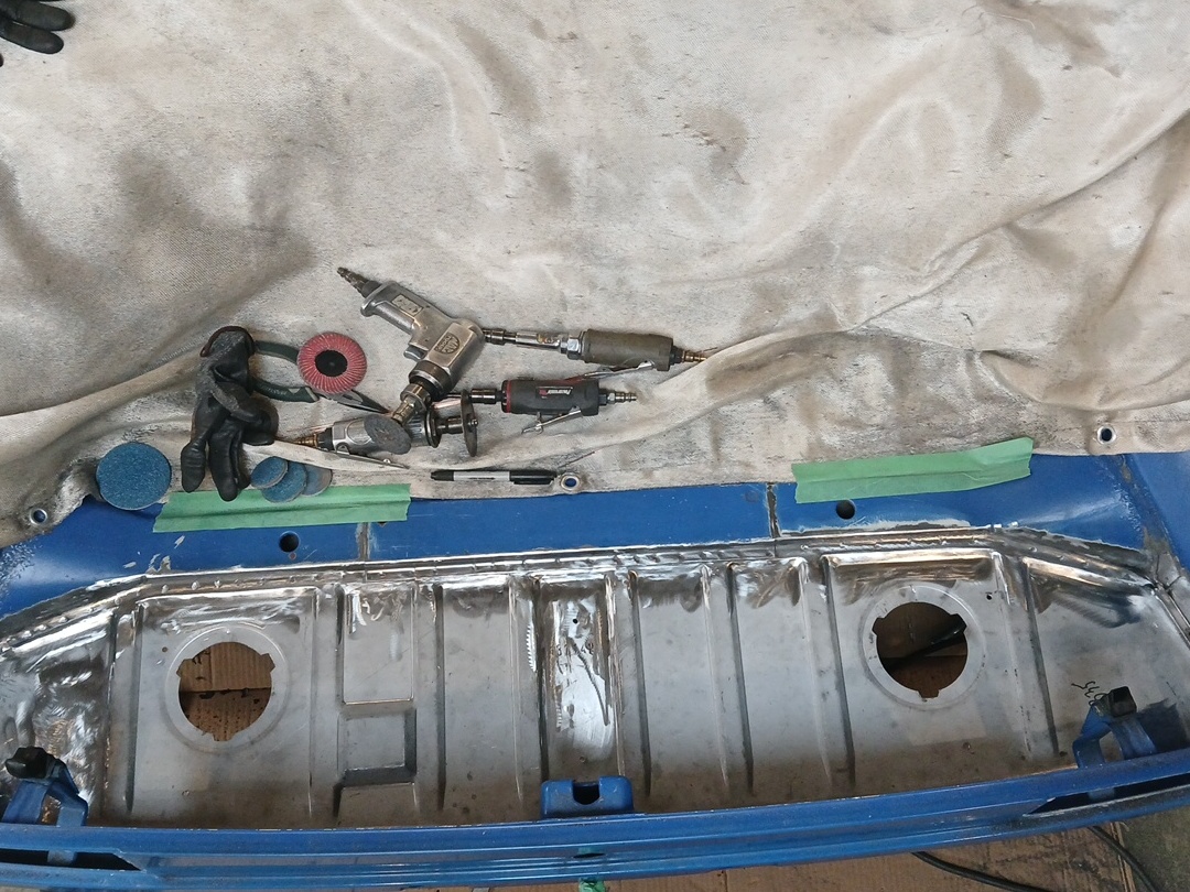

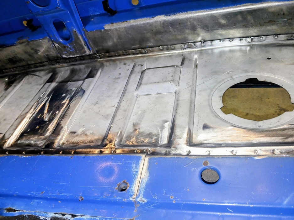

The tig welding part is done. Next is the Lenco spot welder.

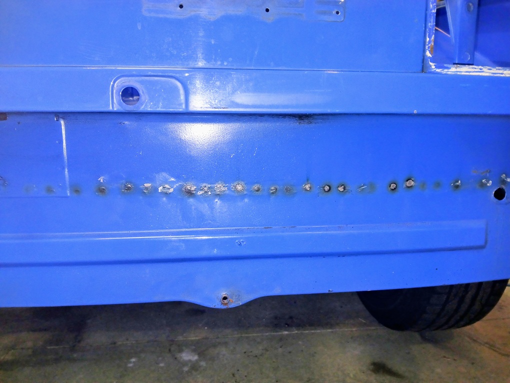

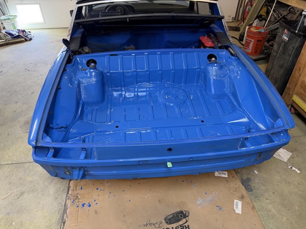

All the welding is finished. I used my Leno Spot Welder to face spot the floor flange tot he tail light panel. If there is any doubt the power this welder has you can see it smoked the paint on the outside of the panel. this is through the new flange and through the original flange I left in place.
On to prepping for paint. I need to crawl under the car and clean and prep the back of the welds. (IMG:style_emoticons/default/dry.gif) The car was repainted once and the exterior color is lighter and I think a nicer shade of blue. I believe when I did the repairs back 2014 I matched the exterior color because I needed to blend the right door jamb to the exterior QP. I doubt I have paint left from the last time..

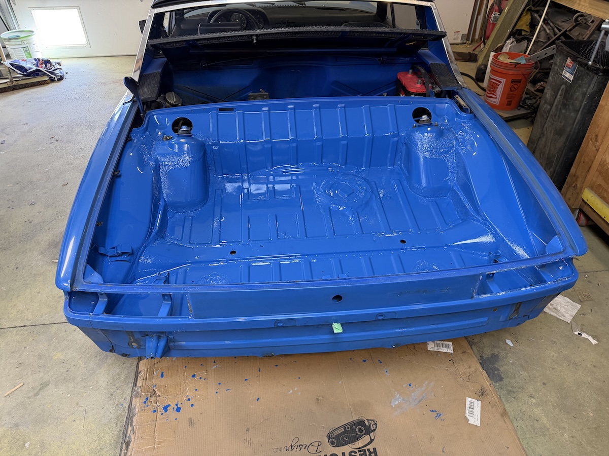

It's looking great, Rick. Can't wait to see your amazing workmanship up close next weekend.

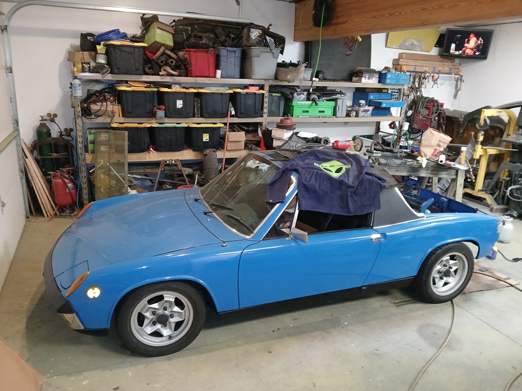

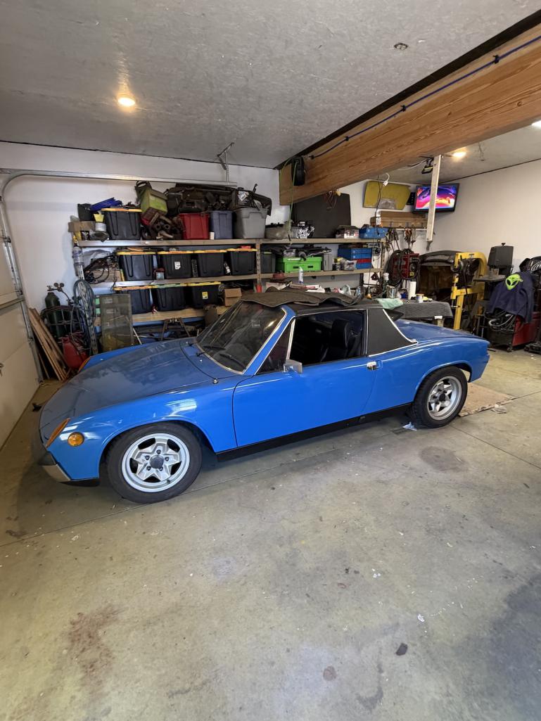

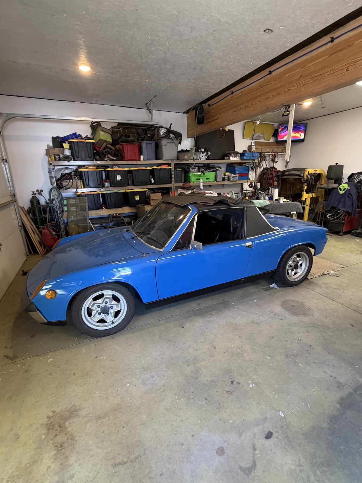

With Spring time driving season hopefully right around the corner her in Minnesota it's time to dust off this thread, and the the car, so it's ready for some fun.
As noted in Rick's prior post, I dropped the car off with him January for a butt lift - well actually replacement of the rear tank pan. At one point I thought I had the skills and time to tackle it, but with an absence of time (and likely the skill as well), I phoned a friend. Naturally, as you'd expect, Rick did an amazing job repairing the car, doing it right, and making sure you might never know it was replaced. Big thanks to Rick as I know this took longer than he thought and kept him from the many projects of his own in the garage.
Next week, the car is back to get its engine and transmission put back in. Normally I'd tackle this, but I had the engine looked at by a local engine specialist this summer. I fully expected that it needed a rebuild, but he dissuaded me. That's a good quality in an engine builder I suppose given it saved me a lot of dough. He did, however, remove the chain housings and cam towers to address some oil leaks that I couldn't have otherwise fixed on my own.
Beyond the engine reseal and look over, the car is being treated to a rennshift shifter, new MSDS headers from Marty, a trick Achtungkraft exhaust, and some other little upgrades. I've declared the last two summers officially the summer of driving this 914-6, and this time around I think the car will really be in a good spot to log some miles.
Stay tuned for more updates

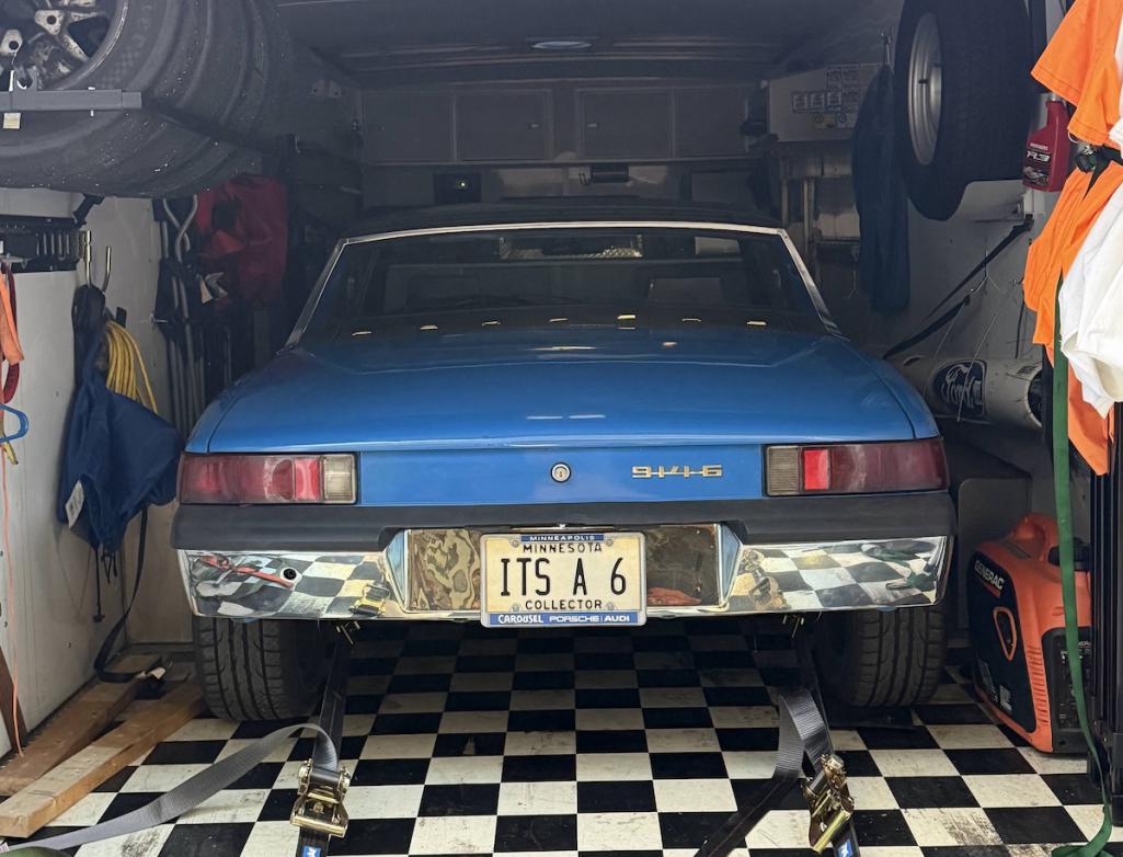

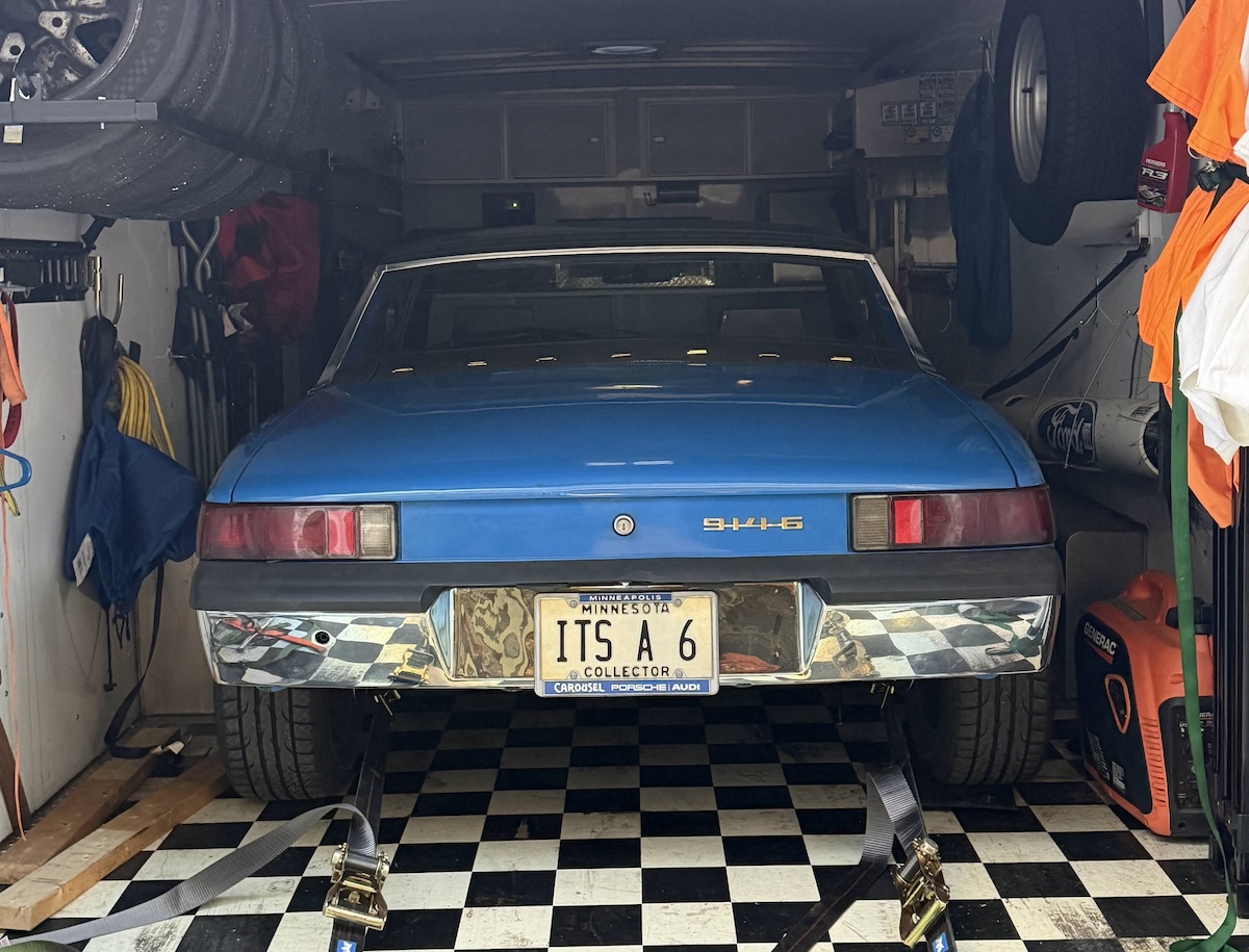

With the help of my daughter, I got the back end of the car reassembled after unloading it from its visit at Rick's for floor pan repair. She stuck around for longer than expected in the garage and without too much effort, we got the rear wiring harness back in place, trunk gaskets back in, taillights installed with new gaskets, 914-6 trunk badge in-place, blasted and refinished exhaust heat shield installed as well as some other odds and ends.
I then loaded the car back up in the trailer and dropped it off this morning to be reunited with its drivetrain. With a little luck it might be back on the road next week, but we will see.
