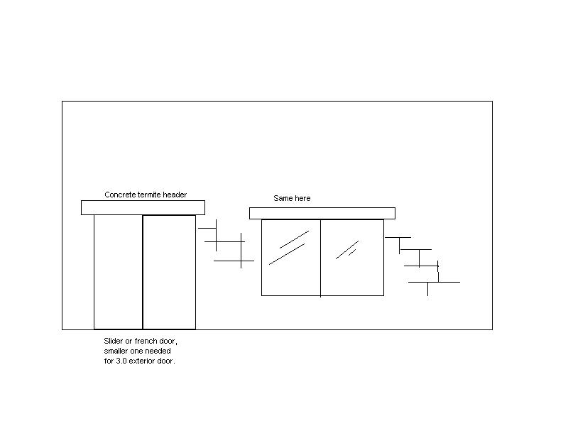

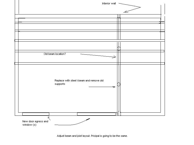

I'm a former custom home builder. If you can send me a crude layout and another with the planned changes. I'll tell you what you will need to support the area. Spanning 14' is a no brainer with a 2 X 12 with half inch plywood center. However I have to agree that you loose headroom. Since you are only removing pieces of the original block basement for doors and windows to egress outside ( I think that is what you are doing here right?).
The only thing needed is to support one section at a time under the joists. Then knock out the rough opening for each item to add, i.e window / door , then install a concrete termite header above the location where it butts up against the outside wall plate. This is more than adequate for exterior support. For internal 2X12 or 2x10 wood support beams that have steel supports under them, you need to support on either side of the beam against the joists and replace with a 4X8 or 10 steel I-beam. This is also depending on the span. If it is a long span 16' or more you need to go to a 12" I-beam to get away from a steel support beam in the middle of it. Doing post building beam changes is not a fun job to do, even if you already have knocked out a section of the block for a door egress to bring the beam into the basement. Those steel beams will require some ass to get it up and into the old beam location to go self supporting. Not to leave out getting around the joist bracing on the existing floor to get the old wood beam out. So, if you are only going say a span of 14' ft inside the structure of the basement, then a 4X10 steel I-beam should do the trick for a no post support. As far as the windows and " normal" doors a termite header (s) is the way to go on outside block walls. Hope this helps.....
See examples, the principals will be the same, even if your house is laid out a wee bit different.
Steve Thacker
post Dec 30 2004, 12:10 PM
UMMMPH Yea Baby Yea ! UMMMPH
Posts: 1,089
Joined: 8-January 03
From: Pickerington, Ohio
Member No.: 113
and another
