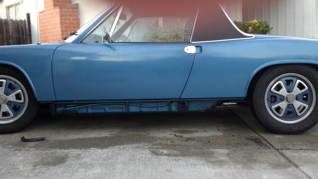

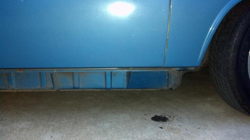

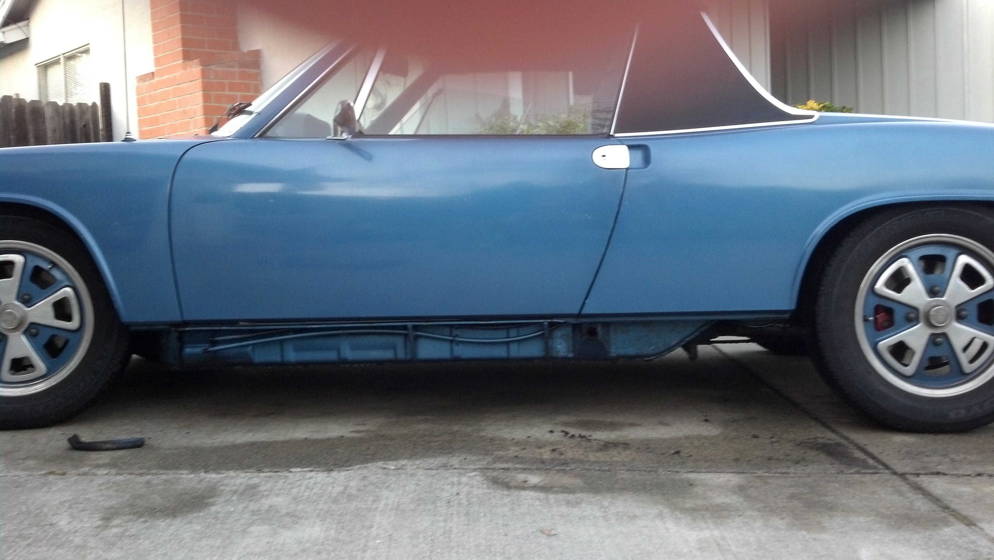

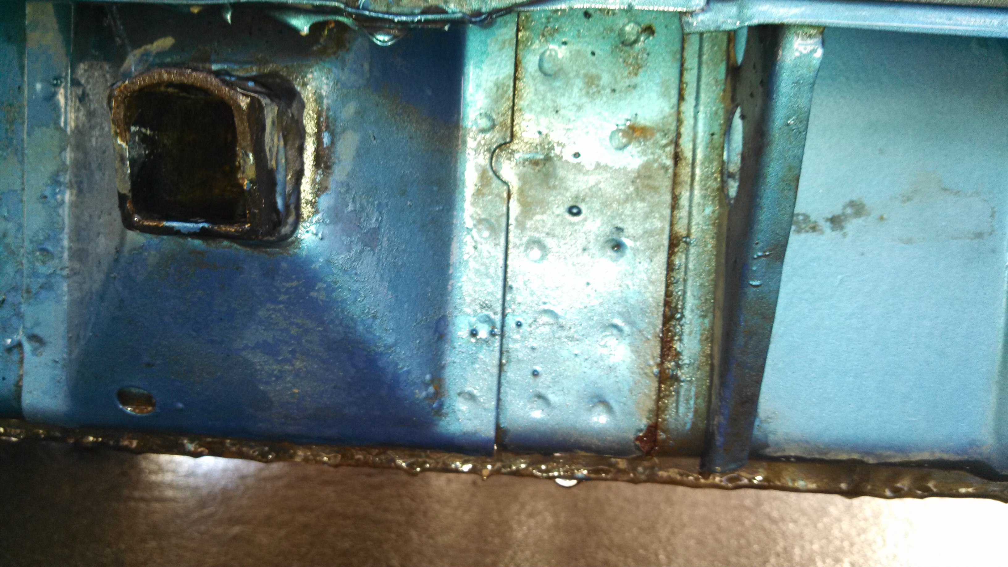

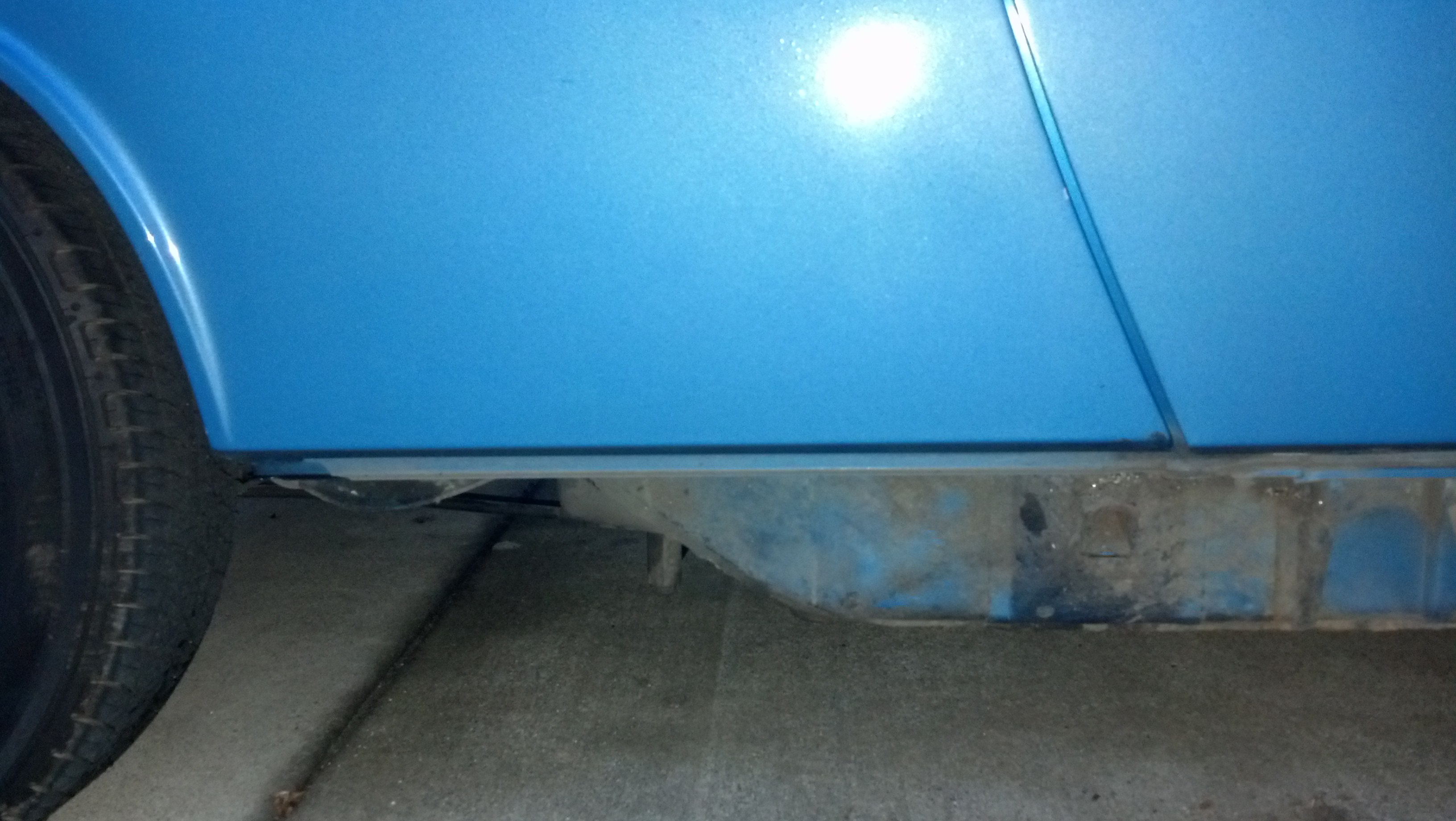

Check your longs!! Mine had some piles of dirt come out (not necessarily picture below) but not that much. There wise a nice clod of dirt compacted around the jack point on the passenger side.
My car is, so fortunately, looking pretty good. I have rust in the hell hole. My firewall and floorboards look great. I am sure there is rust back in behind that long area though.
First is drivers side:

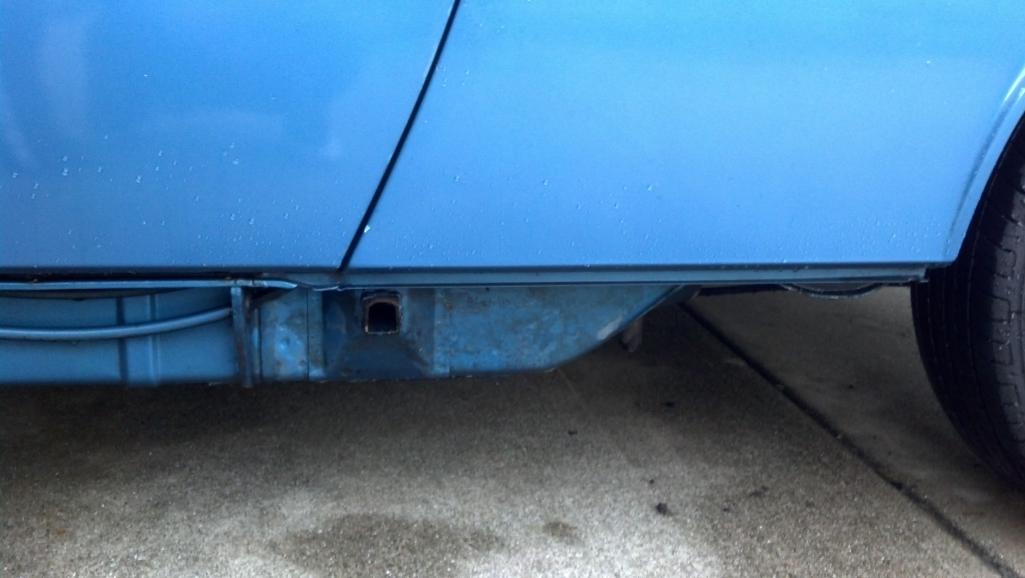

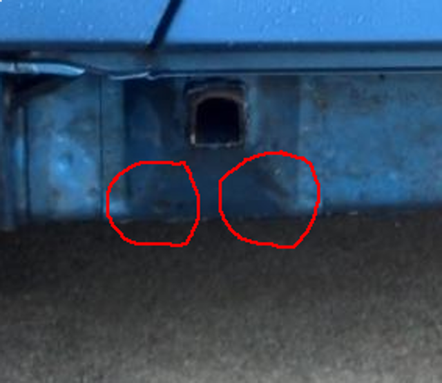

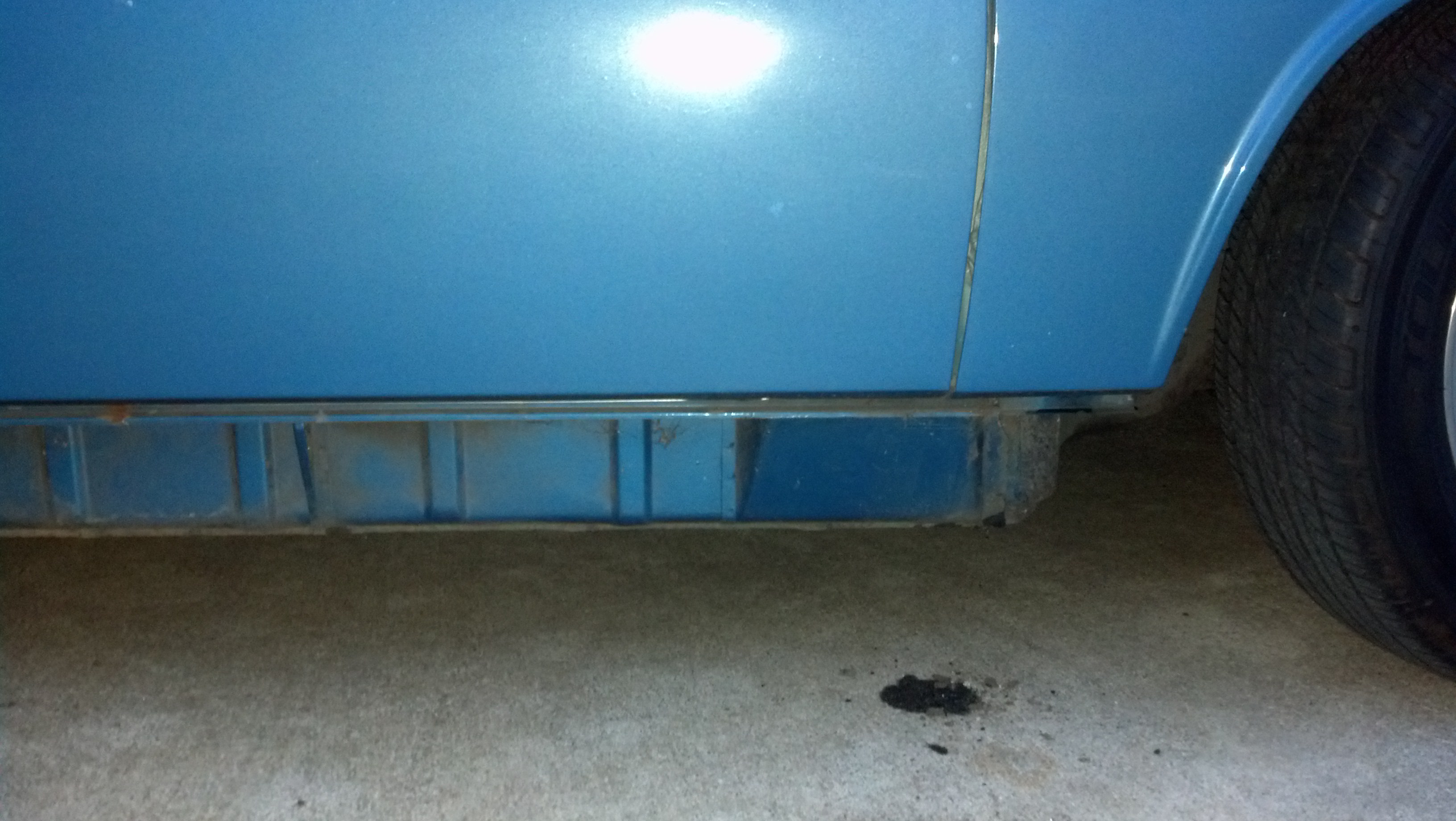

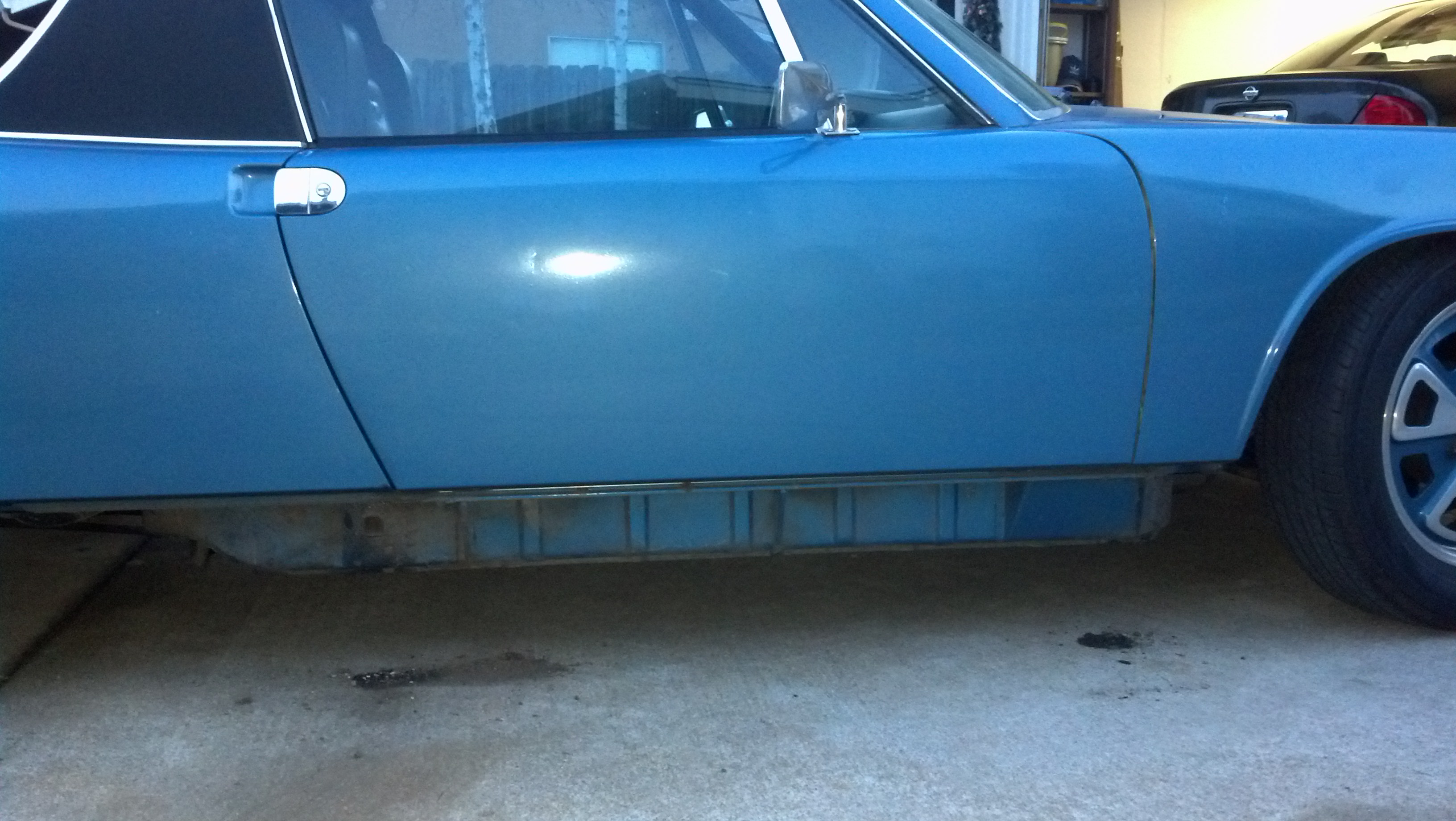

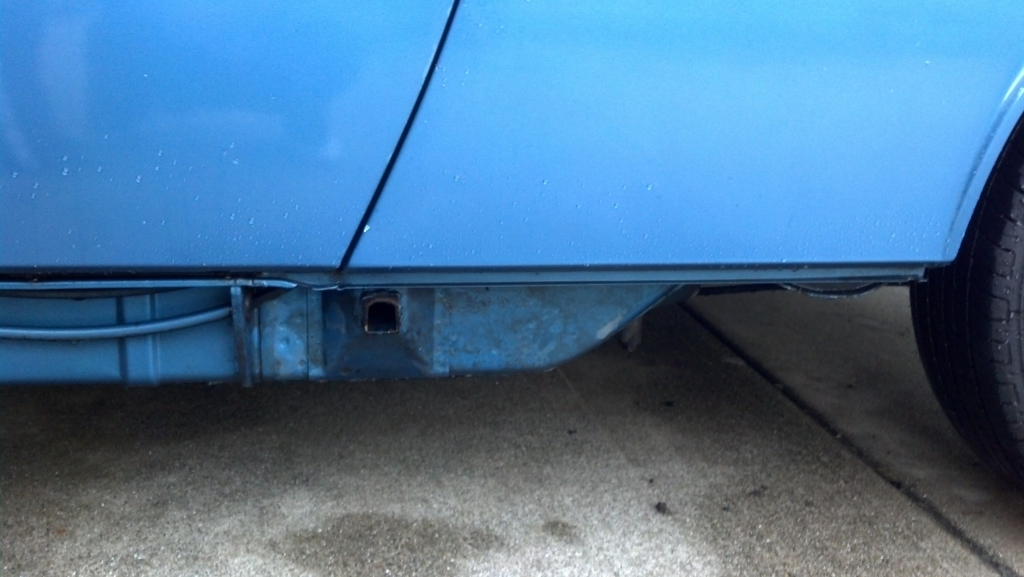

And passenger side:

with that amount pictured i think you're in pretty good shape.

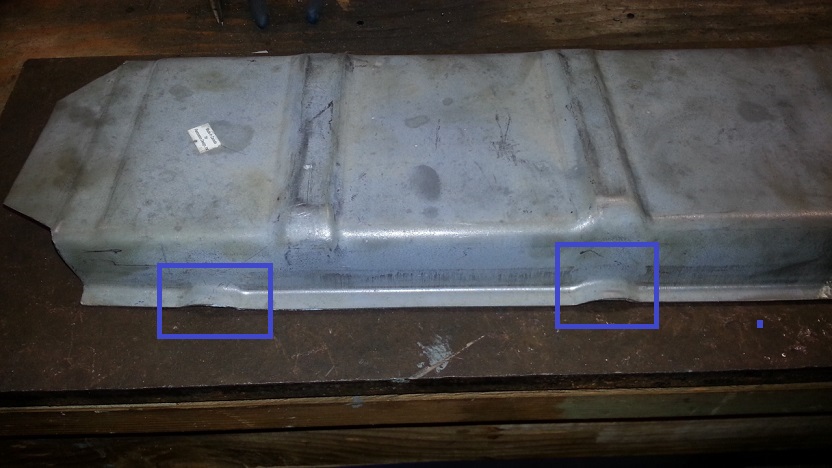

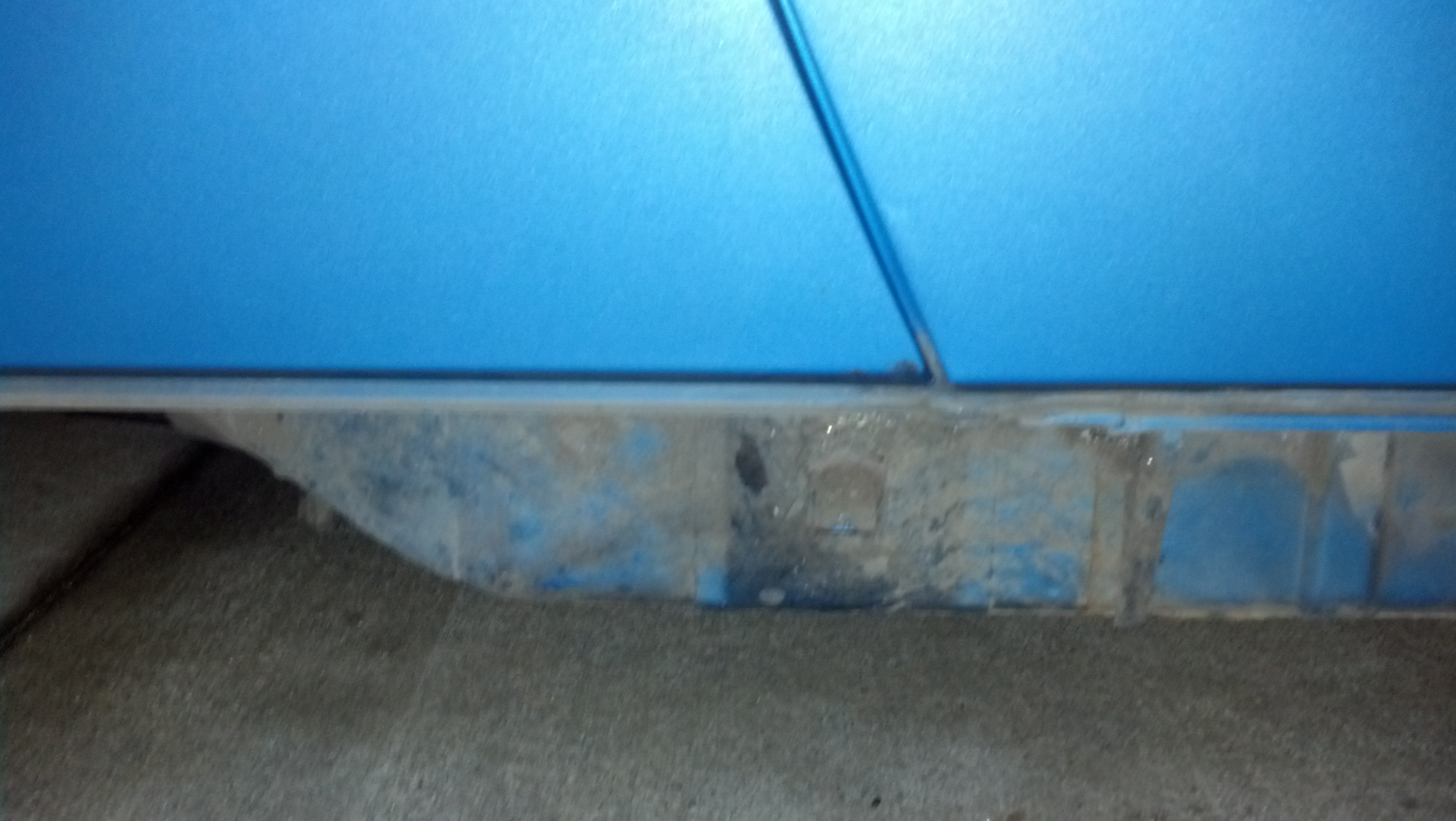

Here's a picture of the rocker laying on the bench.
Inside of the blue boxes are the drain holes.

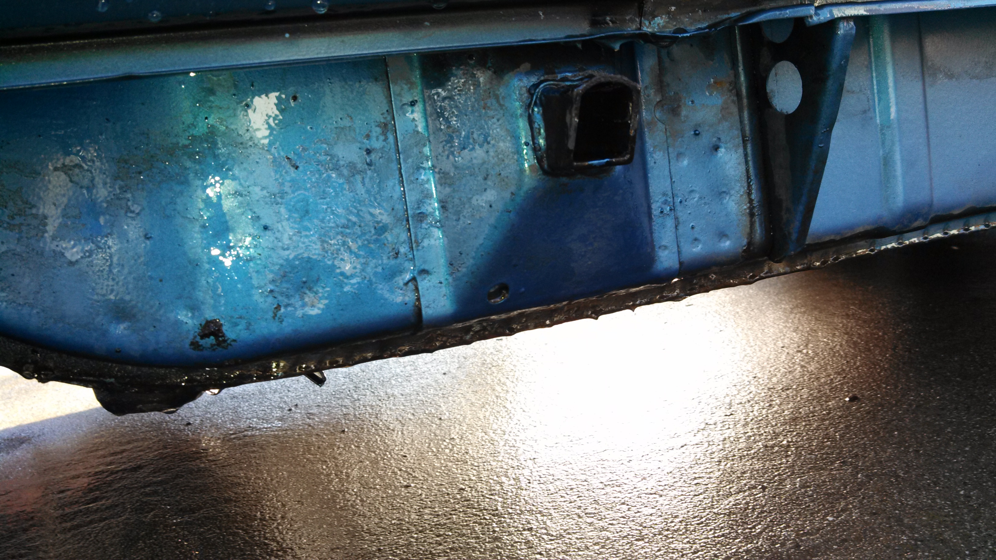

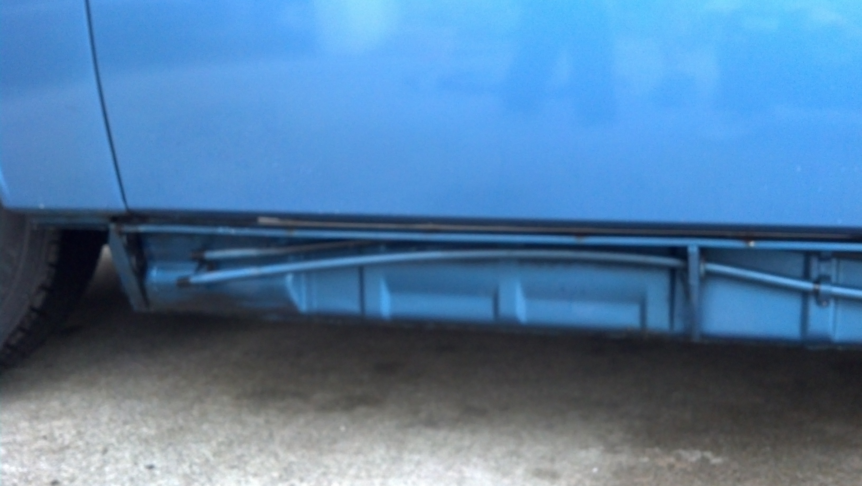

So I was able to finish cleaning up the longs today. In addition, I checked all of the drain (weeping) holes on the longs and jack point and they are all clear. I'm in the midst of rattle canning my rocker panels but that will be another thread.
For now, here are a couple more close ups of the passenger side long and the "worst" of it...which thankfully is nothing.

Doesn't look bad at all.
Maybe wire-brush the surface rust and hit it with some rust mort (or a similar product)?
I'm more concerned with what the insides of my longs look like, since I did have a hell hole issue/repair.
I need to determine the best location(s) to insert the inspection camera. I don't think the OEM drain slots are large enough to accommodate the camera head. I'm leery of pulling those rubber plugs from the inside (passenger compartment) for fear they will either break, or have a hard time reinstalling them (IMG:style_emoticons/default/confused24.gif)
Are they still available new? ... Bueller?, anyone?
