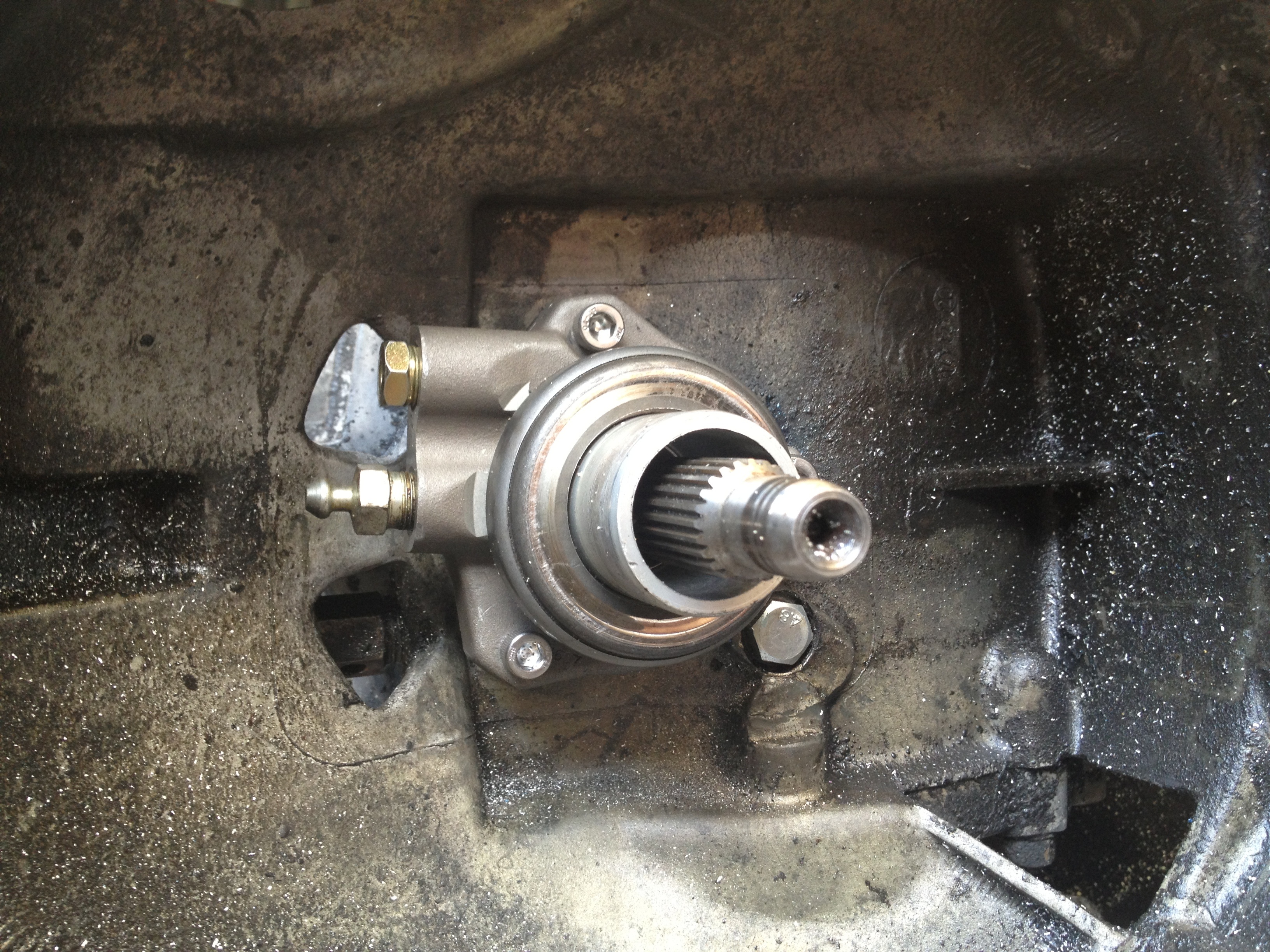

I'm currently sorting out a hydraulic release bearing but need some help with some measurements. I can't find the original release bearing or arm and need to know how much total travel the original arm gives in the bell housing. It would be really helpful to have a measurement for the depth from the bell housing mounting face to the release bearing also
Another thing that is holding me up is that the clutch disc I have sitting here has no friction material left at all. I checked the manual an it states new thickness is 9.14mm. Anyone able to confirm with currently available discs?
Thanks heaps guys, ill attach a pic so you can get a feel for what I'm doing
