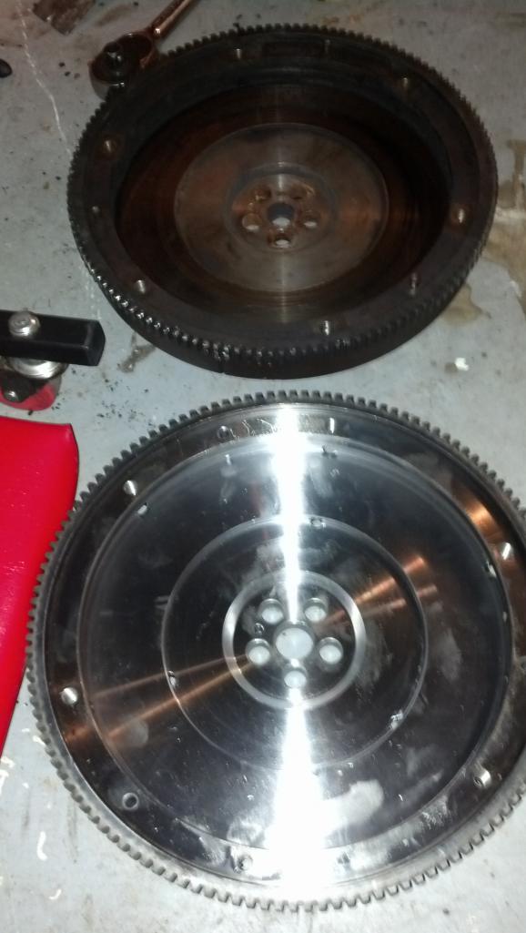

**new question, the mark on the flywheel was in the down position when removed, so i marked the new one same location upon installation- so for doing valves and timing, what position is this in now, 180 off of the #1TDC?
New flywheel is not marked for Tdc and it does not have the dowels/pins to align and mount the clutch to. Can I mount it with out these.?

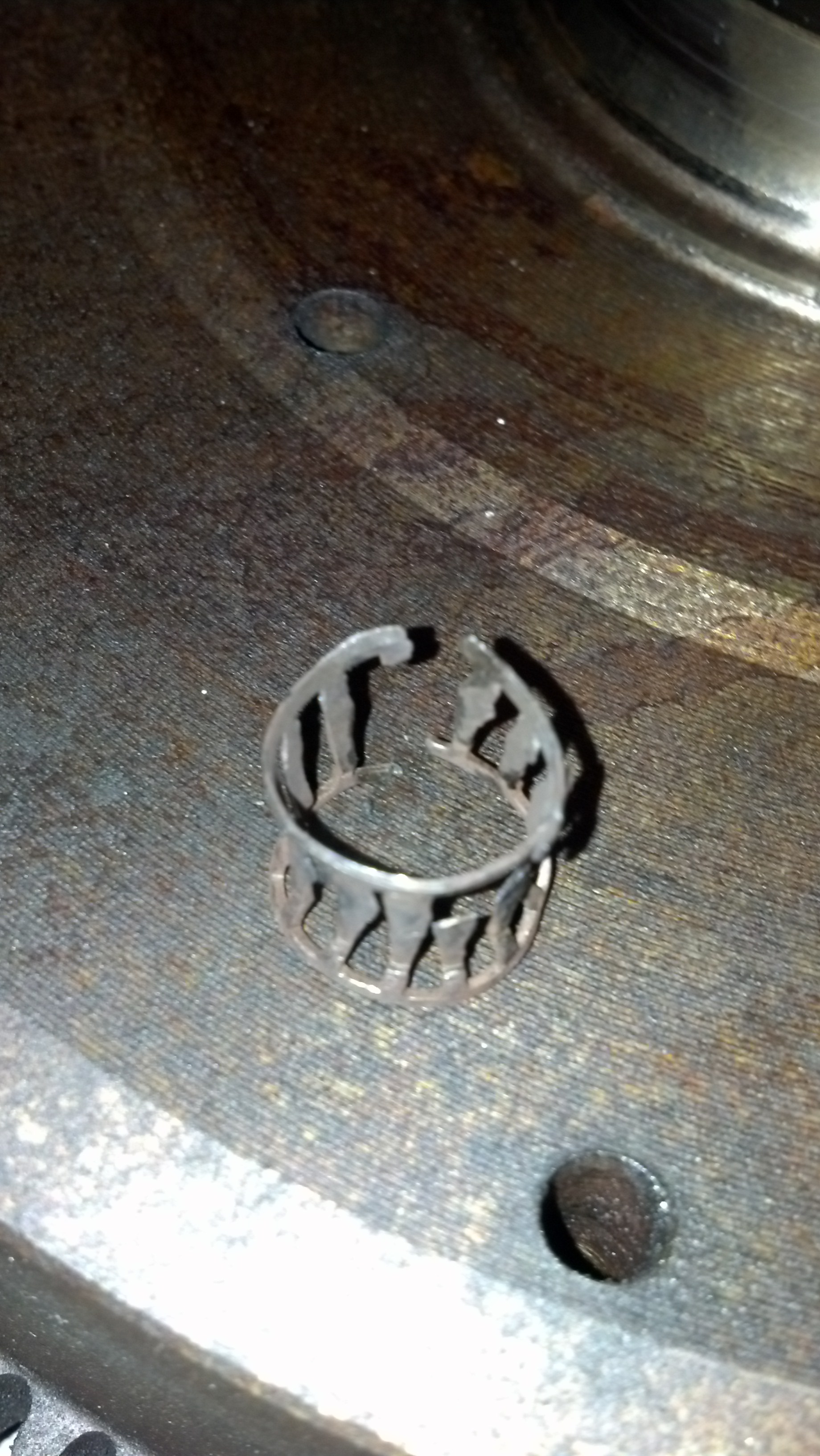

Here is the old bearing-flywheel bearing (IMG:style_emoticons/default/blink.gif)

You need the dowels. They take the rotational stress of the pressure plate. I am not sure the bolts by themselves are strong enough, and I am sure they are not precise enough.
--DD

Another thing I have noticed on the new flywheel being sold as German OE is I don't see a single drill mark for balancing. (IMG:style_emoticons/default/WTF.gif)
I have a hard time believing that they are popping out perfectly balanced flywheels

The dowel pins knock out from the back. Use a good punch and bang away at 'em. You need then to properly locate the pressure plate on the f/w. You can live without the TDC mark, or add it once the f/w is installed using the fan TDC mark as a guide. Note, do NOT use the full advance mark!

you should get a flat punch and be able to drive them out of the old flywheel in less than five minutes

I npotuced right away the they are not identical , not having all the holes that the original one had.
But I got it mounted last night along with the pressure plate and transmission is back in. Thanks for the advice.
Response was a. It sloe last night and I wanted to get it put back together , with the help of billh1963, thanks bill for the guidance, I got it done.
All new . Hope its all done right. Has to be better than it was. Based in previous owner paperwork I m ow the clutch had been replaced about 1995 . Figured with 140k miles it could use it , it was slipping but that might have been partly due to oil fro leaking RMS.
