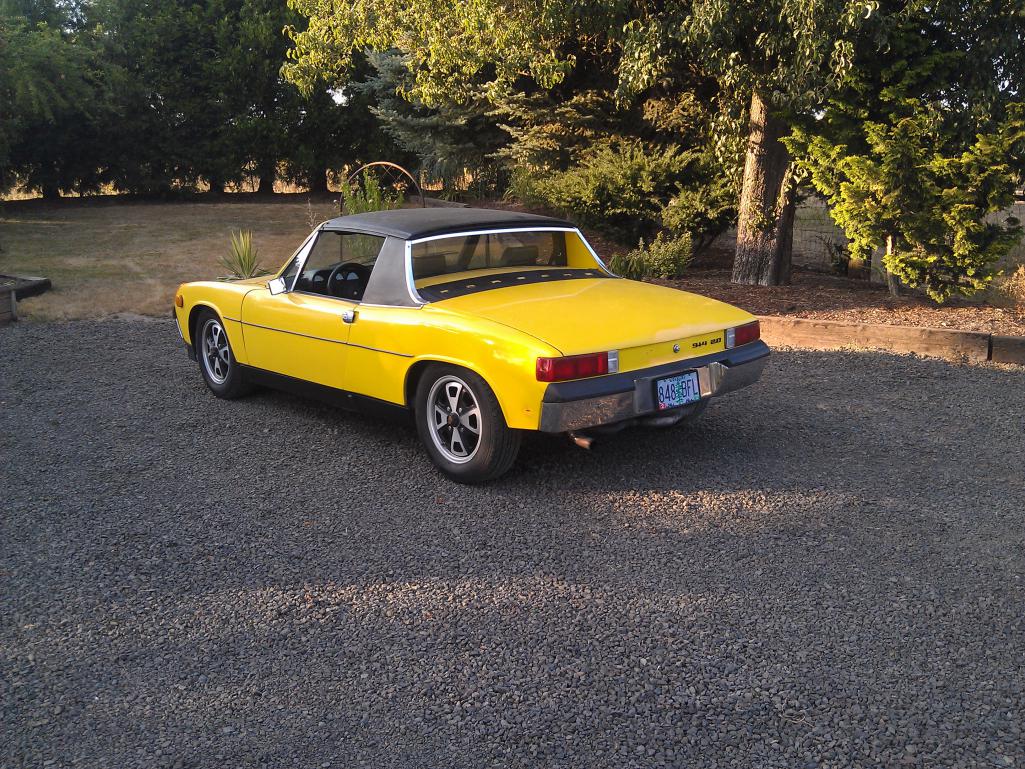

Here is a pic of my car just because I like threads with pictures.
