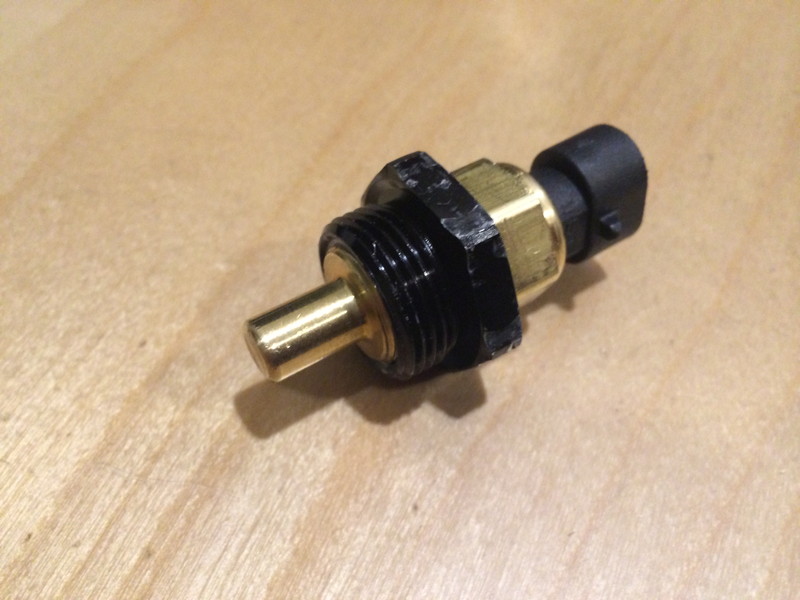

mikesmith
post Jan 24 2014, 12:13 AM
Posts: 202
Joined: 5-September 13
From: SF
Member No.: 16,354
Just like a bought one, only different.
