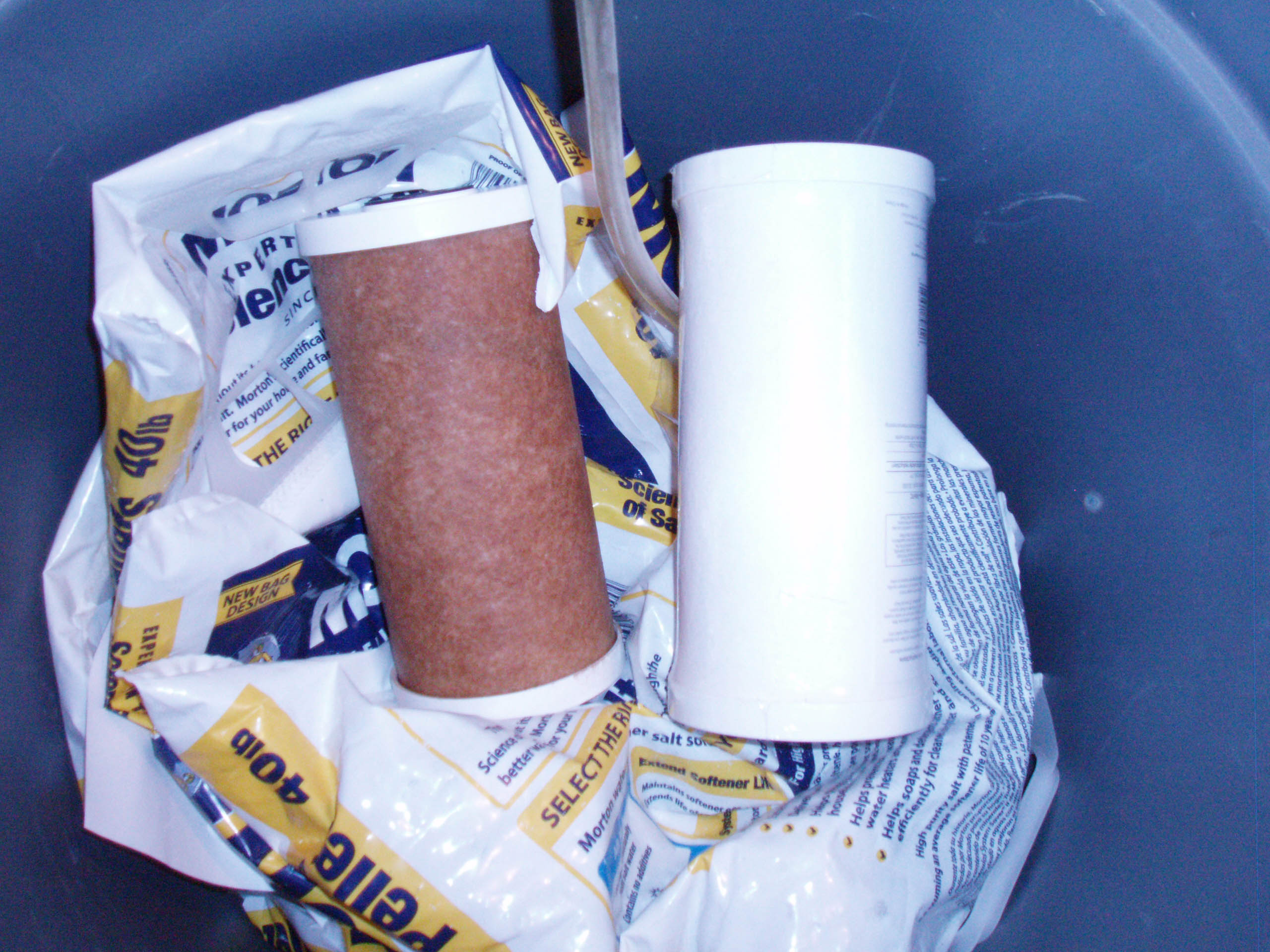

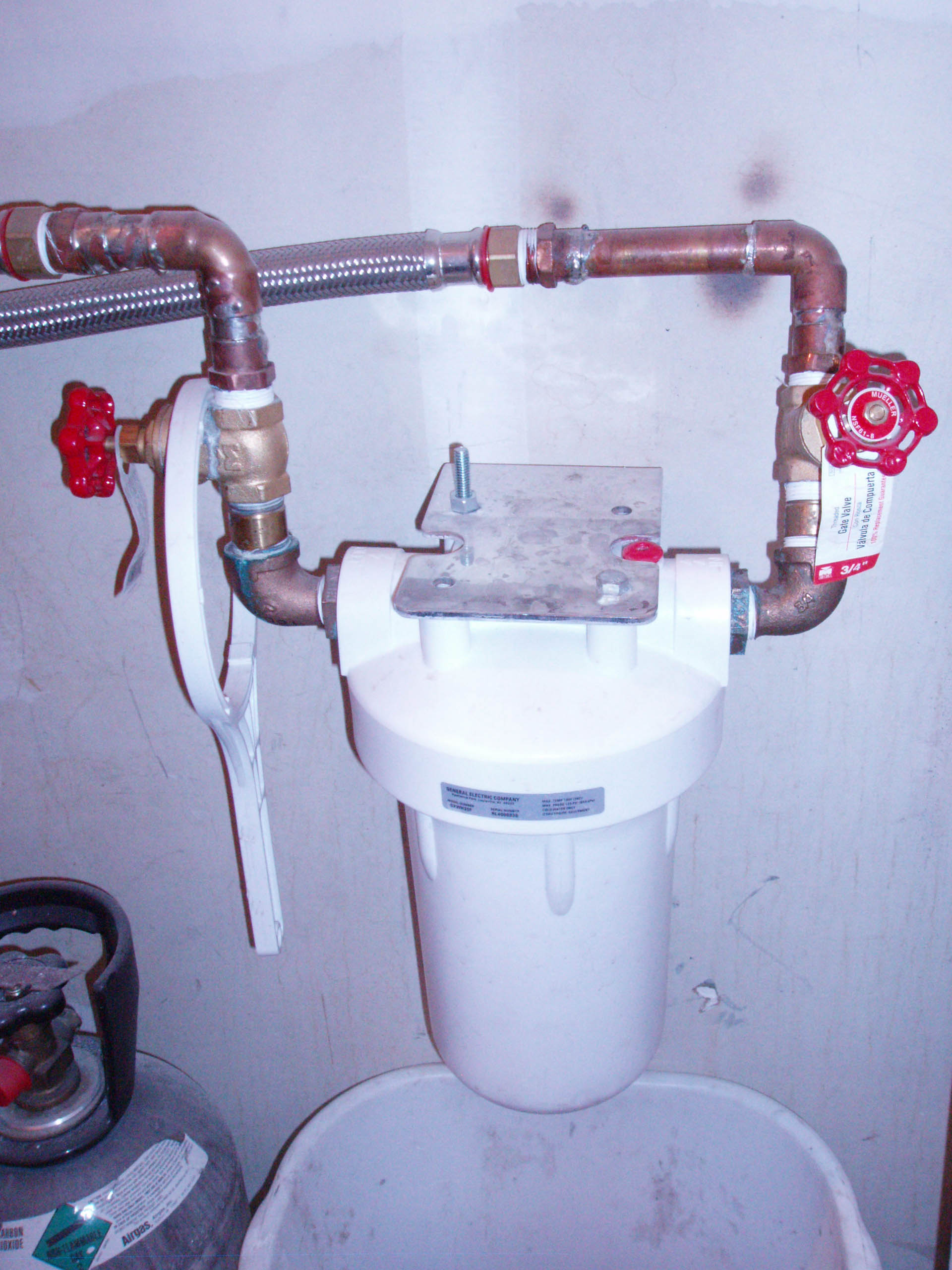

I added a whole house filter in the main line before the soft water maker and it made a huge difference in the flavor of my water! My soft water maker uses about a 2/3's of a bag of salt per month.
I also have a RO system in the kitchen that I use for coffee and cooking.
You can see in these photos the before and after with 2 months of use!

The RO system is a WIN-445 system with a 5 micron filter that was purchased about 13 years ago and I rebuild it every 5-6 years.
The Soft Water Maker is a Kinetico system.
The whole house filter is a GE FXHTC that removes Sediment, Sand & Rust as well as reducing chlorine.

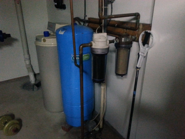

We have a well with trace amounts of arsenic but elevated lead levels. EPA told us not to drink the water - After 20 years in the house. The Fridge has an NSF certified filter which removes 99.99% of lead so we get our drinking water there.
We have 2 whole house filters. First one is 35um filter for big particles, followed by a 5um filter. We had just the 5um filter for a while but filters would clog in 2 weeks. Now filters last over a month.
The water softener is from Sears and is 20 years old. It uses about one 40lb bag of salt per month.
