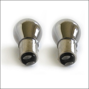

Make sure your lamp base looks like this... Note the oval electrode. European style.
(IMG:http://www.914world.com/bbs2/uploads_offsite/www.pelicanparts.com-10496-1390875608.1.jpg)
(IMG:http://www.914world.com/bbs2/uploads_offsite/www.rallylights.com-10496-1390875609.2.jpg)
(IMG:http://www.914world.com/bbs2/uploads_offsite/d114hh0cykhyb0.cloudfront.net-10496-1390875610.3.jpg)
Not like this... These will cause a bad connection and sometimes short.
(IMG:http://www.914world.com/bbs2/uploads_offsite/a248.e.akamai.net-10496-1390875610.4.jpg)

Good afternoon all
THANK YOU MIKE!!!!!!
It appears that the problem has been solved, but I am not really sure why.
I went out looking for the 1157's like Mike had in his reply, the ones with the elongated contact patch. FYI, I had been purchasing Sylvania (made by OSRAN) bulbs, BUT, they only had the dot and not the elongated patch for the contact surface. Finally, after hitting Autozone, Kragen, and one independent, I found some at NAPA. The correct style is available as a Wagner product 17881. They were NOT available on the rack in the store, but rather on the shelf in back(Sylvania is on the shelf) for the parts counter to draw from.
Got home, made the install and they have worked for the whole day, so we may have found the solution to the mystery problem.

The dot type base can push the socket pin into the housing. It can also short the two if it bends the pins just right. (IMG:style_emoticons/default/smile.gif)
