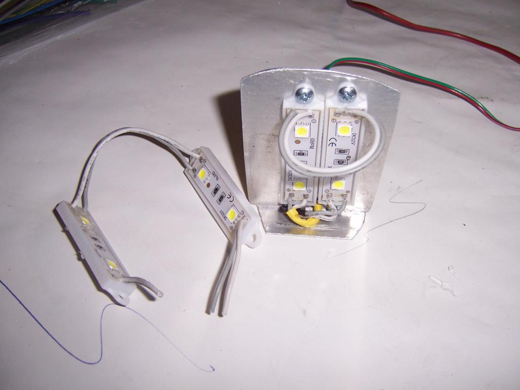

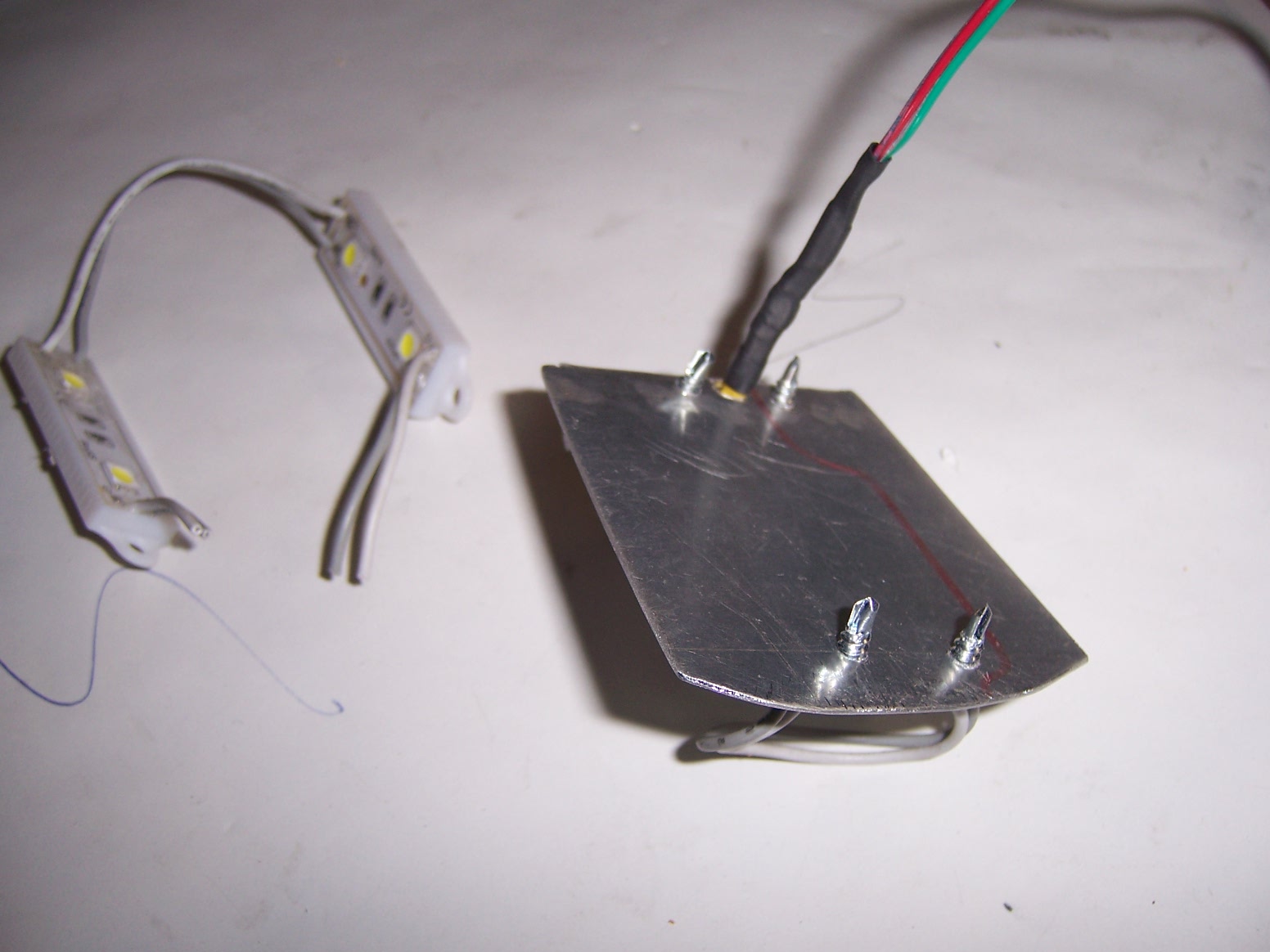

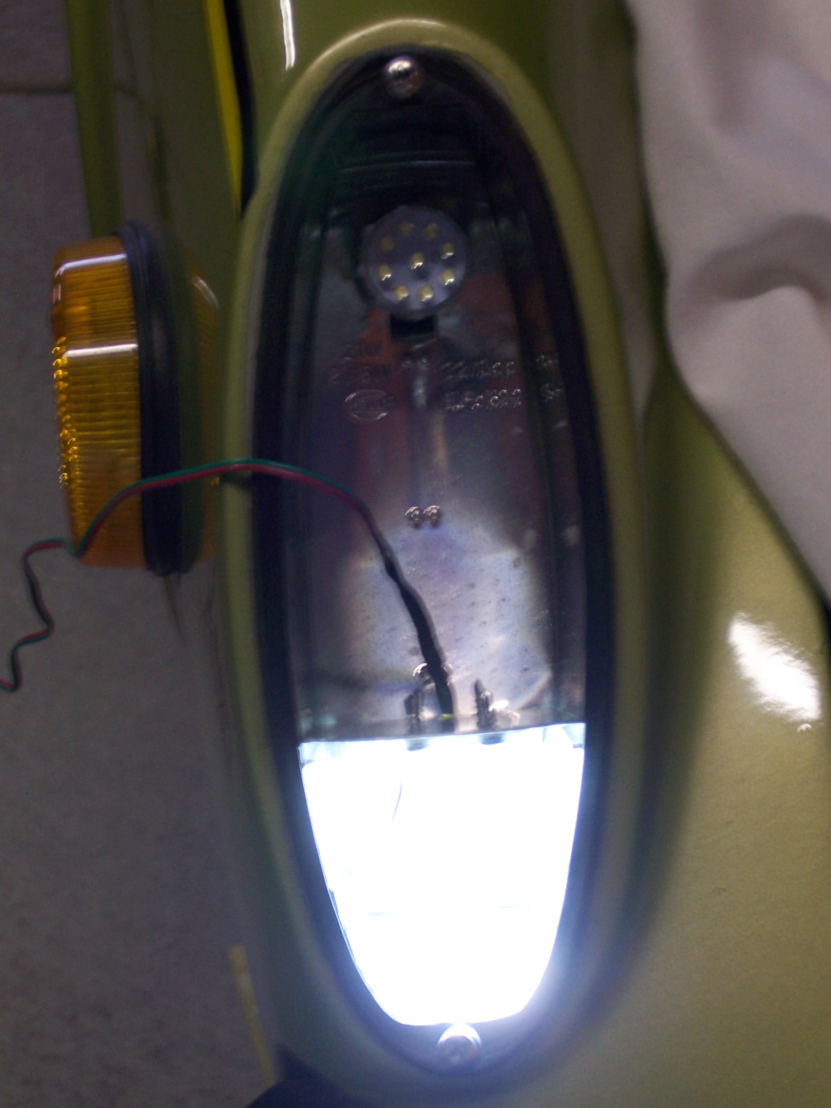

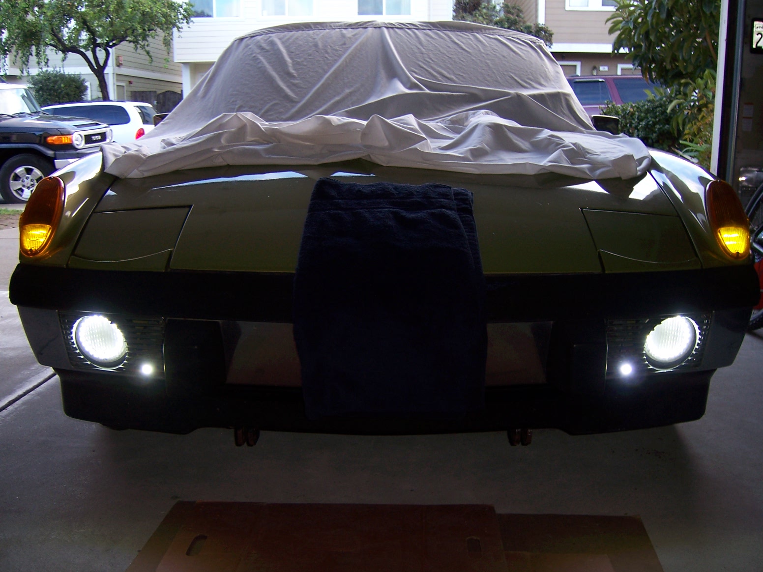

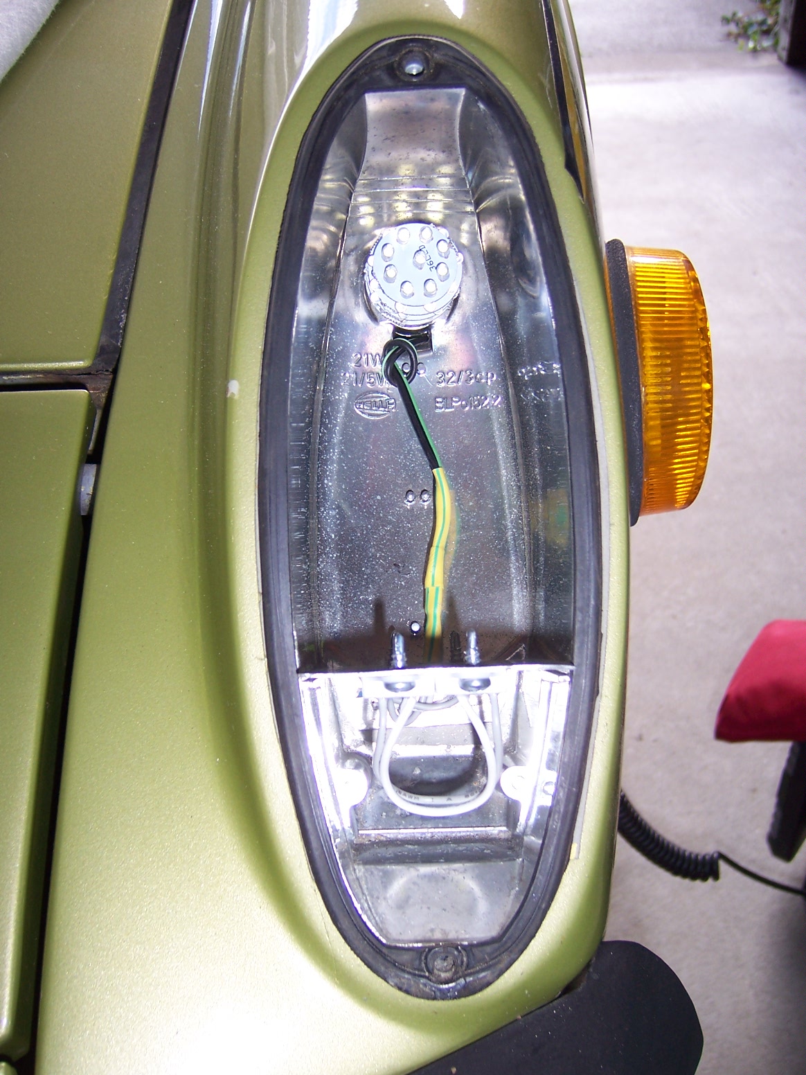

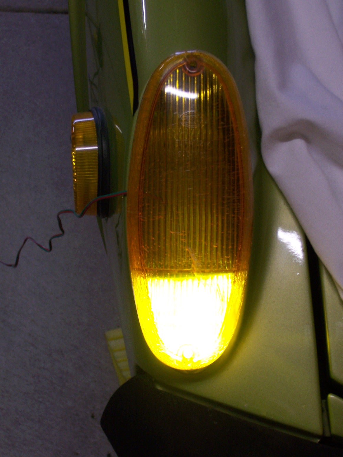

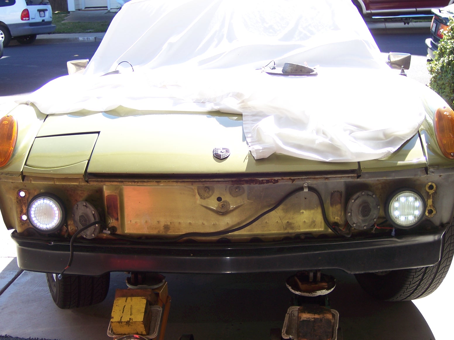

In my continuing use of 5050 LEDs, I devised this lighting system to function as part of my daytime running light system. Once I add a pair of Euro front lenses, I will have the best of both worlds. The car will have Euro signal illlumination and the fog lites can be swtiched on as supplemental daytime running lights. I bent a couple pieces of aluminum as a bracket and mounted a couple of SMDs onto the bracket. I already have a separate circuit for eagle eyes which goes on whenever the ignition is on. As discussed by me in a previous thread on my DRLs, my foglight bulbs were removed and updated with a 90mm circle 24 of 5050 LEDs into the foglight housings. So whenever the ignition is on, the forward eagle eyes and these lower LEDs will be illuminated. The 90mm circle of LEDs in the foglamp housings can be switched on whenever I feel the need.
