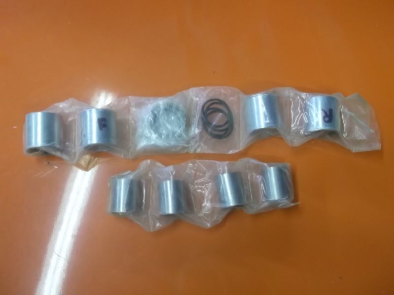

More parts arrived today (IMG:style_emoticons/default/smile.gif)
Full motion front bearings (Original Customs) from Rick.
I don't see any instructions, I'll have to email McMark and see if there's a "how to" thread.

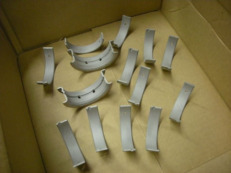

Mmmmm time to bake some bearings.
The cam bearings look rough but they are smooth.

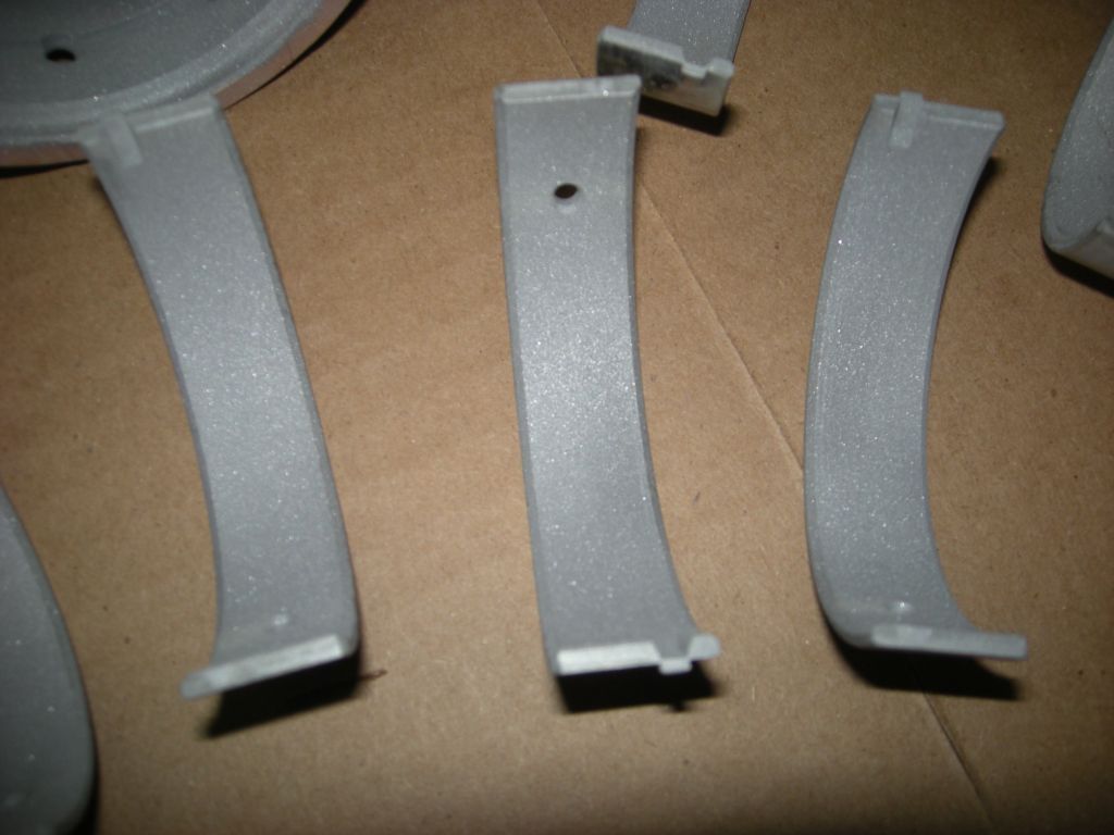

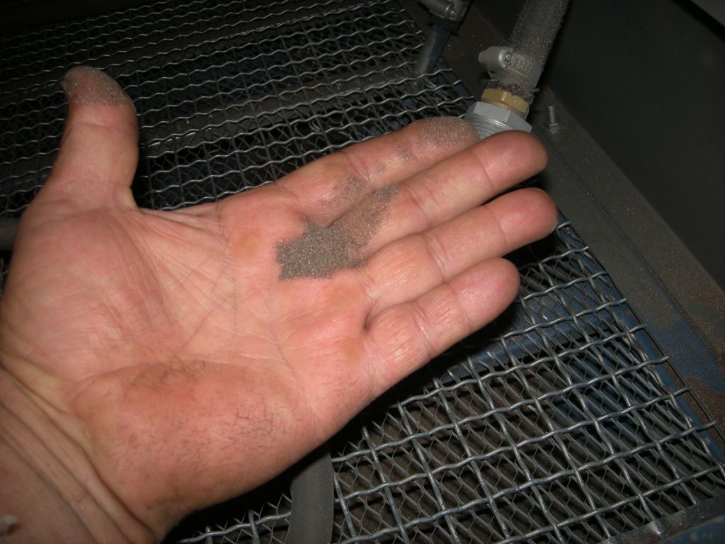

Now the totally scary part, sand blasting my bearings. (IMG:style_emoticons/default/unsure.gif)
You do this with not just any sand, 120grit silicone oxide

You have to blast at low pressure I used 20psi, normally I blast at as high as I can get (120psi)
You just want to etch the surface, takes just a few swipes.
Still scary as shit.... (IMG:style_emoticons/default/huh.gif)

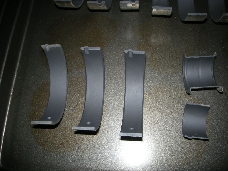

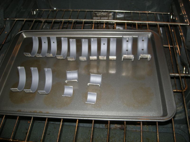

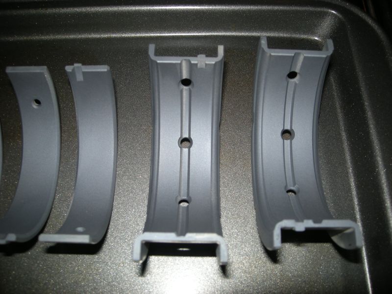

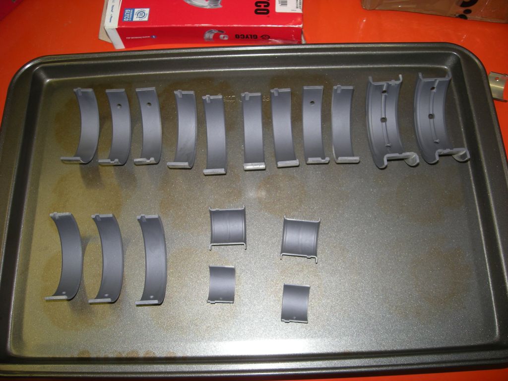

Well this is what the air dried DFL coated bearings look like....let them flash dry for 15 minutes and then it's off to the oven for 1 hour at 350F.

BTW I'm baking right now...another 30 minutes, but so far it looks good...
Where is the sweating smilely (IMG:style_emoticons/default/popcorn[1].gif)

Ding!!!!
Well....they look smooth again (IMG:style_emoticons/default/smile.gif)
too hot to measure yet.

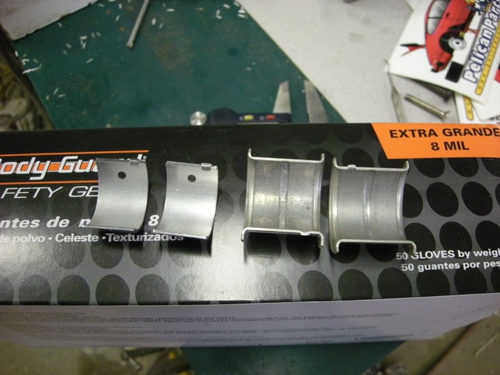

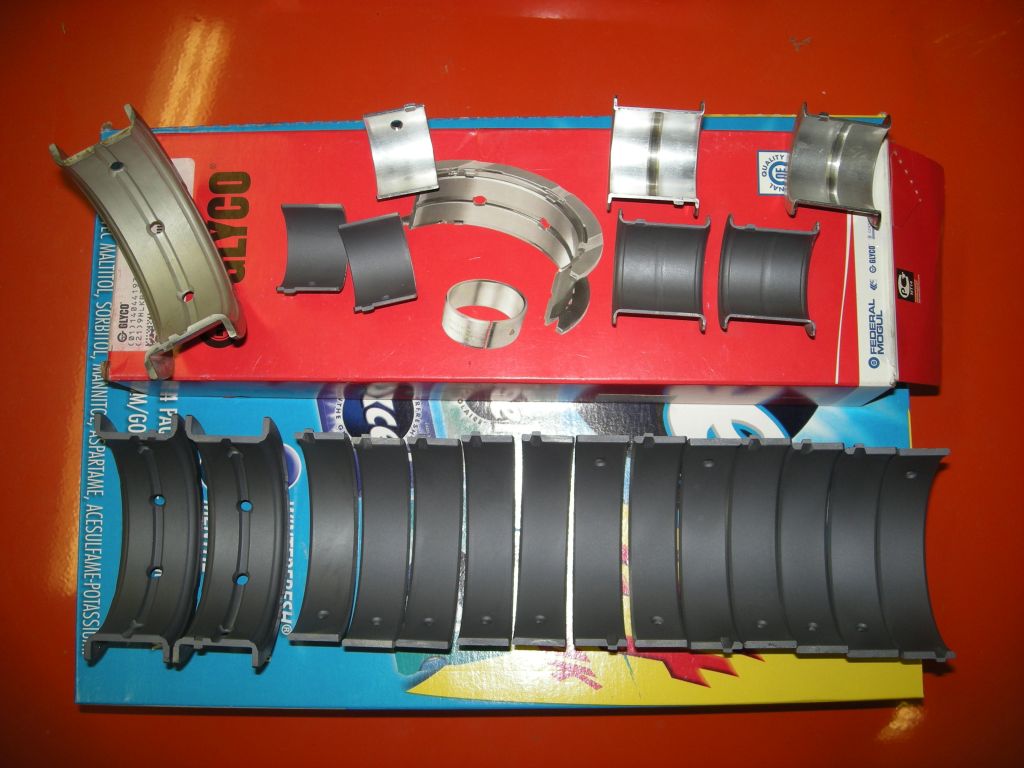

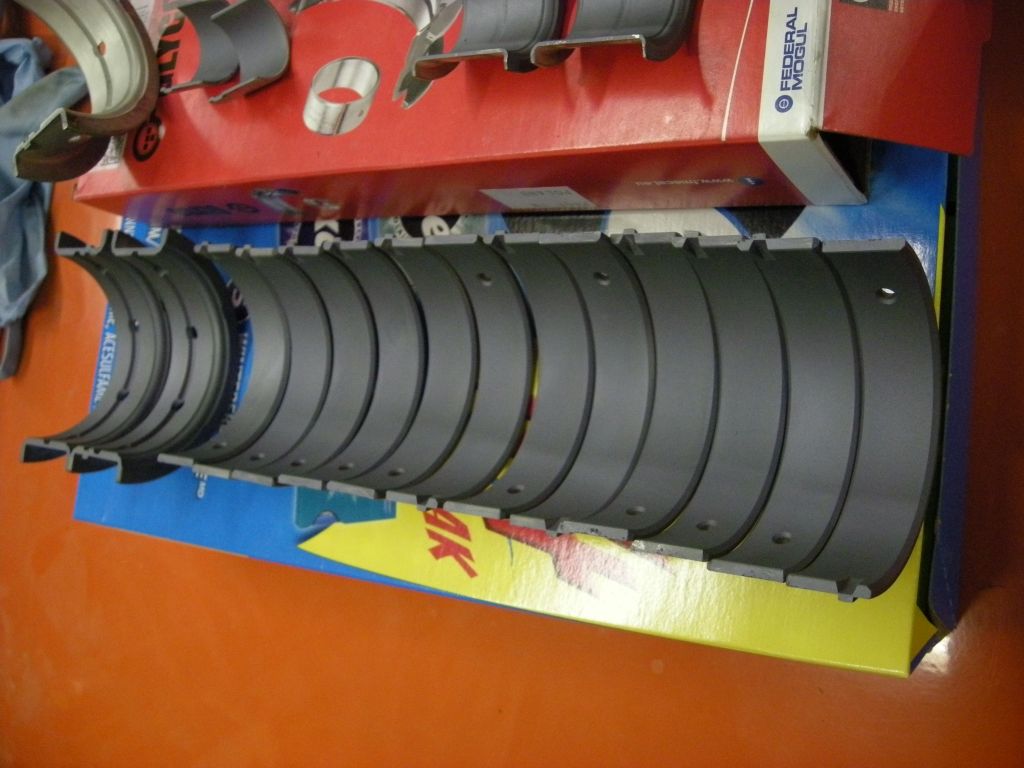

They look good and the baked surface is stable, the thrusts have been polished with a soft cloth and only a trace of the DFL came off.
I can't measure a dimension change, instructions say .0002

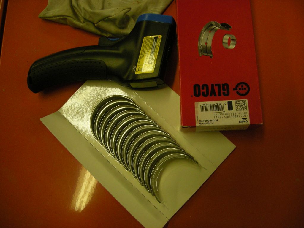

Anyways tomorrows project, new rod bearings (IMG:style_emoticons/default/bye1.gif)
