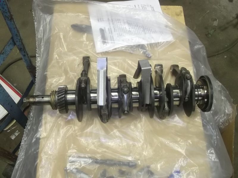

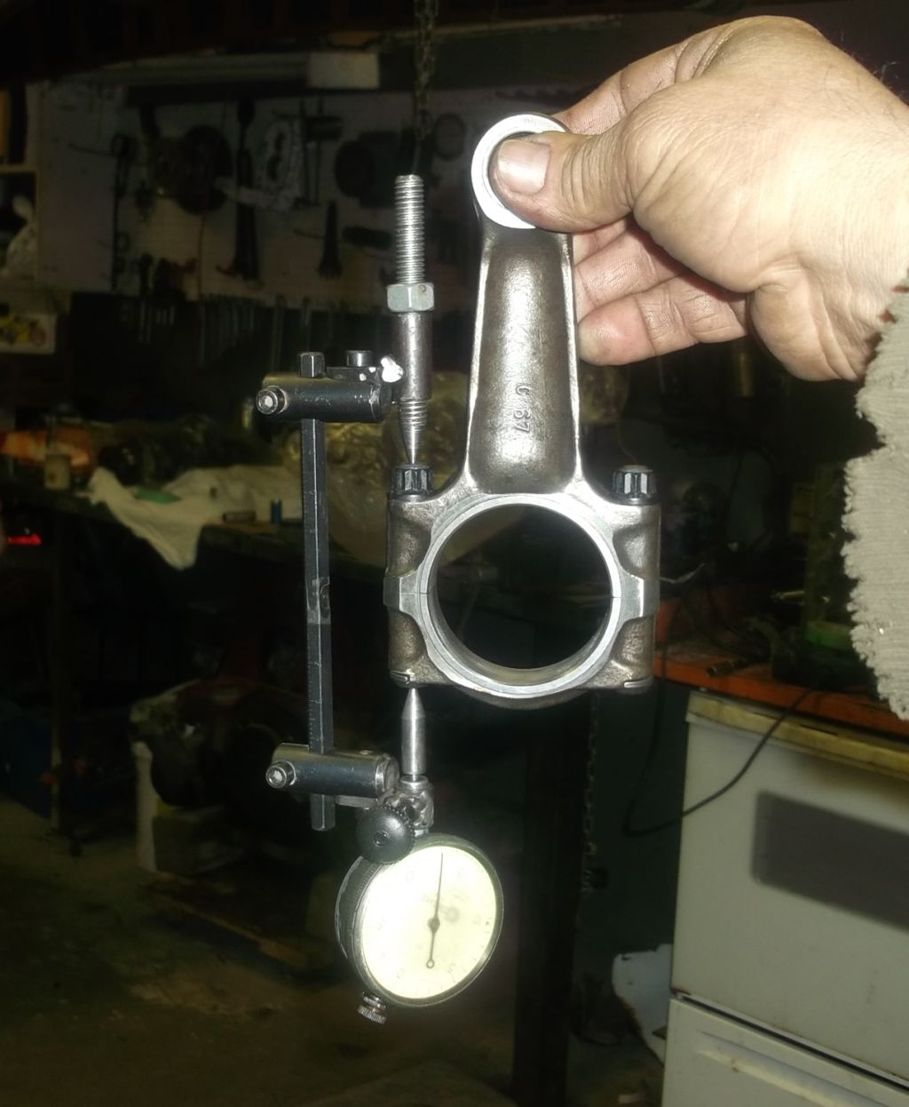

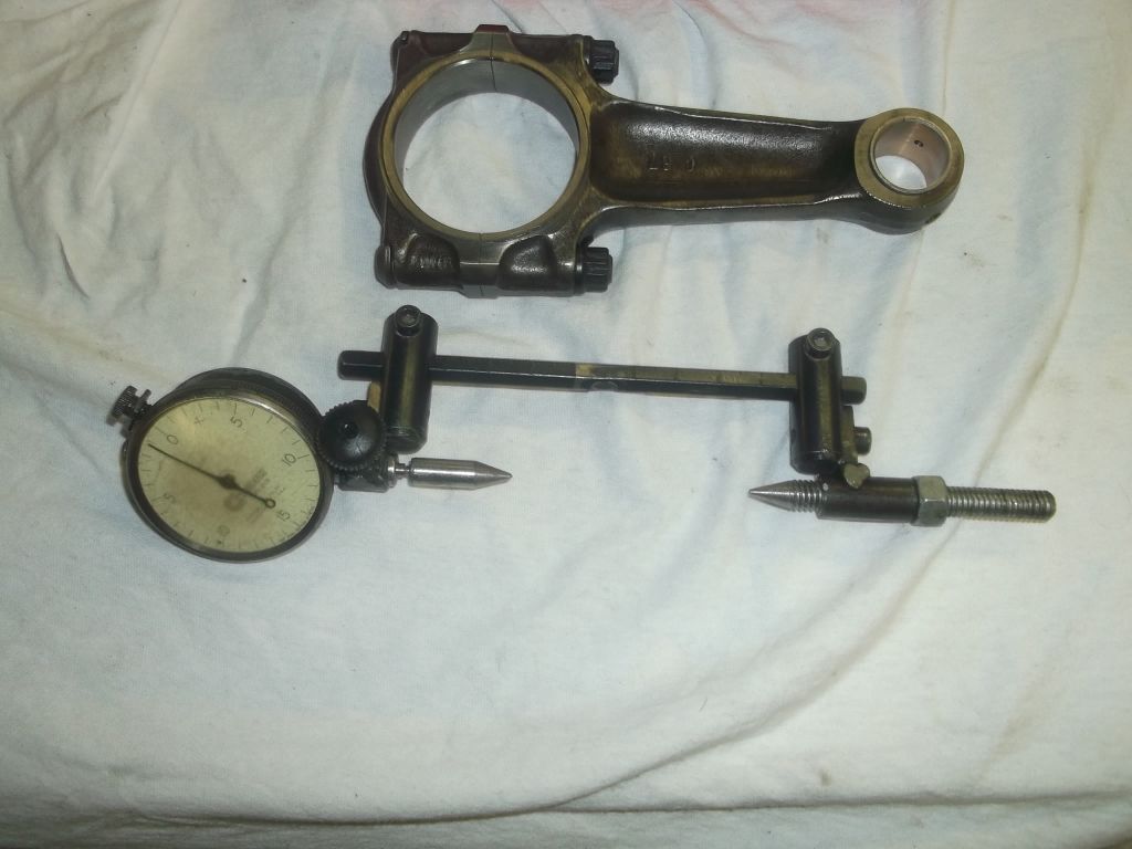

Bolt stretch gauge for the ARP bolts. Homemade of course.... (IMG:style_emoticons/default/biggrin.gif)
With ARP bolts you can torque them, but the recommended (for 3.0 rod bolts) is measuring for .010" of stretch.
Note I checked them with a torque wrench, the ARP recommended torque was .010 stretch.
So i wouldn't be afraid to use the torque if one didn't have a strech gauge.

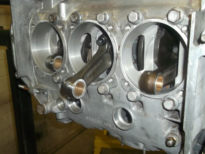

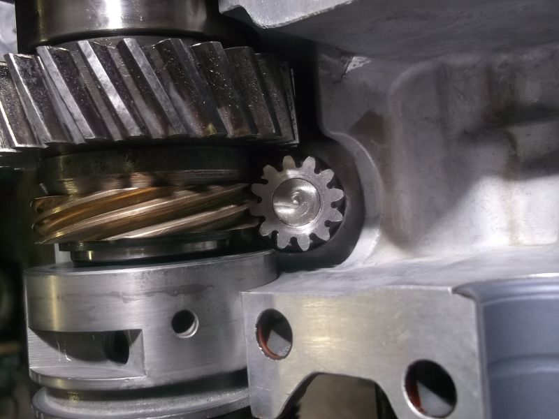

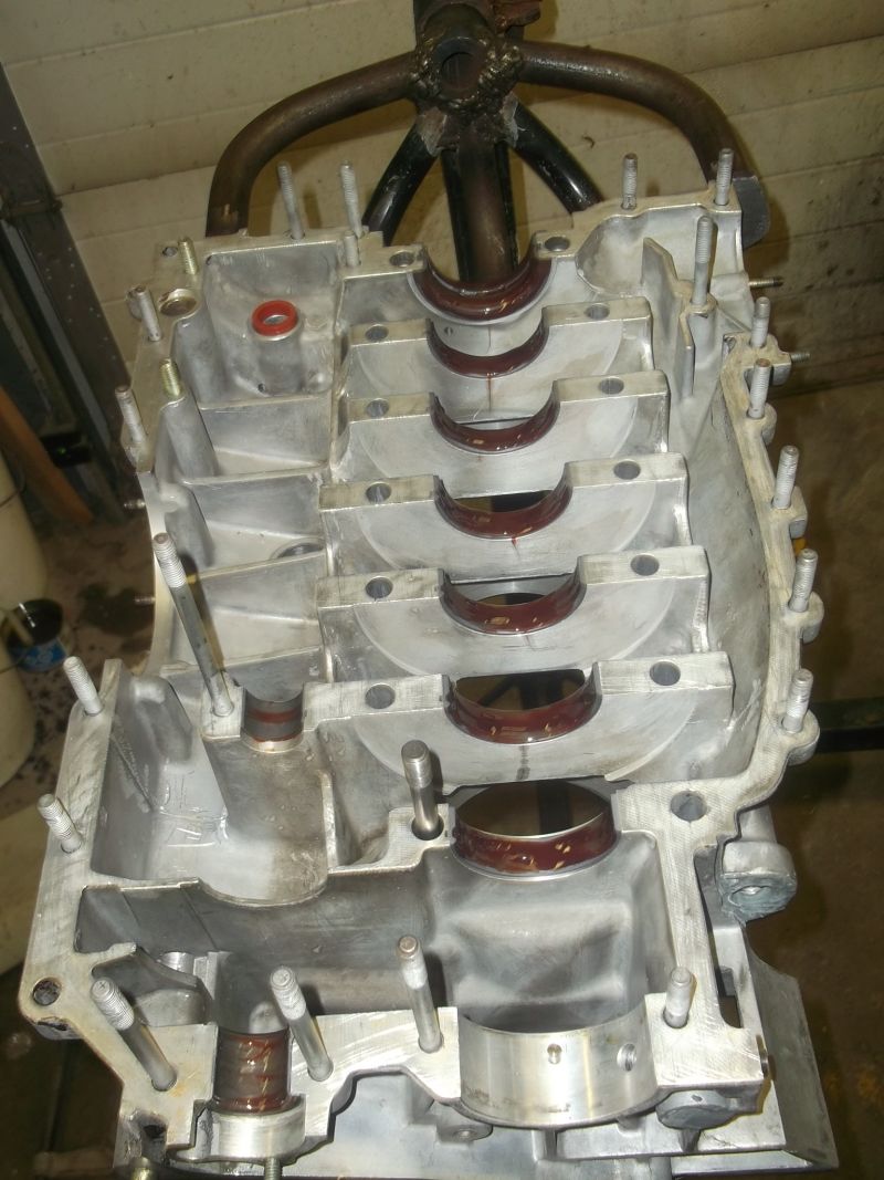

Had to do a quick check to make sure there was no issues with my crank gear change, I'm going from a CCW dizzy to a CW dizzy and I'm using a 2.7 dizzy crank drive gear.
I've be told a 3.2 gear is slightly a different size and can cause issue, but this one seems to work just fine, not to tight or too sloppy.
Altough I took this gear off my 2.7 crank it is the same gear as on a type1 or type four engine. It even had a VW logo stamped on it. (IMG:style_emoticons/default/shades.gif)
BTW this was before I totally cleaned the crank and for this check I didn't care about the orientation of the #8 bearing..

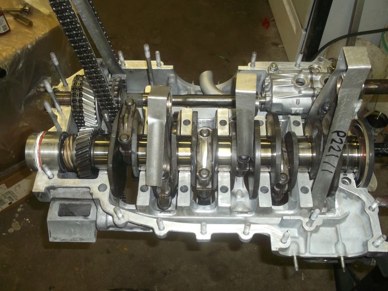

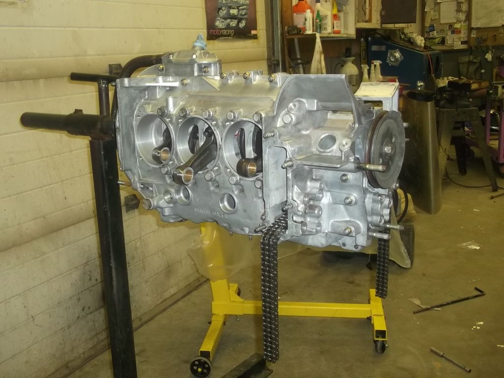

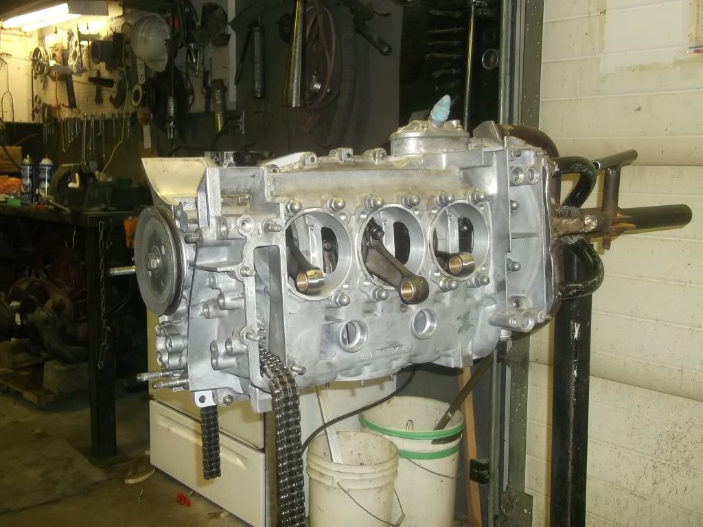

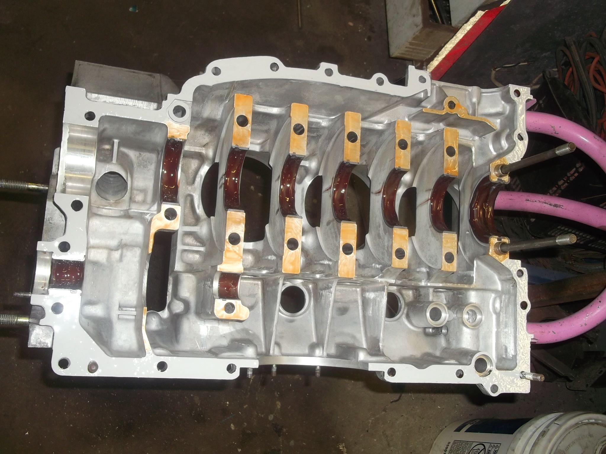

Major progress today...I'm beat.... need (IMG:style_emoticons/default/yellowsleep[1].gif)
Mark Henry
post Mar 22 2014, 10:53 PM
Post #204
that's what I do!
Posts: 20,065
Joined: 27-December 02
From: Port Hope, Ontario
Member No.: 26
Sorry I couldn't do a better set of pic's on the build up, but once you lay down the sealants you only have maximum of 45 minutes till the case has to be torqued.
But.... (IMG:style_emoticons/default/w00t.gif) (IMG:style_emoticons/default/smilie_pokal.gif)

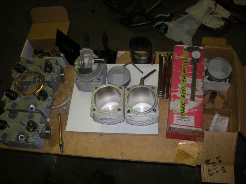

Time to start thinking about the next phase (IMG:style_emoticons/default/smile.gif)
Pistons, new Mahle, 3.0 RSR, Goetze rings
Cylinders, stock 3.0 nickasil, replated Milenium/LN engineering.
I'll still have to DFL coat the skirts, and ceramic coated tops,
I'm not sure where these originally came from, guessing they may be leftovers from a racing program. They also might be 2nd's as they were a hair under size for stock 3.0 jugs. That issue was fixed in the replating spec.

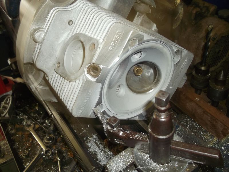

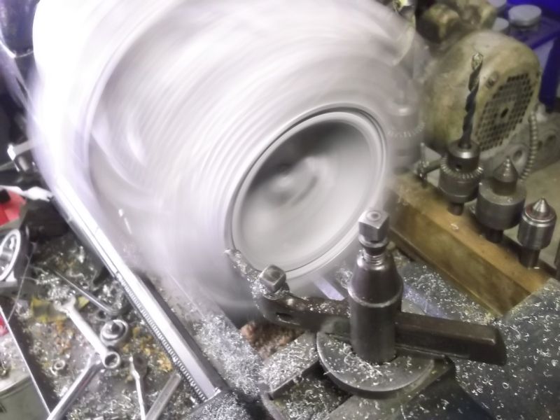

I did get some more headwork done.
Took me a while to get my head surfacing jig sorted but in the end it worked real good.

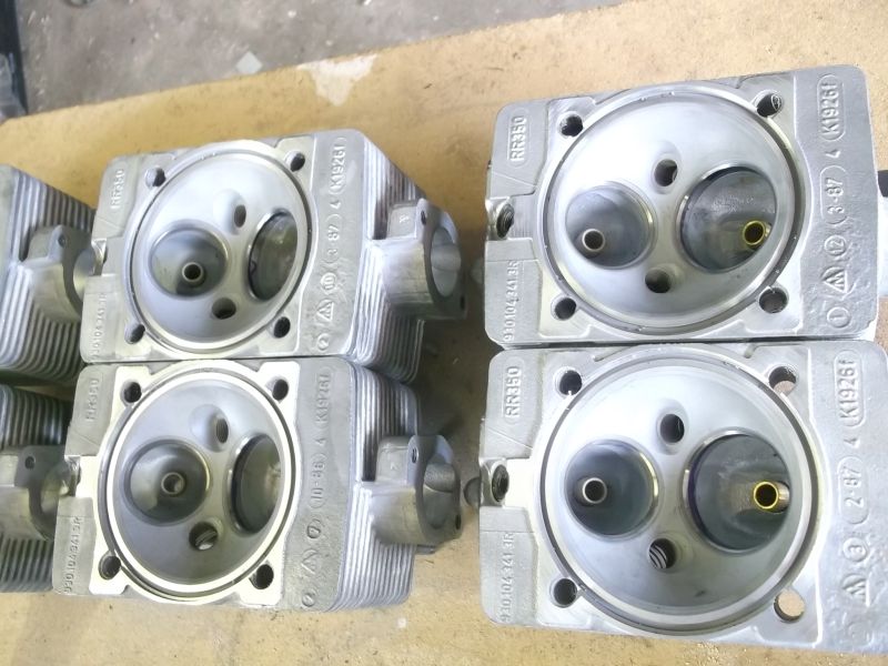

What are you doing for intake port sizes? Are you going to run carbs?
Stock '79 big port heads and I cleaned up the the guide bosses and polished the ports, new valves (sodium exhausts) Eibach springs and ceramic coated chambers and exhaust ports. Oh yeh... and machined for twinplug.
Yes, Carbs.

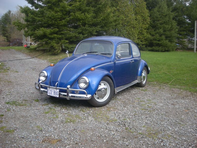

A '67 on a late pan...the stance is really nice. You finished it?
Mark Henry
post Jun 20 2014, 07:21 AM
Post #215
that's what I do!
Posts: 20,065
Member No.: 26
QUOTE(Chris H. @ Jun 19 2014, 06:31 PM) *
http://www.914world.com/bbs2/index.php?sho...p;#entry2052404

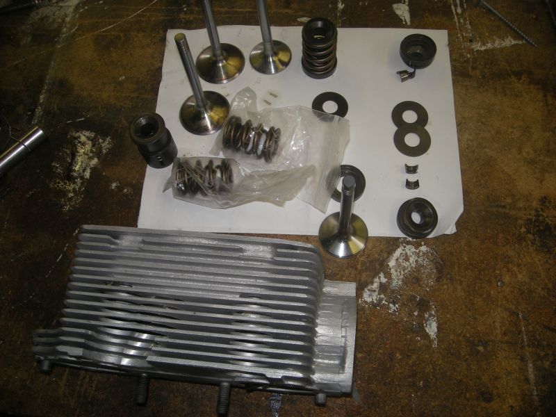

Too much life in the way so progress is slower than hoped, but progress never the less.
Heads done, mild P&P, new valves, guides including a trimming the tops and Eibach springs.
P206 spring setting tool (far left) made life easy.
