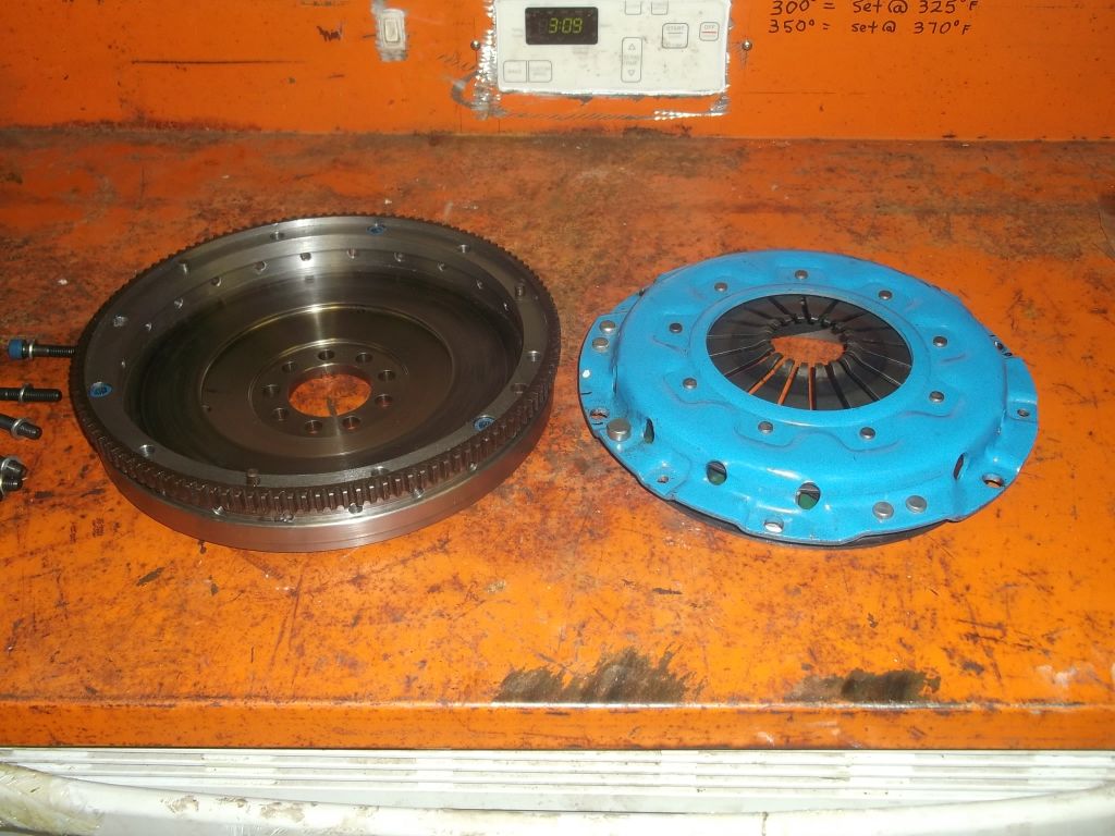

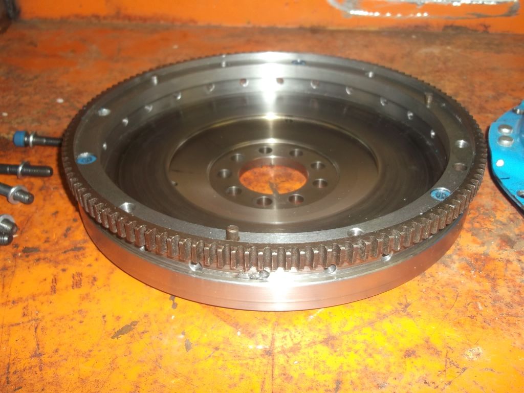

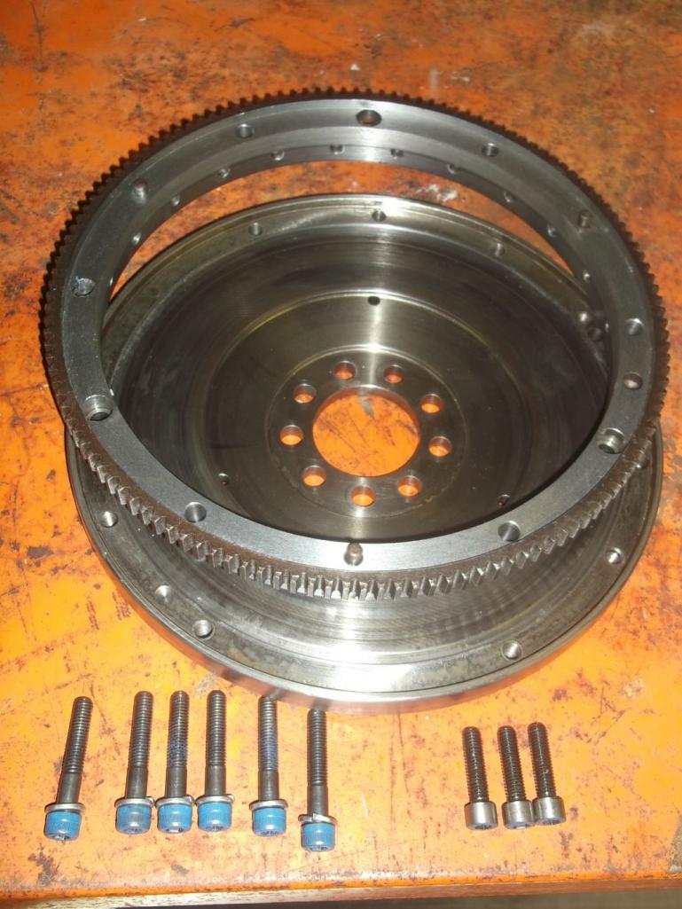

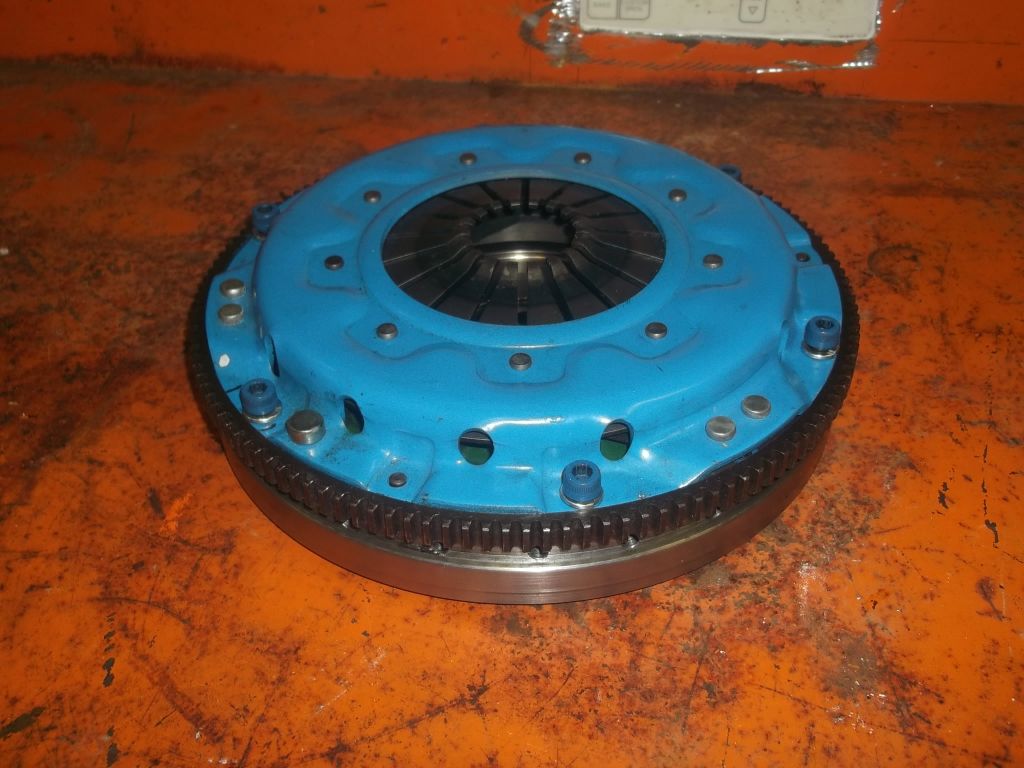

I'm getting my "poop in a group" to take the assembly to the balancer.
Someone was asking about my flywheel so here's the pic's
Mark Henry
post Feb 8 2014, 02:34 PM
Post #51
that's what I do!
Posts: 20,065
Joined: 27-December 02
From: Port Hope, Ontario
Member No.: 26

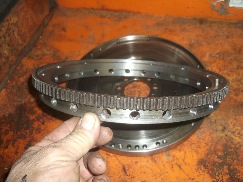

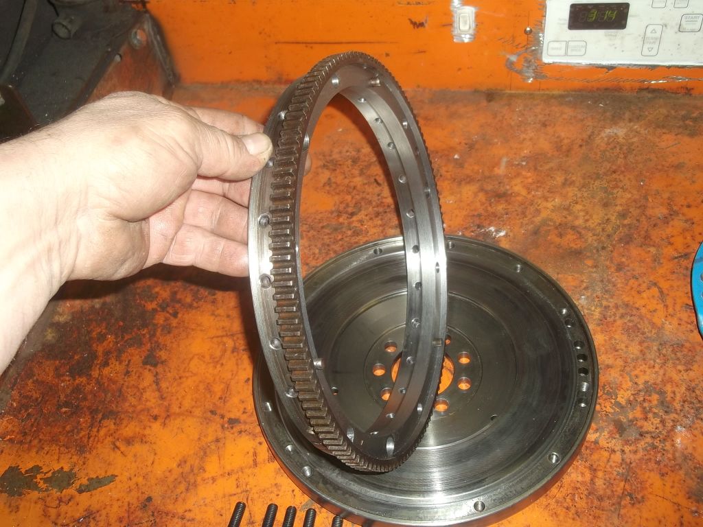

The ring was made from a type 1 VW beetle flywheel.
The flywheel was lightened a bit, the holes were really just added for drainage/dust. Stock /4 flys have 6 holes, so I went a bit overboard, it "may" have taken a hair of weight off. Before I drilled the holes the ring and flywheel weighed just under 14lbs, about the same as a stock /4.
The pressure plate is a CSP HD performance type 4 vanagon 228mm.
No I will not make you one, not worth it to me to sell these. the VW and Porsche flywheels are hard as hell, this was tough going.

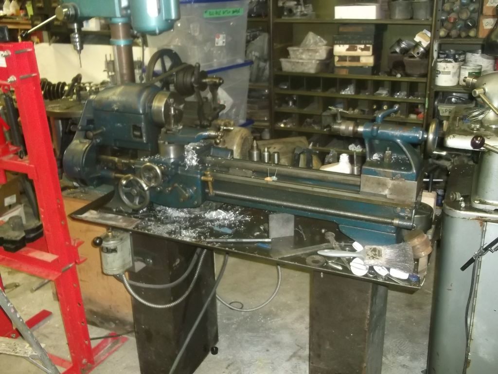

Believe it or not this was made on my 1942 Montgomery Ward (Logan) lathe.
It's a 10"X 36" that's been modified with 2-1/2" risers, basically turning it into a 13" swing.
A PO did the mod and re-geared it, the feed works like normal.

Can you weigh the flywheel w/ adapter as well as the whole flywheel clutch package? I'm interested in comparing a few as time goes on.
MrHyde
post Feb 8 2014, 05:12 PM
Post #55
Posts: 525
Joined: 13-October 10
From: Ontario, Canada
Member No.: 12,268
Nice Lathe ! When did you get that !

QUOTE(MrHyde @ Feb 8 2014, 06:12 PM) *
A couple of weeks after the clinic (IMG:style_emoticons/default/biggrin.gif)

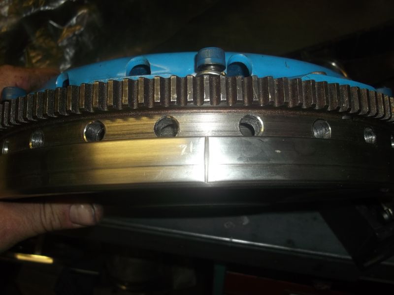

Decided to make my adapter ring holes a little bigger. (IMG:style_emoticons/default/confused24.gif)
Mark Henry
post Feb 9 2014, 10:27 PM
Post #60
that's what I do!
Posts: 20,065
Member No.: 26

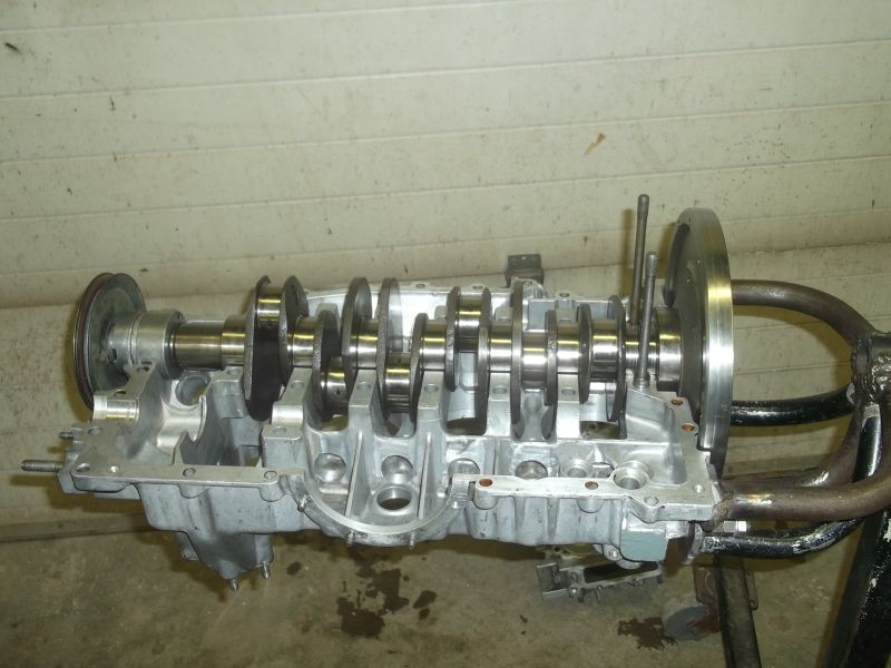

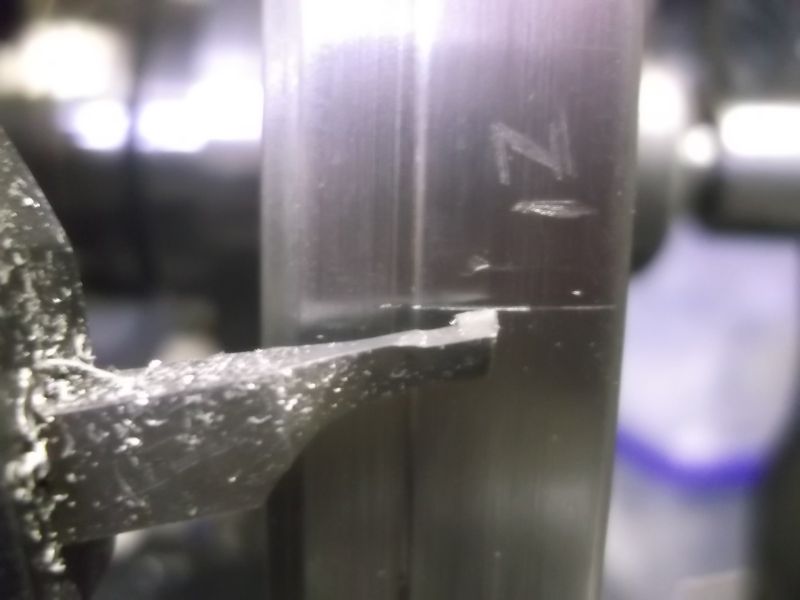

Also decided that I should also mark the flywheel so I can see the timing/valve adjusting marks through the bottom peephole. I had to put the marks 180 out so the read from the bottom, it was easiest just to put the crank in the case for marking.
I started doing the lines on the lathe, but they were to fine so I took a file to them.
