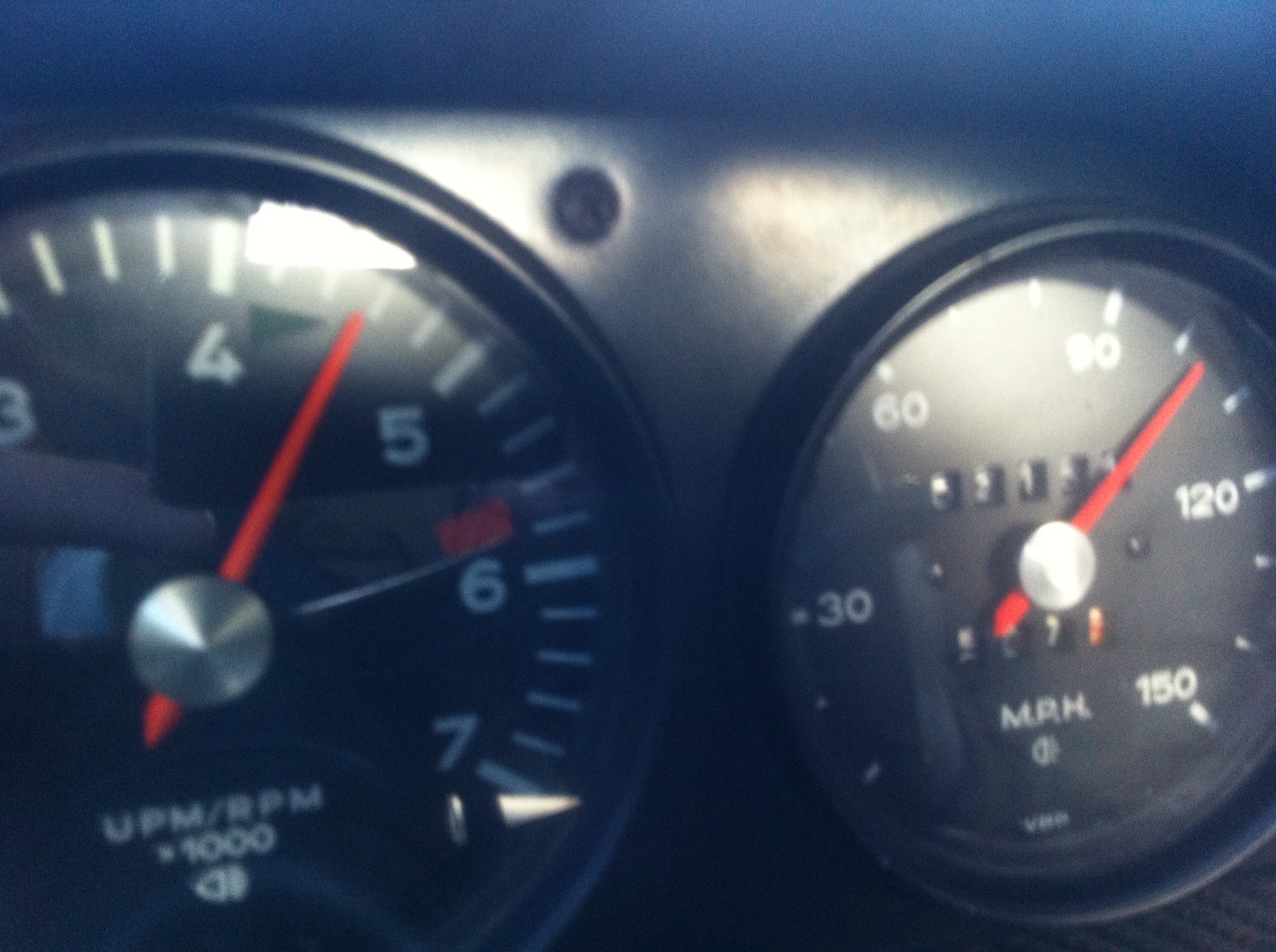

My 914 is running a 1.8 (ish!) 40 Dellortos and recently recorded 111BHP and 121lbft of torque after a carb set up so yesterday I went to have a little thrash about.
A couple of times when the traffic cleared I really kept my foot flat down and pushed to over 100MPH on a slight uphill. It was still pulling strongly for a few seconds then seemed to lose power and splutter slightly. I backed off and it returned to normal. It seemed like the carbs emptied as if the fuel pump couldn't keep up. I had the heater on and the rich oily aroma changed to a hot sharp smell like it suddenly ran lean. It's running the small square facet pump mounted up front near the master cylinder.
Any ideas please
Thanks
DavidAttached Image
