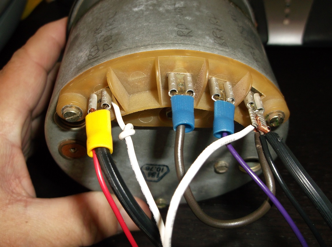

I wired it like this:
The white wires are from a 12v DC transformer, used to bench test it. The Positive is on the left, and the negative is on the right. The Autometer module is wired to the same positive and negative lugs, and the purple wire from the Autometer is connected to the speedo input. The other speedo input is jumped to ground.
Running the calibration procedure in a bench test, found here , I was able to get the speedo to read exactly 80 mph, and the odometer was working too.
The next step is to test it in a vehicle.
The heavy wires from the positive and negative go to an old cigarette lighter plug that I will use to test it in my truck, comparing the output with the truck's speedo, and my android app "gps speedometer".

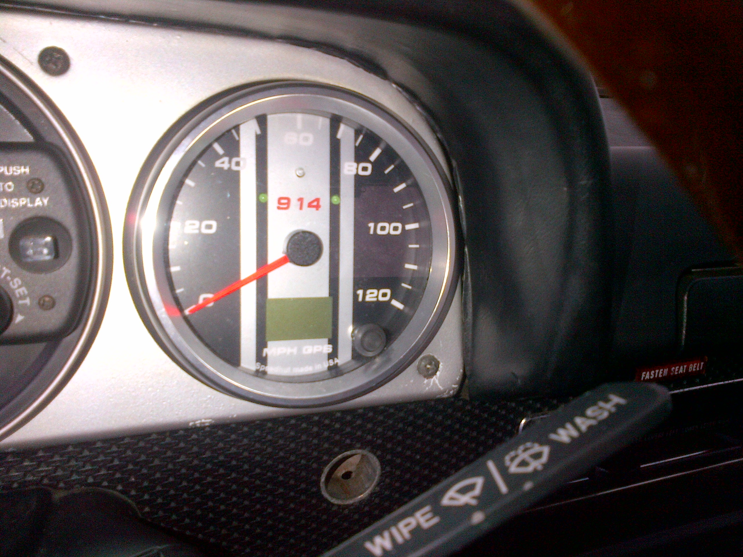

ClayPerrine   Just an update on this project. I got it all hook...   Mar 4 2014, 05:26 PM

rick 918-S   :ttiwwp: Let's see it in the dash. Can you ...   Aug 14 2024, 11:21 AM
ClayPerrine   I will have to hunt one down. Right now my dash i...   Aug 15 2024, 02:59 PM
ClayPerrine   This is before I sent the speedo out to have it re...   Aug 15 2024, 03:04 PM
ClayPerrine   And this is the speedo today. I just took it 5 min...   Aug 15 2024, 03:13 PM
rick 918-S   Nice!   Aug 16 2024, 05:42 AM
