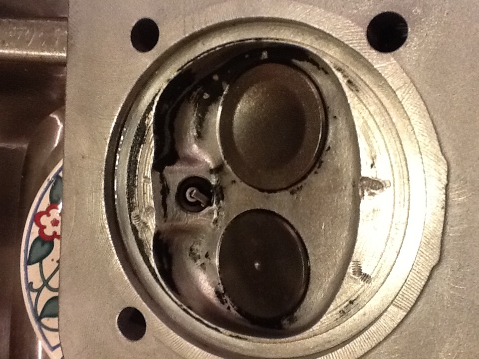

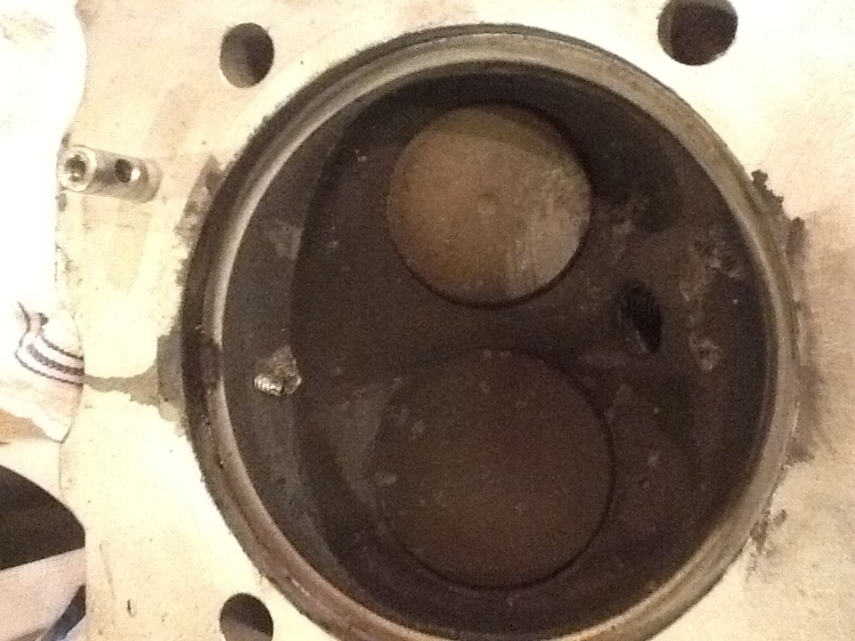

Sorry I guess I was not clear. But it was not happening before I installed the SS lines. But I also had to pull the heads to retrieve a part that fell in the intake. Another long story.
Banged around a bit but good compression afterwards and the valves seemed fine. Did not mess with the dizzy. It is the same as before.
So I have to think it has something to do with the fuel lines. I am betting I swapped the lines around

Yep, a sheet metal screw was eaten. You'll make that mistake once.
