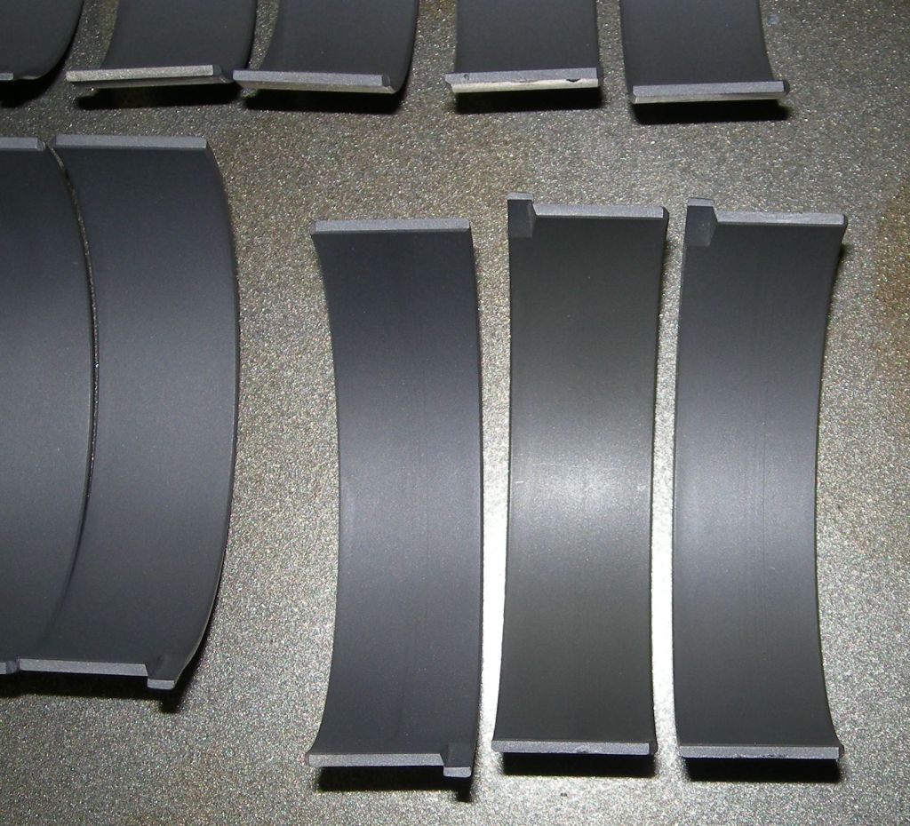

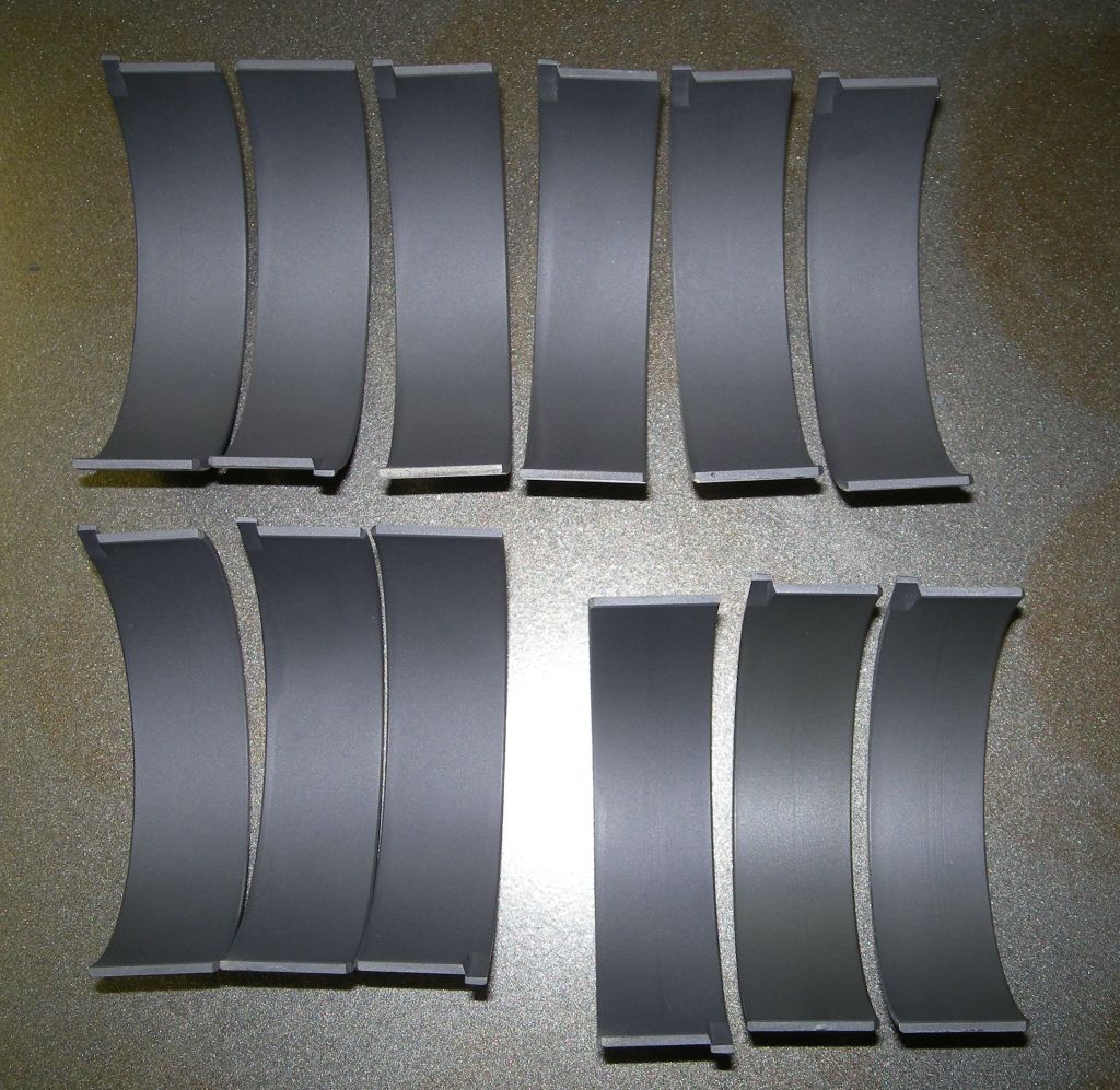

Reprocessed #8 bearings, two are 3.0- and one is a 2.0-2.7
One of the 3.0 was within spec, but IMO a hair loose, the DFL slightly tightened up the tolerance. The DFL at the most adds .0005 (0.01mm) and this can reduced by polishing with a soft cloth. This takes a quite while to do, but is safer than using a green scotch bright pad.
Top set of rod bearings are used 3.2 and the middle set are used 2.7

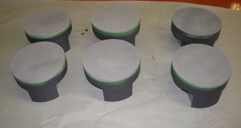

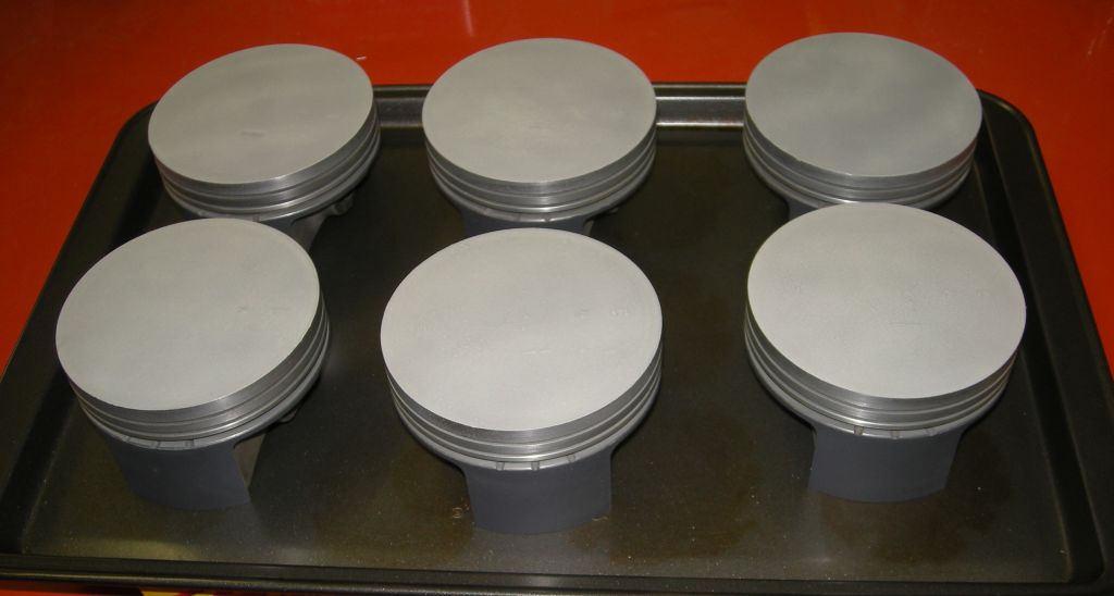

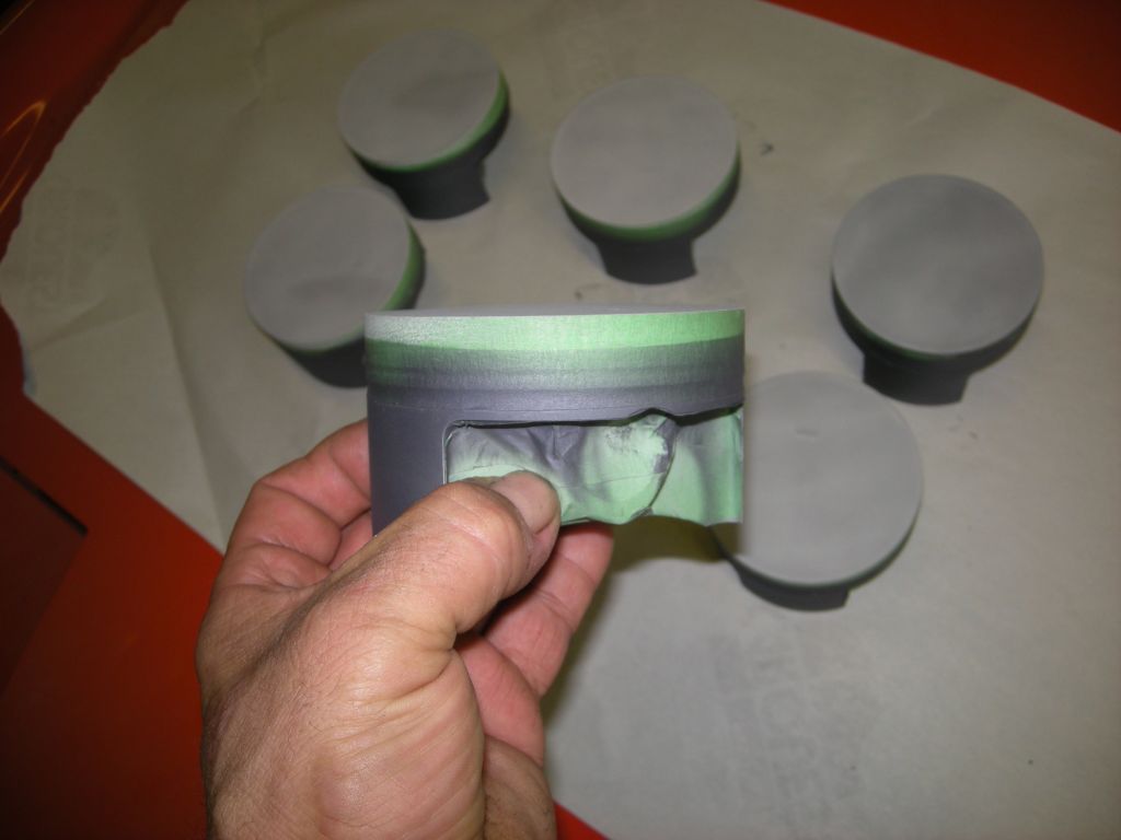

Pistons with DFL skirts and ceramic tops.
Theses have a fair bit of prep labour.

I s sort of like powder coating but you don't need the electrical charge on the part. It is a baked finish.
It can increase the tolerance slightly, but by burnishing you can make it very sight.
It won't eliminate piston slap from a part with excessive tolerances, It will help the skirt slip in the bore better.
The coatings, besides being a dry film lube, wick the oil or grease to the face of it's surface.
