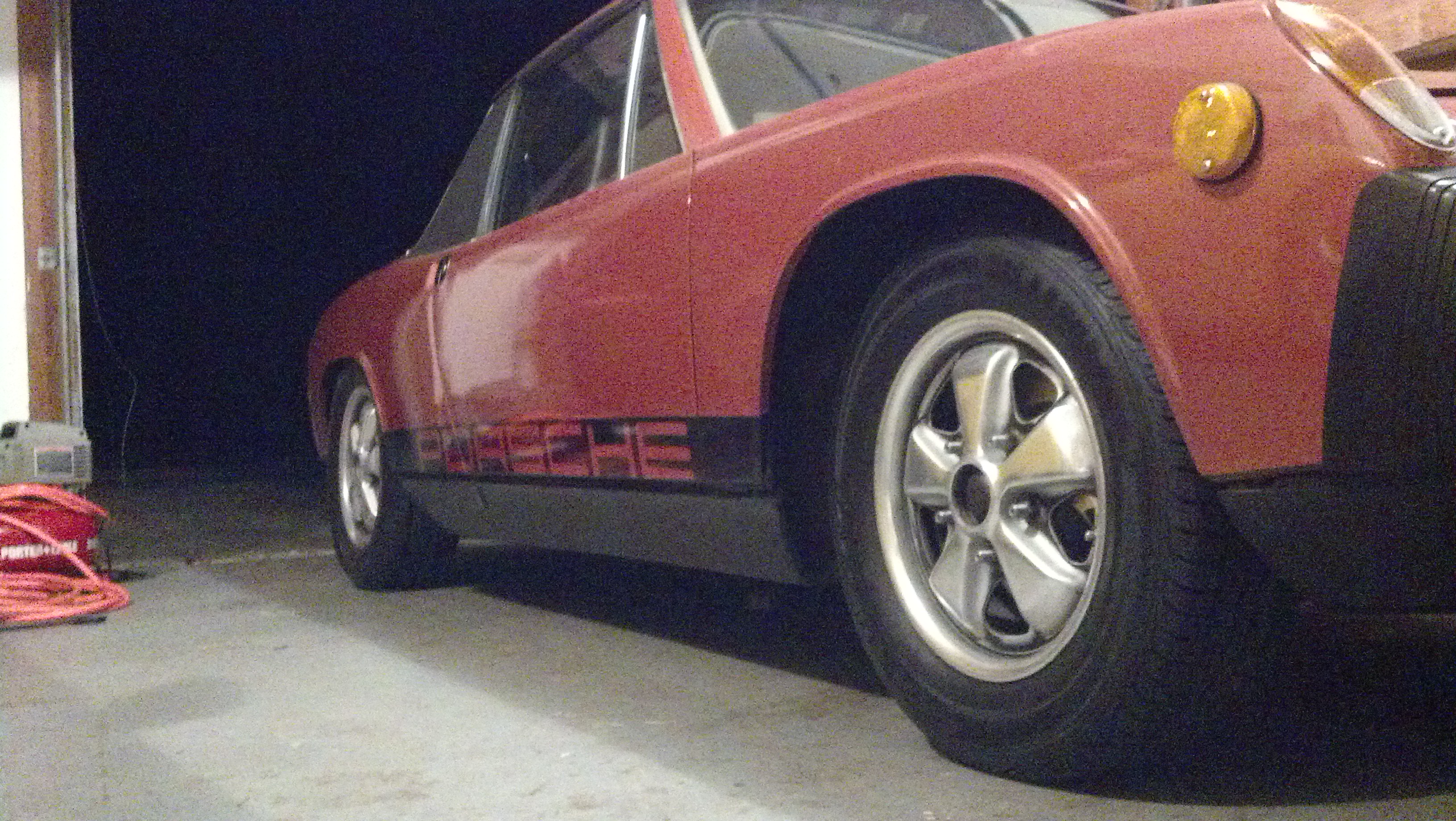

Finally took a picture. Pretty close to stock. When I do the new a-arms and tie rods I will look at dropping the front just a 1/2" maybe but for now I will leave it as is.
mittelmotor
post Mar 24 2014, 10:06 AM
Posts: 334
Joined: 21-May 12
From: SoCal
Member No.: 14,464
QUOTE(Philip W. @ Mar 24 2014, 08:51 AM) *
Good strategy. A 0.5-in. front drop will look perfect. (IMG:style_emoticons/default/beerchug.gif)
Chris H.
post Mar 24 2014, 10:55 AM
Posts: 4,069
Joined: 2-January 03
From: Chicago 'burbs
Member No.: 73
(IMG:style_emoticons/default/agree.gif) Looks fine as is but you can level it easily. As mentioned before if you do it yourself count the turns on the adjuster screws, do them evenly, and do one turn at a time and "bounce" the front shocks a bit then drive it around before you do the next turn. I got mine a little too low up front at first.
Lowering it 1/2" probably won't cause bump steer. Mine came down a lot more than that.
