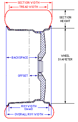

So using the attached pic as a reference and trying to just think about this as simplistic as I can is this logic sound? All I really care about is my current 928 backspace which is 111mm and add my spacer which is 23mm for a total of 134mm. At that measurement all is well on the inner side AND can I assume because their both 7" rims that the outer is as well?
So, my simple mind is telling me this is my bench for what fits.
That being said is I take the 944 wheel and use the backspace of 138 well shoot, don't I just need 4mm spacers and I'm good to go?
Dave

QUOTE(Downerman @ Mar 26 2014, 07:16 PM) *
Dave
I don't like to deal with backspace, people measure it wrong and it depends on rim
material thickness. I use the offset values, which are definitely available with the
part numbers you gave.
928 7x16 ET65 with 23mm spacer is equivalent to 65-23=42mm offset.
According to my chart, that 944 rim is 23mm offset. There is nothing you can
do with spacers to make that equal to the 928 wheel you have. It is already
farther outward by 3/4".
Mark S.
