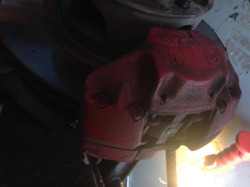

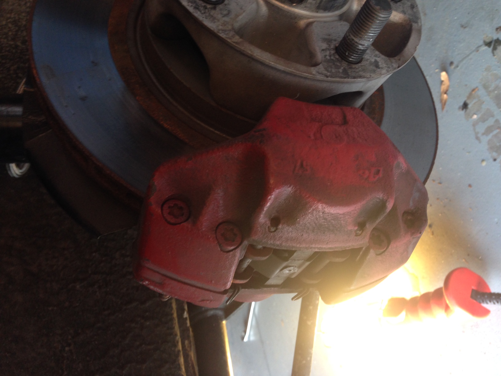

Also, does anyone know what these front calipers I have are? Dumb Ass PO (scotty boy) said they were '73 911 A calipers. According to the PMB website A calipers weren't around until the late 70's. Either he got the date wrong or the model of caliper wrong.
Either way it'd be cool to know so I can order pads for them.

Those look like "M' calipers.

QUOTE(bulitt @ Apr 4 2014, 07:04 PM) *
Awesome, thanks for the info!

" M " calipers have about a 3 inch center to center bolt mount pattern , " A s" have about a 3 1/2 inch bolt pattern. Ms will work fine for a -4 , heck I believe that - 6s originally came with "Ms" up front .Get er goin !!!! (IMG:style_emoticons/default/piratenanner.gif)

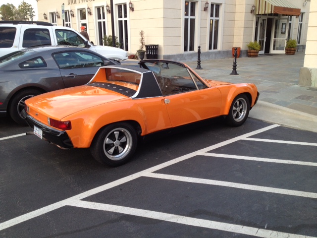

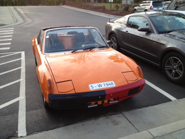

Looks like you made it to Lafayette Village tonight!
Minus the decals...

Ha! Yup that was me! Ever since we've had this nice weather I've been driving it everywhere just to get a feel for what it needs.
I was sitting outside at the first 4-person table at Driftwood with my girlfriend and some friends. I wish I'd have known you were there. Would've loved to give you a tour of the rust....some of it is pretty epic. There's floor patch panels that are just affixed on with black goo and move about when you touch em...and that's just the beginning!
Also would've been great for you to ride along and tell if some of the things I'm experiencing are normal, since this is my first 914.
