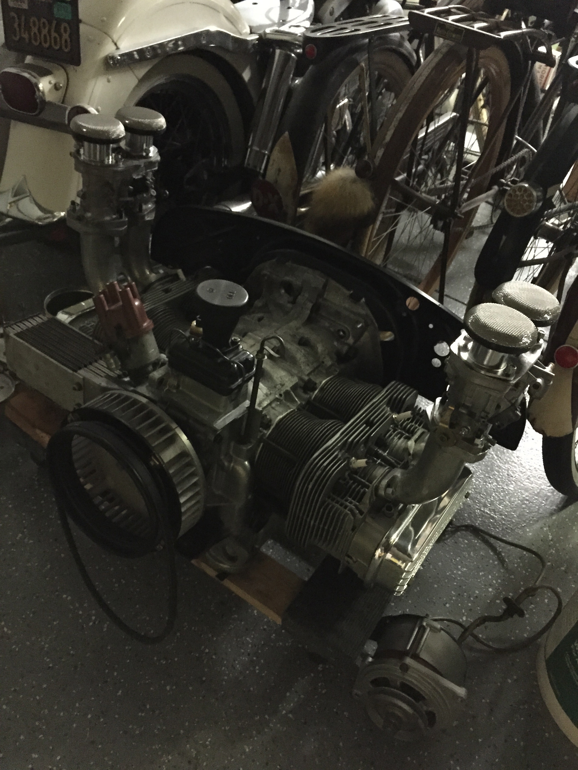

Building a new engine…...Attached Image

Cool, You'll like it from what you were running before. I did a 2056 in my 72 with 44 webers (IMG:style_emoticons/default/aktion035.gif)

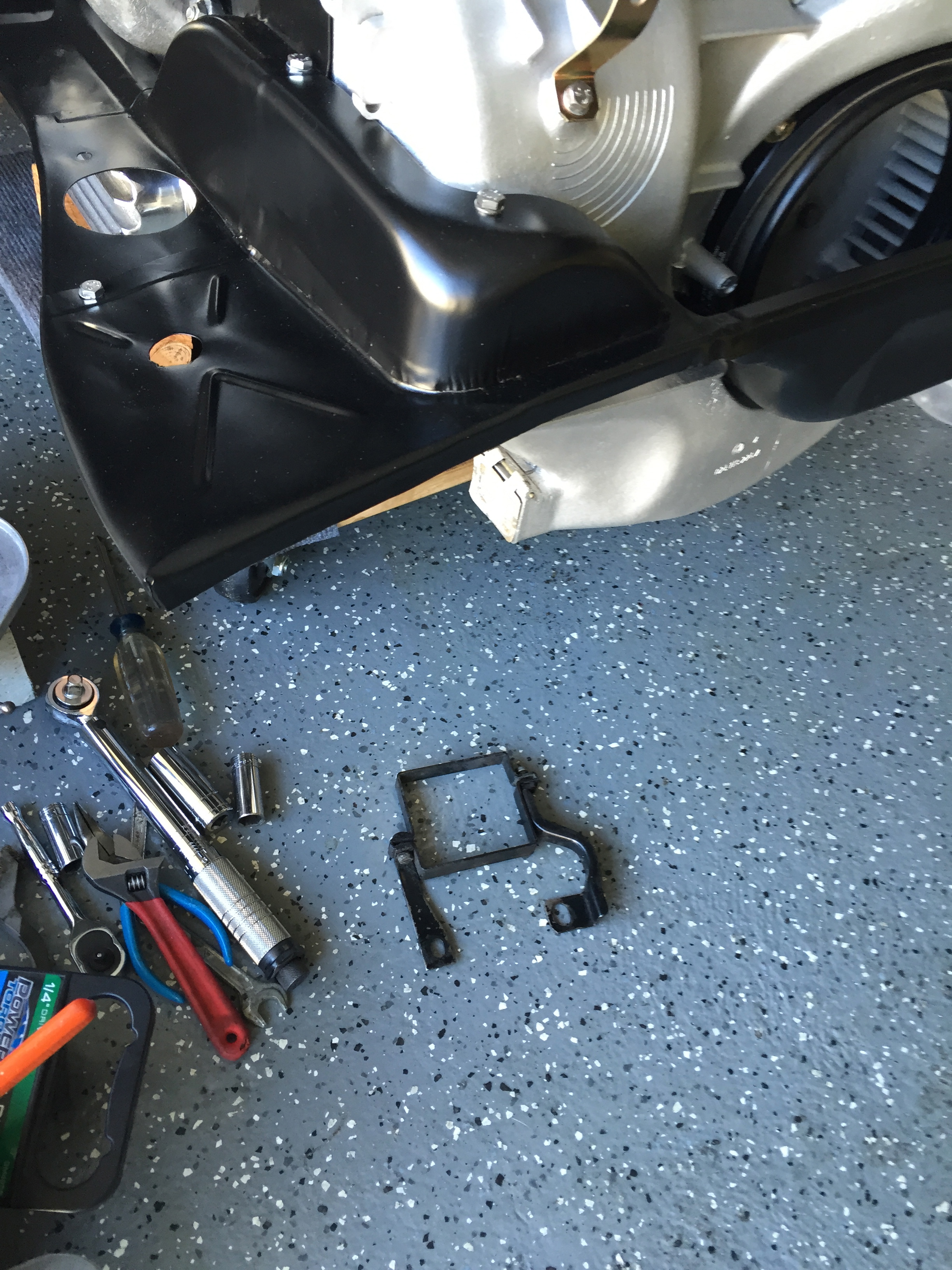

Constructed my engine and put the tin on and……

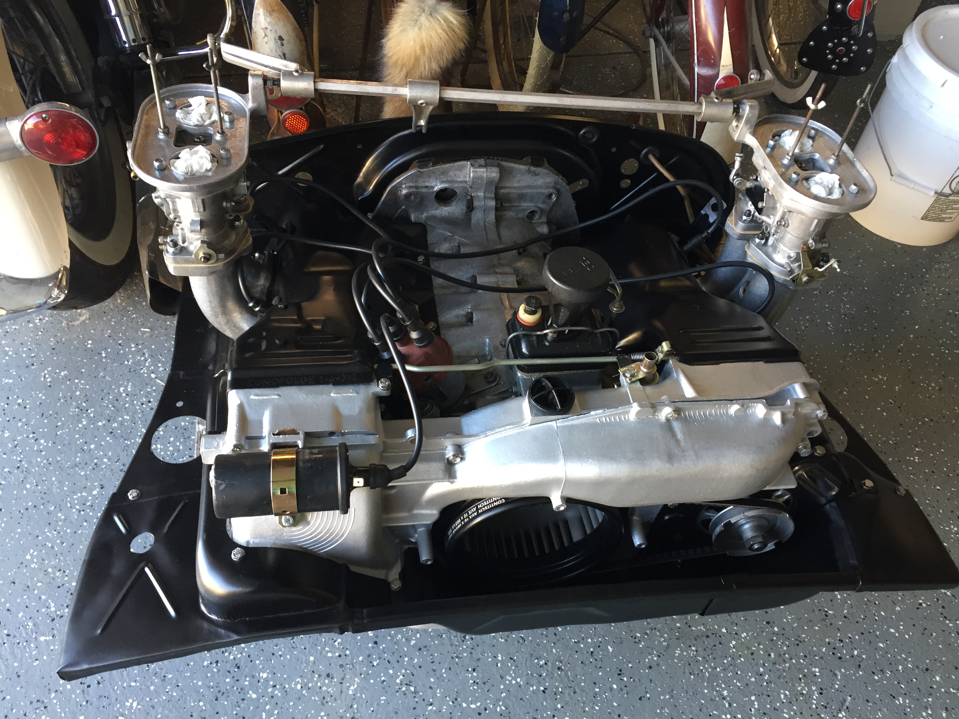

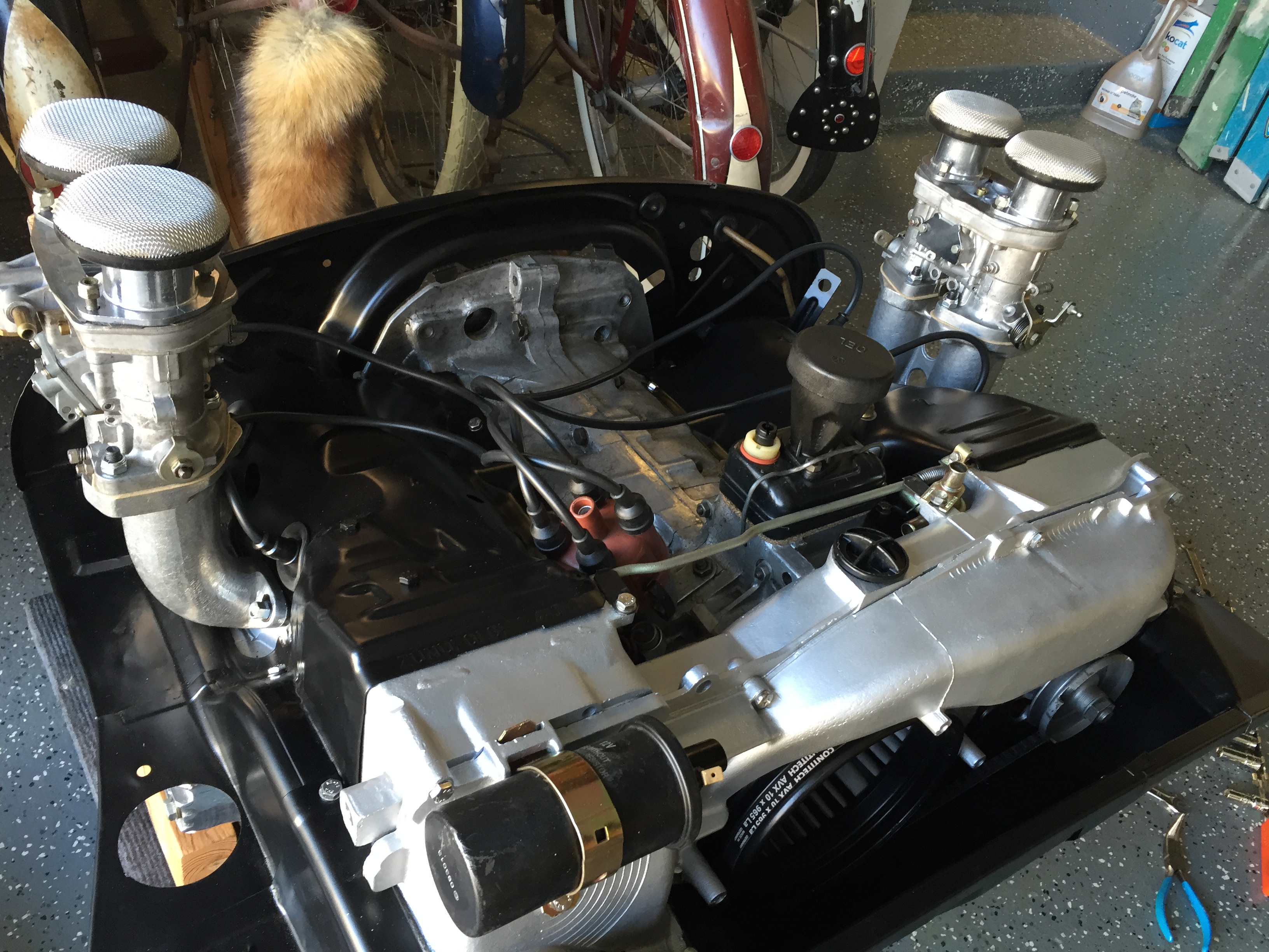

I think I have it figured out now…..

QUOTE(Larmo63 @ Jan 21 2015, 10:38 PM) *
OT but any pics of the Harley? Looks like black plates. Must be old n cool.

QUOTE(Larmo63 @ Jan 24 2015, 07:33 PM) *
Lawrence
Nice!

QUOTE(Larmo63 @ Jan 24 2015, 04:32 PM) *
Did you get the oil cooler support on without taking the tin back off?
--DD

Larmo63
post Jan 25 2015, 12:23 AM
Post #115
Posts: 4,267
Joined: 3-March 14
From: San Clemente, Ca
Member No.: 17,068
Left side tin came back off. Bracket on.
Why doesn't my back tin fit down snugly on the bell housing? Are there two different styles? The two clips that are supposed to "clip" onto it are sitting proud of it now. Weird.
