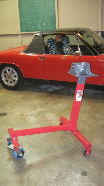

> Factory style Porsche/ VW engine stand adapter yoke GB deadline looming, Ending soon on Pelican
warpig
post Apr 17 2014, 07:24 PM
Posts: 290
Joined: 2-August 10
From: Portland OR
Member No.: 12,002
Trying to get to 20 units for the best discount. Currently at 11 sold (4/17/14)
$158 plus shipping.
Appears to be a high quality item. I asked the vender to extend the deadline so I could spread the word to my 914 World bretheren, and he agreed. (IMG:style_emoticons/default/piratenanner.gif)
Not sure for how long though.
I have mine ordered already. (IMG:style_emoticons/default/evilgrin.gif)
No, you can't borrow it. (IMG:style_emoticons/default/sheeplove.gif)
Pelican thread: http://forums.pelicanparts.com/porsche-911...ng-fixture.html
Vendors Evil bay ad: http://www.ebay.com/itm/Porsche-356-911-91...7071045?vxp=mtr
