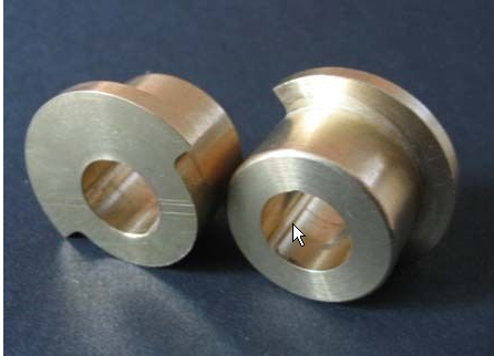

Next up is a set of urethane and they fit much tighter but the pin still floats around in the holes which appear to be oval shaped? Not sure if I would like that play due to the pin floating in the oval shaped holes. (IMG:style_emoticons/default/blink.gif)
I saw a set of solid brass bushings, these look interesting. (IMG:style_emoticons/default/shades.gif)
Has any one used them? (IMG:style_emoticons/default/idea.gif)
Are the pivot holes supposed to be oval shaped with slop around the pivot pin? (IMG:style_emoticons/default/idea.gif)
Any brand better than others? (IMG:style_emoticons/default/idea.gif)
There seems to be a lot of manufacturers out there and the prices go from $12 bucks to $40.00 for the brass ones. (IMG:style_emoticons/default/shades.gif)

Member No.: 8,162
I used the brass ones in my car. Works great, improved the shifting over the 1yr old graphite the car had in it. Haven't noticed any noise or vibration from them.

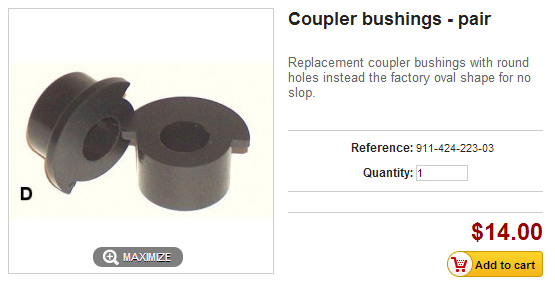

I spent some time on the phone this morning with Pelican Parts, they revamped their website and it too a while to dig up the part number for what I think it the poly bushing with the round hole.
I had no idea this would be so tricky. Guess so many Porsche's use the oval hole version and just the 914 did not making it a bit harder to locate.
If the one I get from Pelican is wrong I will order from Jwest thanks for the tip.

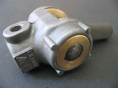

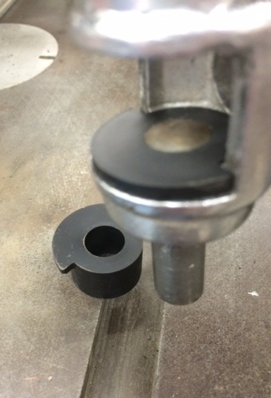

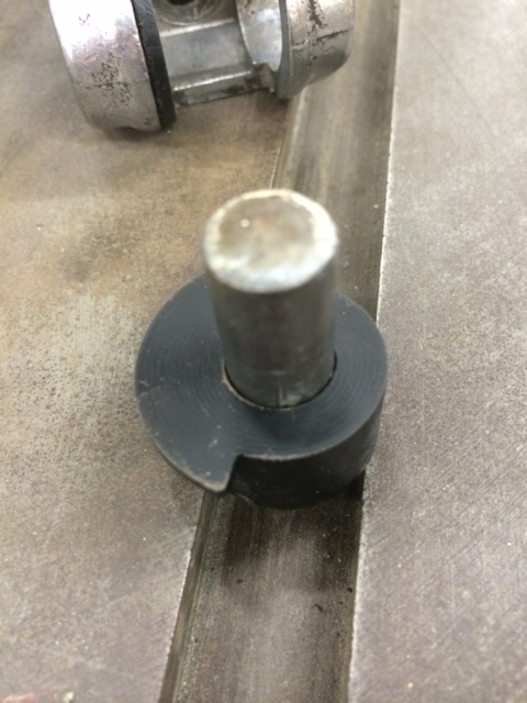

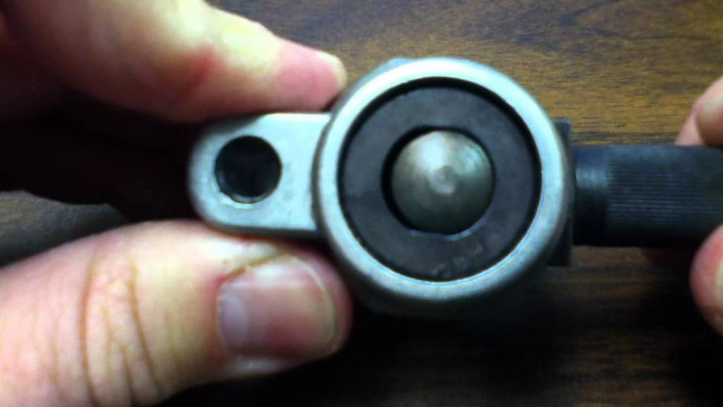

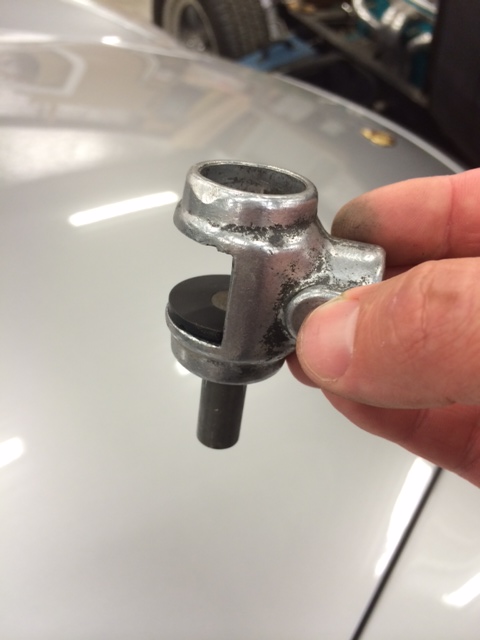

JWest
post May 1 2014, 07:57 PM
Posts: 1,663
Joined: 6-January 03
From: Fort Worth, TX
Member No.: 97
The ones I use are a tight fit on the pin, once assembled. When slipped onto the pin, they are a little loose, but the outside compresses in the coupler housing making a nice, tight fit on the pin. You can see the little gap in the pic with just the pin, then the tight fit (pin had to be pushed in and does not fall out when the bushing is in the coupler).

I am also considering the brass ones.
I think you will like the Pelican bushings. By the way they do come as a pair even though it says quantity 1.

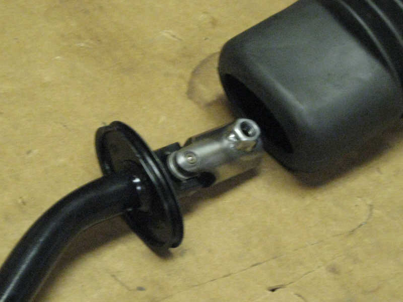

ChrisFoley
post May 2 2014, 06:41 AM
I am Tangerine Racing
Posts: 7,990
Joined: 29-January 03
From: Bolton, CT
Member No.: 209
The universal joint I use to replace the coupler attaches to the stock tunnel rod with a stock cone screw.
I also have a flange to hold the stock boot in place.
AFAIK, no other available upgrade offers those features. (IMG:style_emoticons/default/piratenanner.gif)
