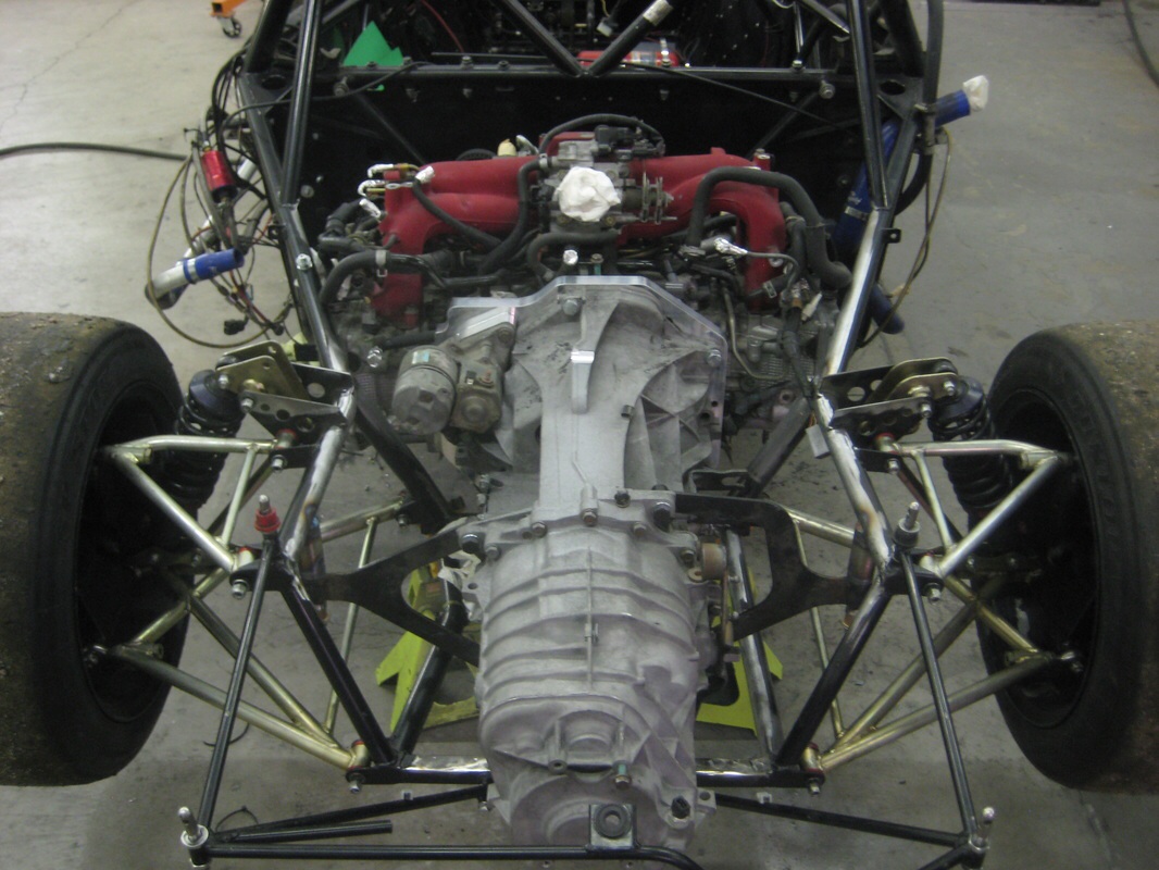

Guys,
In response to another thread about subarus, someone posted a link about a shop in AZ that is making an adapter plate kit to bolt up a boxster transmission to a Subaru motor.
Wondering if he sold a kit, or just did all the work, I reached out to him.
He does in fact sell a kit which requires milling out some of the bell housing, but then you can mount a starter.
Assuming much of the flywheel and clutch would not work, this might be a good place to start for someone who races, wants a more modern transmission, a cable shifter, and would like to remain all Porsche....
Naro...
Link to site for pricing etc.
http://www.boxsterengineconversion.com/par...ith-prices.html

r_towle   It's a flat plate of aluminum. Holes need to b...   May 10 2014, 07:12 PM
precisionchassis   It will only work with a Subaru engine and uses st...   May 12 2014, 10:56 AM
rick 918-S   That is really not hard to do. I made my adapter p...   May 12 2014, 10:01 PM

r_towle   And this seems really close. Boxster transmission ...   May 13 2014, 07:28 AM

ClayPerrine   Looking at the specs in PET and online, the Boxste...   May 13 2014, 12:33 PM

bulitt   The pics above are from member "221kw914...   May 15 2014, 02:56 PM
