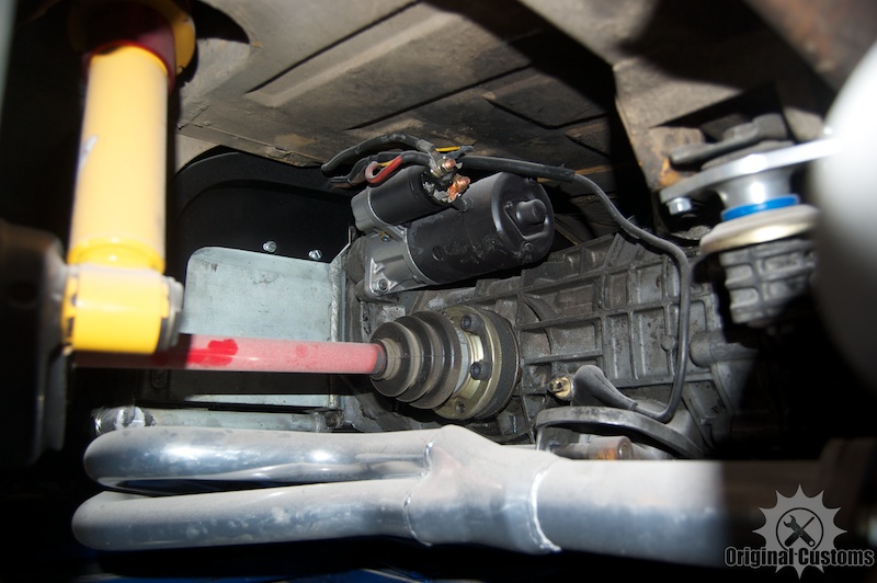

(IMG:style_emoticons/default/WTF.gif) I complete the rebuild on the rear suspension and now the starter does not work. It does not make a sound...dead. I even installed the replacement starter I had laying around (high torque unit from pelican), and it does not work. What did I screw up this time? (IMG:style_emoticons/default/hissyfit.gif)

Did you forget to reattach the ground strap on the transmission?

nope that is still attached. I did not remove the ground strap I only disconnected the positive side of the battery. What did I fry now? I am starting to think this happened to me once before. (IMG:style_emoticons/default/headbang.gif)

Have someone else turn the key and measure the voltage at the solenoid big yellow wire. Be careful; brake on, in neutral etc. If you are getting less than 9 volts, the solenoid will not work. Many connections between the battery positive and the solenoid. Didn't you put in one of my fuse kits? Check for a blown fuse.

If you are by yourself, remove the yellow lead at the solenoid, and temporary add a lead from it to the drivers seat. .reconnect the battery, put your meter between that lead end and any frame ground and turn the ign switch to 'start' position. . If no battery, start tracing the yellow lead circuit back for an open. . maybe something easy like the seat belt interface under the seat. .

Did you reconnect the yellow wire to the TOP of the starter? There is often a connection at the bottom of the solenoid and that's not where it goes. I see it all the time.

If you short the big black wire (from the battery) to the "Yellow wire goes here" terminal, the starter should try to crank the engine.
