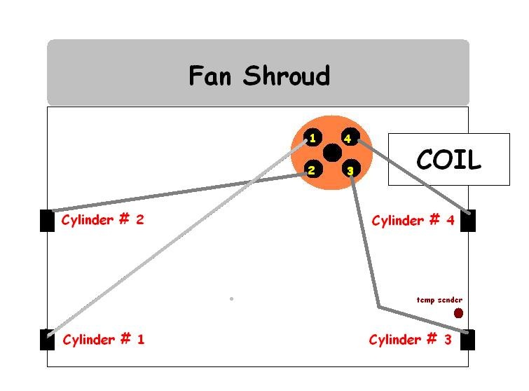

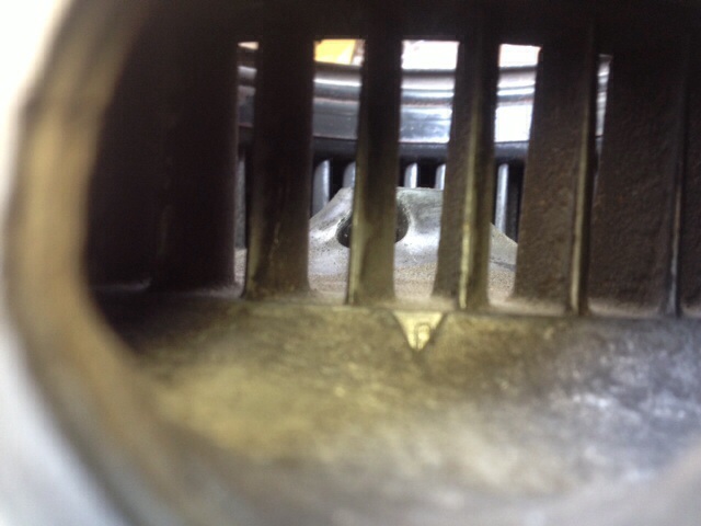

drbill   Thanks Mike. The HT leads are attached in the righ...   May 20 2014, 05:27 AM
Mblizzard   I am not sure that the 12 degrees of the shaft lin...   May 20 2014, 05:53 AM

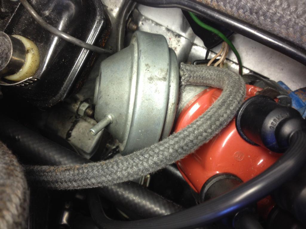

drbill   Starting problem solved! I left it alone for a...   May 21 2014, 10:03 PM
The Cabinetmaker   Decel valve has absolutely nothing to do with idle...   May 22 2014, 05:17 AM
