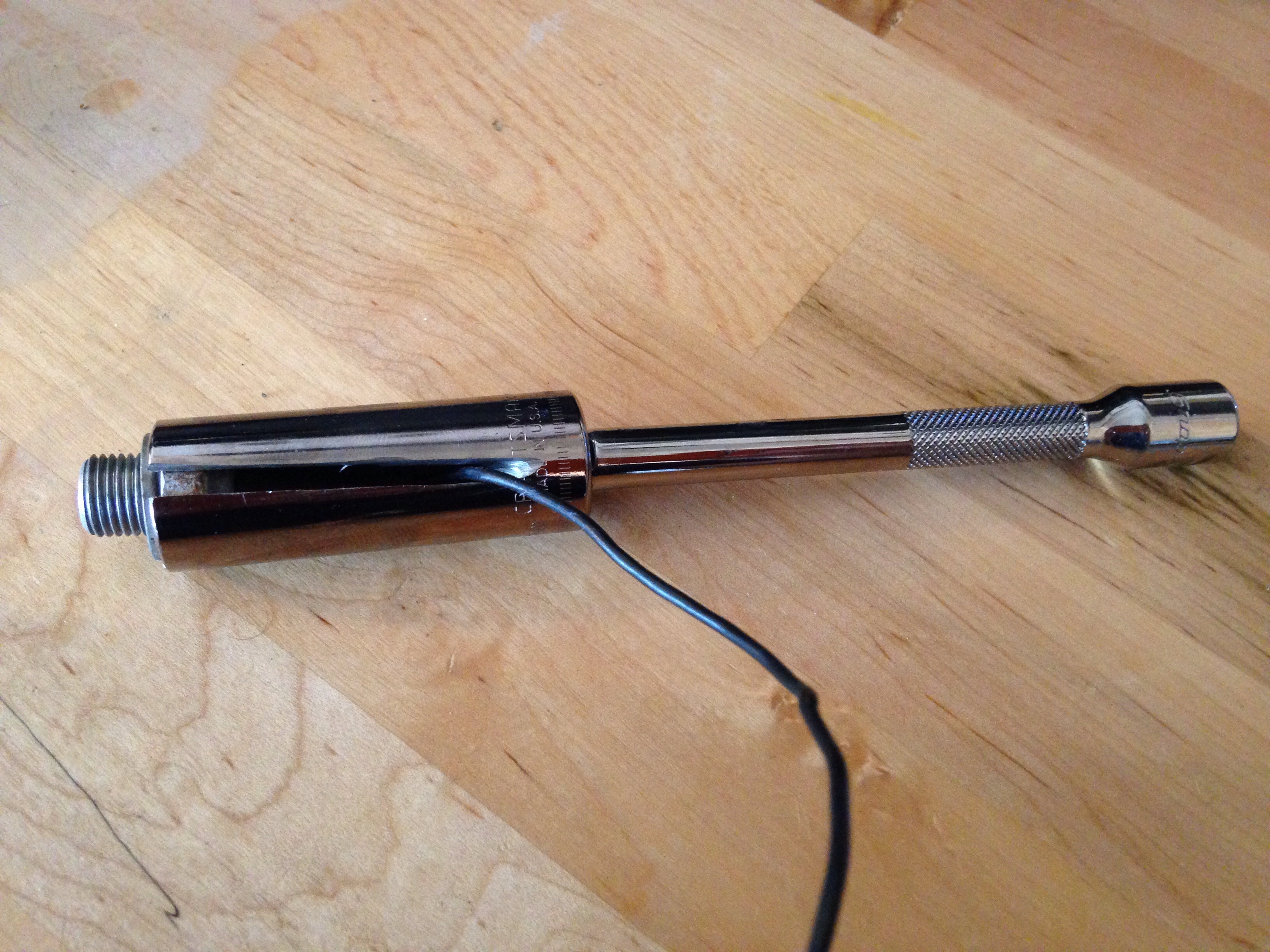

Still haven't figured it out. Had to stop working though so I could swap out the rear hubs on my Honda Ody. Why does it seem like all cars need attention at the same time? Oh I also swapped out the CHT on my other 914. Checkout the mod to my new "CHT" socket. Can't believe how easy it was to swap it out on the 75 1.8. Anyway back to working on the 2.0 now.

Could have saved the socket from sacrifice by stuffing the wire in the socket. That also helps to hold the sensor at the end of the socket instead of down inside of it.

QUOTE(The Cabinetmaker @ Jun 18 2014, 04:42 PM) *
Or just sacrifice an extension. Grind off one corner till it fits with the wire poking out the back.
