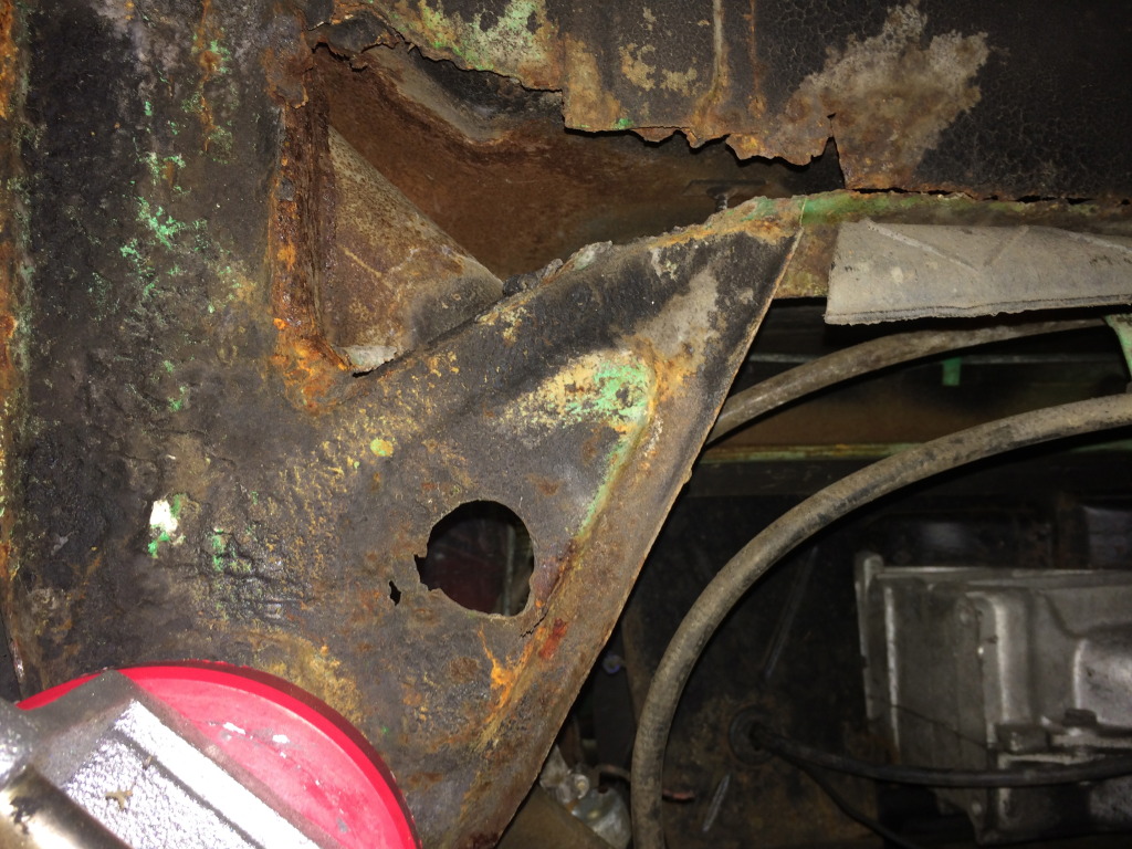

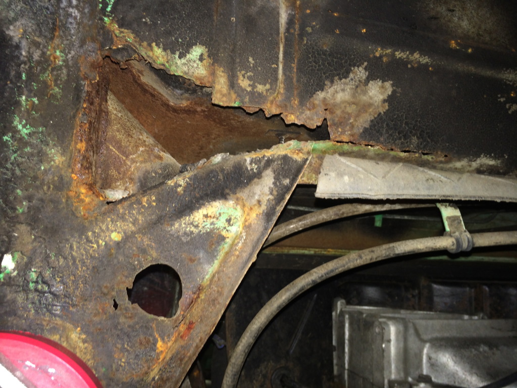

(IMG:http://www.914world.com/bbs2/uploads_offsite/i237.photobucket.com-17475-1403419333.1.jpg)
(IMG:http://www.914world.com/bbs2/uploads_offsite/i237.photobucket.com-17475-1403419334.2.jpg)
So is the what the underside of a bad hell hole looks like?

Problems usually start from battery acid.
So start looking from the battery down.
The side panel the battery is welded to
The engine shelf, engine mount and suspension console under the battery
The area where these shelves attach to the rear firewall
Then the acid continues to eat down through the long on the passenger
side behind the jack plate.

Very repairable.

Yes. Pull the engine and see just how deep the rabbit hole goes.

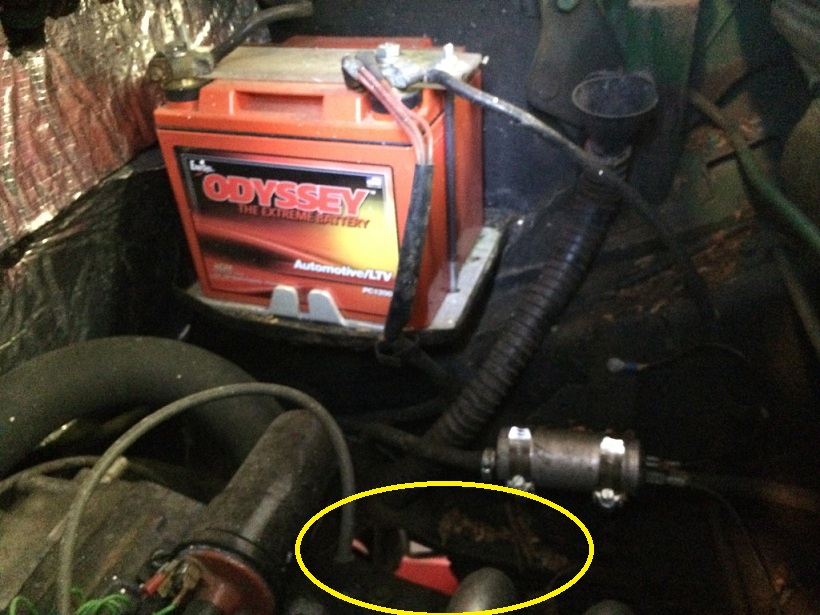

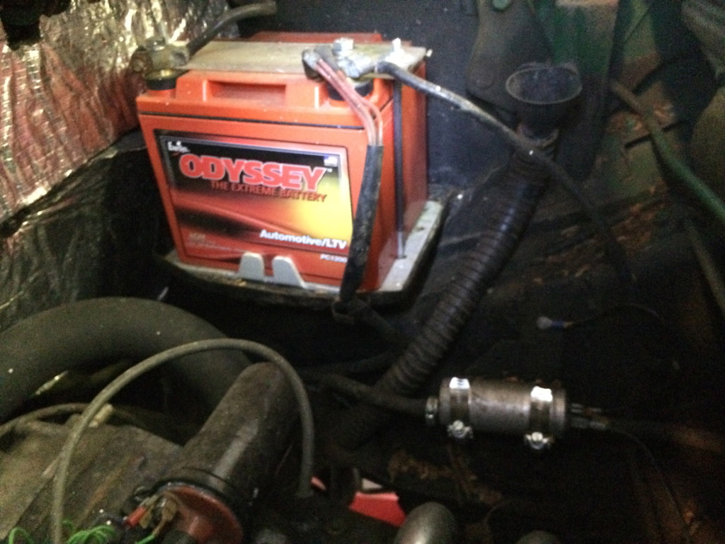

(IMG:http://www.914world.com/bbs2/uploads_offsite/i237.photobucket.com-17475-1403458710.1.jpg)
Something sturdy must be holding the battery up. Not brave/foolish enough to pull the battery to look. Maybe some sort of anti-gravity device that will stop working if you look at it. Not worth the risk…

Looks like your engine is already half way out? Is this gap consistant all the way around?

Might be missing the seals. I didn't look yesterday.
