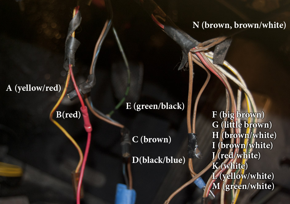

> Identifiying these wires
patssle
post Jul 5 2014, 08:41 PM
Posts: 981
Joined: 28-August 09
From: Houston, TX
Member No.: 10,741
I'm re-wiring my center console for my /6 conversion and there is a big bundle of wires hanging from the dash. My car has been stripped of heater/radio/anything in the dash to the right of the steering wheel so I have no reference to these wires. Any thoughts to some (most) of these wires I can't relate to the wiring diagram?
C & D are for heater control illuminations lights
N is right door switch
I & J are fresh air blower indicator light
A Seatbelt warning light ??
E Oil temp gage ??
